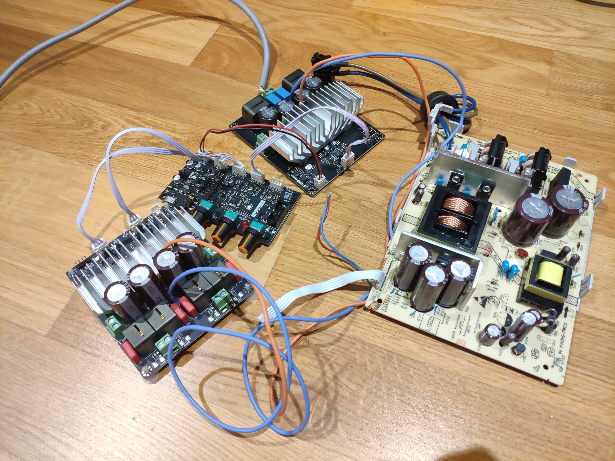

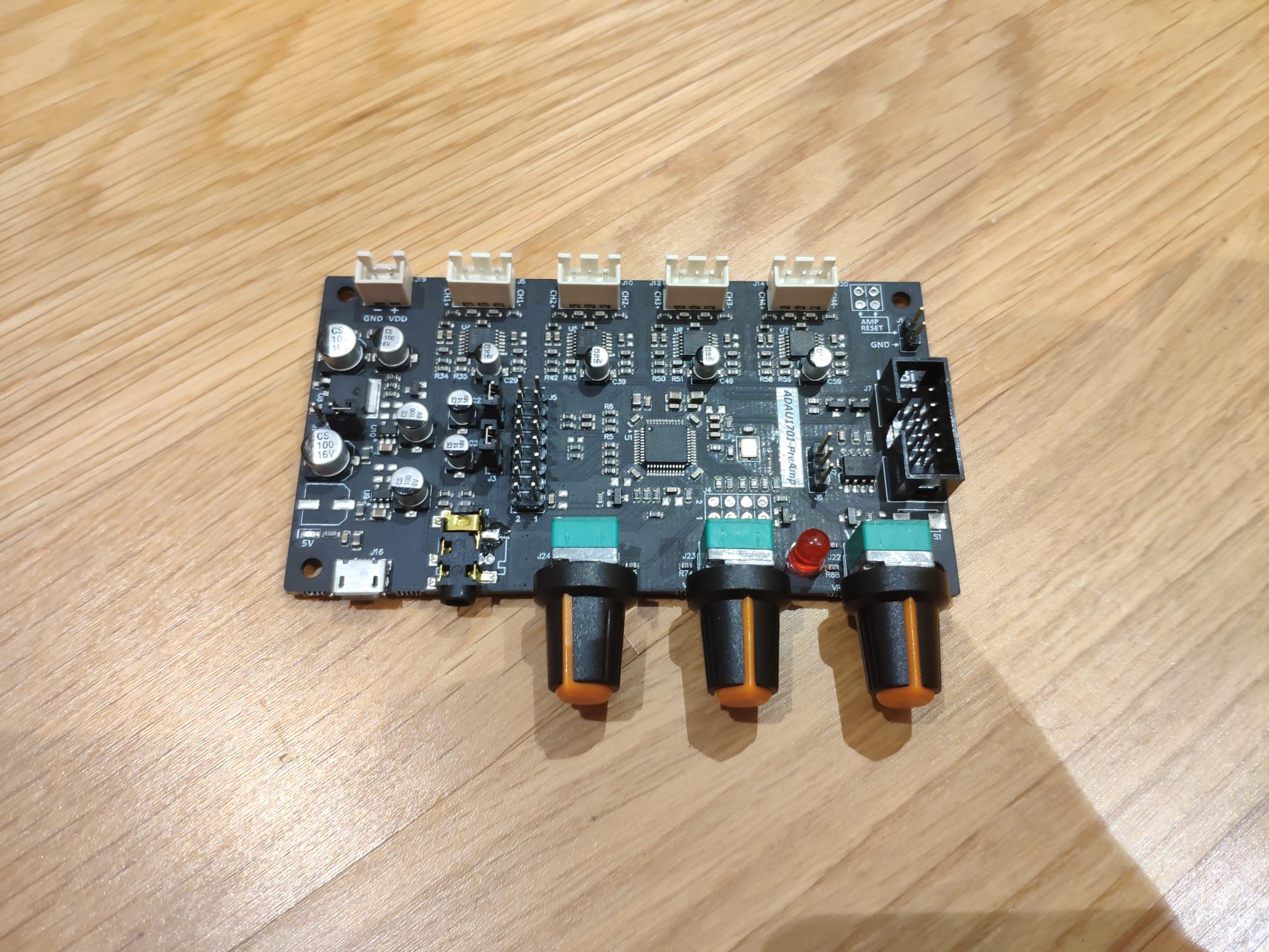

I got my stereo and mono TPA3255.
Unfortunately too the MKP caps wont fit in the inner between the coils... So I have to put them 1 on bottom layer the other on top.
Today I have only stock 2 Way crossover on the DSP.
I will put my own programm für 2.1 and selectable option of 2.0 for working without any subwoofer if I hade no possibility to take the subwoofer.
Is it difficult to program some bass boost or other nice features of the ADAU1701?

Using analog inputs and outputs of ADAU1701 you spoil the sound. IMHO.
This is the same DSP that 3e-Audio use in their integrated amplifier and this uses the analog inputs for the RCA and all four analog outputs to drive the TPA3250 amplifier chip.
What is your view on this amplifier ?
This is my opinion))) Need using digital input and outUsing analog inputs and outputs of ADAU1701 you spoil the sound. IMHO.
USB>I2S>ADAU1701>good DAC, up to you))
