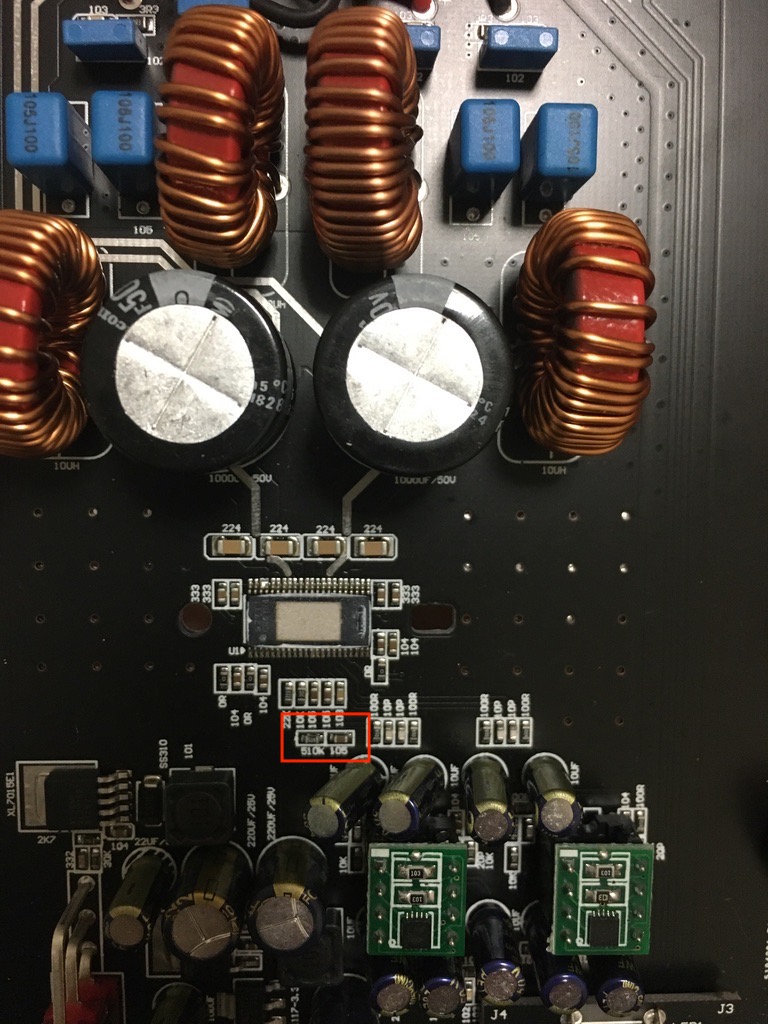

For those using the AIYIMA, I've isolated the pull-down for the RESET pin.
If you are encountering the pop sound when turning on, you should be able to up the 105 capacitor value beside the 510k resistor to further delay the start-up of the power amp.
According to the datasheet, it should be at least 250ms delay before the pin goes high. From what I calculated, the pin is at 1.3V at 250ms which is above 0.8V for a low level.
Ideally, swapping the 105 for 1.8uF would put it at 0.8V at 250ms.
I'm still trying to figure out how to eliminate the turn off pop. My thought is using an NPN transistor to pull RESET to ground, upon flicking the switch. If anyone has an idea, do share it.

@impulse60, the source is the DVDD pin, which on the datasheet is from 3-3.6V (3.3V typical). I would use the absolute max or 4.3V for buying the cap, so anything above that will do.
The graph is here: Graphing Calculator
You can play around with V, R and C. Currently, V=3-3.6V, R=510k and C=1uF
RESET should be <0.8V (y-axis) for at least 250ms (x-axis)

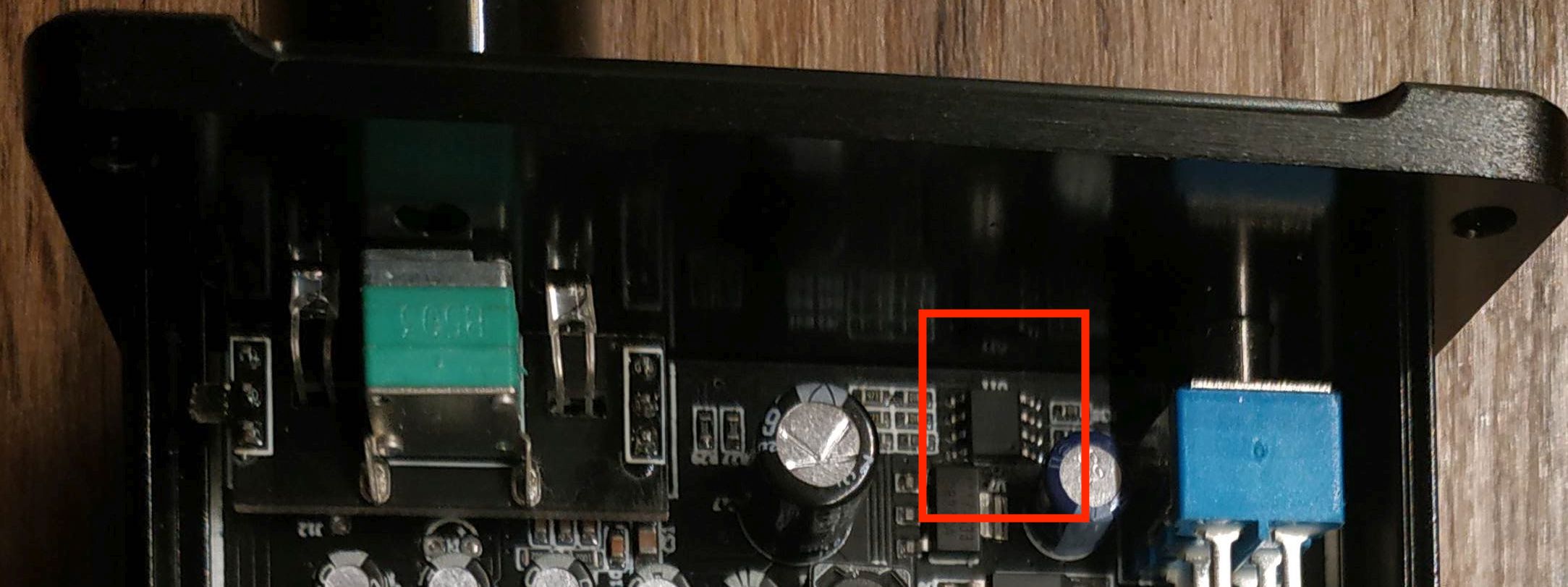

@daniboun do you know what's the part marked in red? I can't see it clearly from the picture.
Any part number on the chip and what is the marking on the board?
If you could provide me with this, I can get a better idea of what they are doing.

Hi lwj5.
The part you highlight doesn't appear to have any marking on any of the amps I have seen but is almost certainly the Anti Pop circuitry and only present on the TPA3251 version (Aiyima A04) of the board - It is completely absent on the TPA3255 version (Aiyima A07). You will also note that the main switch on the TPA3251 version is double pole and one of the poles appears to connect with this chip !!
Interesting that it doesn't appear to be the same chip used in the Texas documentation ??? A real pity that they excluded this for the sake of a few $$$ in the TPA3255 version.
Anyone that has the TPA3255 version it is far easier just to control the power by turning the Power Supply on and off - No "Pops" whatsoever !!! Playing with surface mount components is just a pain !!

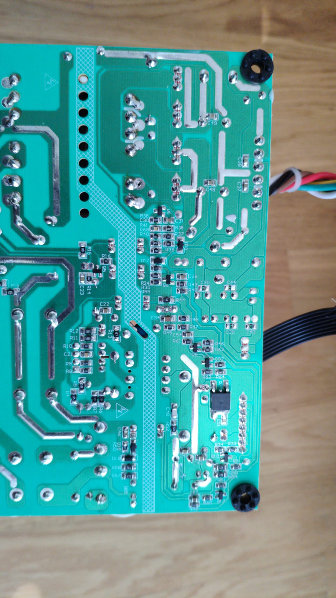

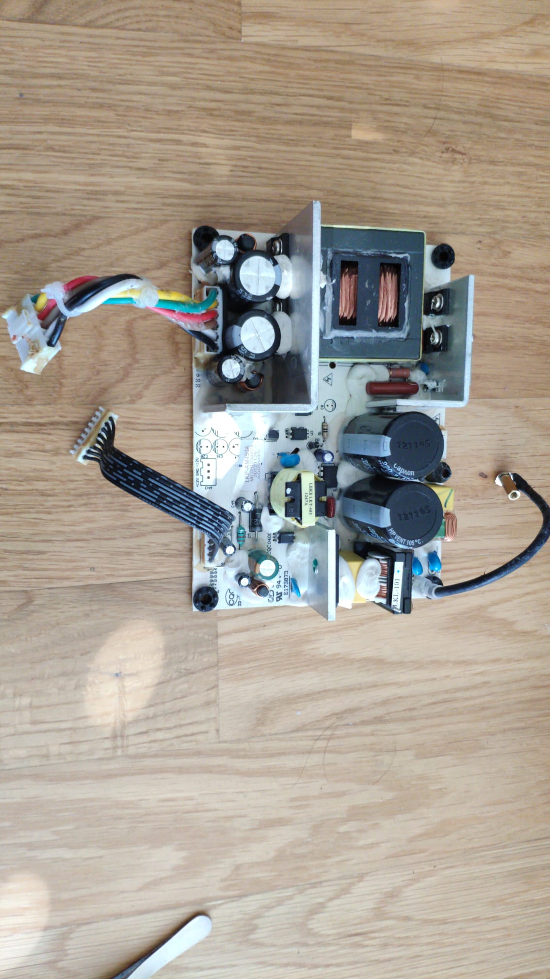

I just found a symmetrical 26V powersupply.
Would it be possible to use positive and negativ without GND to get 52V? Or will this burn the supply?
I must change voltage sense for beeing more to 24V each rail for a total of 48V.
