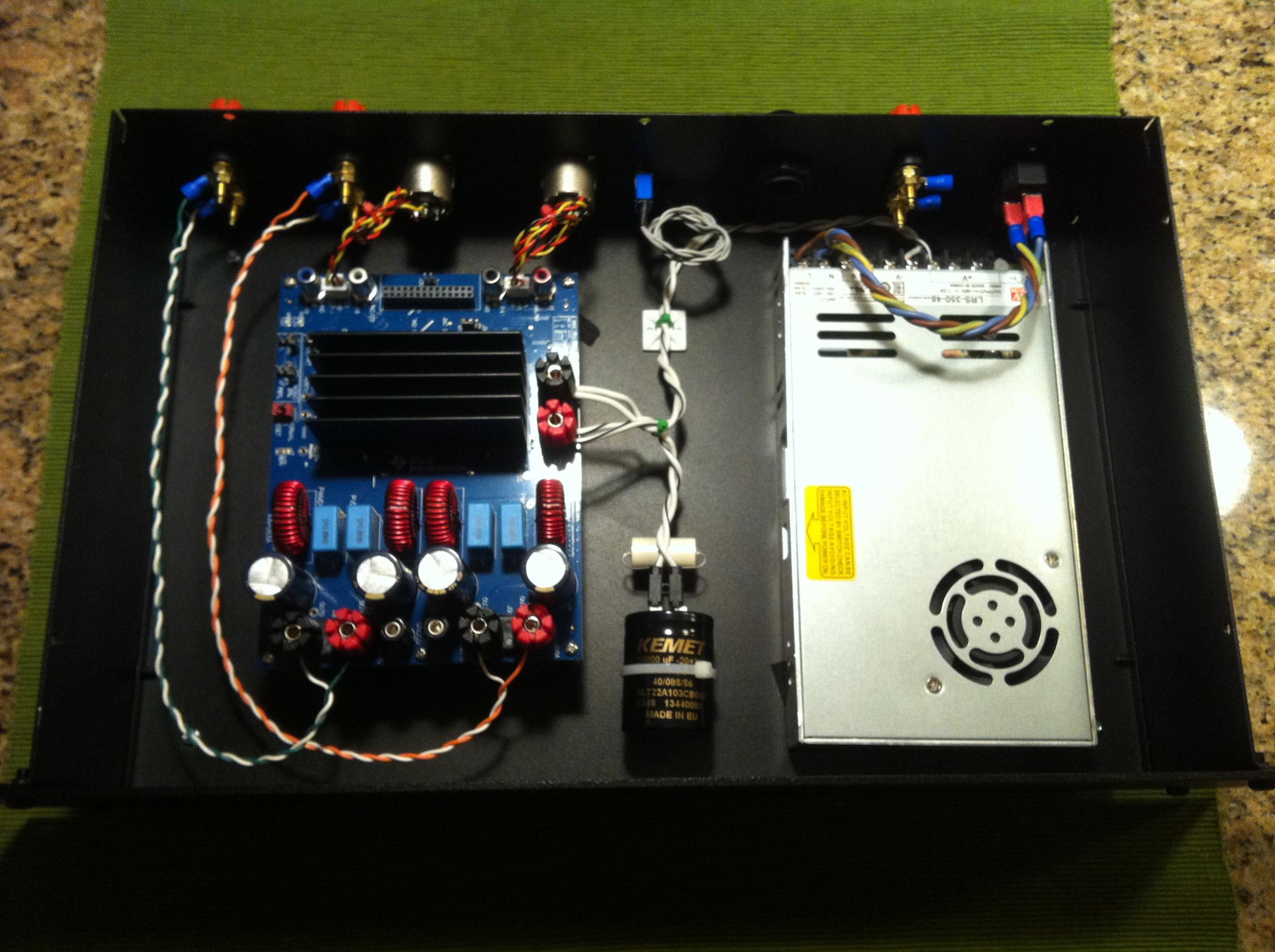

I’d say it’s important to have an enclosure with ventilation, they are harder to find but worthwhile so your amplifier and power supply don’t overheat.
Below is my layout and ventilated enclosure.
BR
Eric
Thanks for the pictures,
Do you have some inflow from the bottom or from the sides ? In my understanding, having holes on the top would not be sufficient.

Hi Chip
What's that capacitor in the DC line? Values and benefits please
Hi Chip
Yes its a 10000uf with small value good quality Solen bypass cap
To my ears it sounds smoother
Could be placebo
Enjoy...
And also what voltage you run on.....have recently upped mine from 40vdc to nearer 50V and it is quite a bit warmer.
I run mine at 48 volts
Enjoy...
Its rather easy to use a convertor with dual rails (from single rail) and it has good advantages in regards to noise (GND). In fact , I am using it with dual rail (15V and 50VPvdd) and the 15V rail is changed to dual rail. I am seeing a good decrease of N especially at lower frequency

Thanks for the prompt prompt, can you share a wiring diagram if you have it handy
A better design is to use dual rails supply removing the GND connection and associated noise.
This is not always correct. Unipolar improves PSRR
Positive to + and negative to - for bipolar cap
and one side to + and other to - for nonpolar bypass cap
enjoy...
Why increase the PSRR ? opamps have rather good PSRR and I use regulators as well (before opamps)

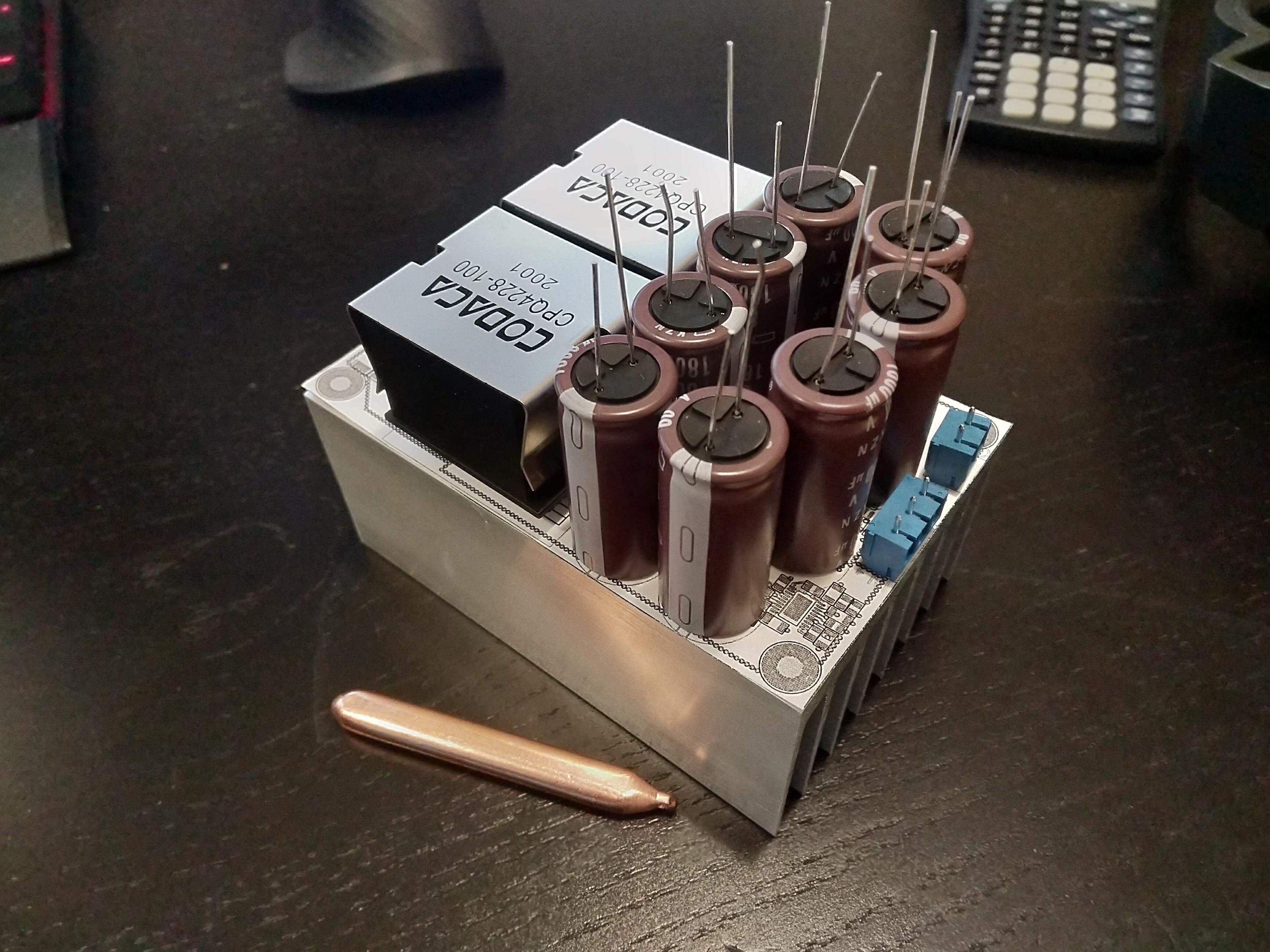

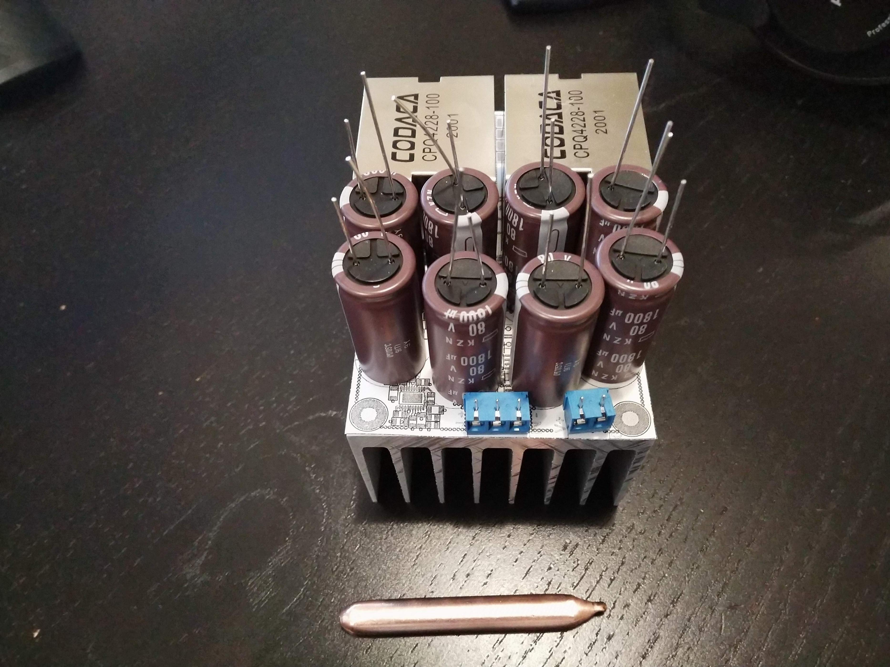

The last few pages of this thread have been a funny summary of my overall feelings with the TPA3255. I've been using a TI EVM for the past 2 years to drive my subs, and have finally grown tired of:
1. Heatsink on the wrong side of the board
2. Heatsink too small for continuous duty
3. No PFFB
4. Poor PBTL implementation
5. Crummy AFE
6. limited inductor choice
7. Zero EMI/EMC considerations
8. Irrational insistence on 2L PCB for an amp that really needs 4L
I figured I'd fix the above issues by doing up my own board and going full commit on the PBTL arrangement with proper PFFB and a good AFE. A bottom mount heat pipe implementation for cooling, and provisions for a heatsink large enough for continuous duty at full power output. I'm using the best inductors you can get (Coilcraft AGP4233 / Codaca CPQ4228) and the best caps (parallel NPO SMD). There's room for 8 x 1800uF 80V bypass caps (18mm diameter) with the closest caps sitting only 5.3mm away from the chip pins, and the inductors sitting only 12mm away from the outputs. The latter two items are also courtesy of mounting the TPA IC on the bottom and the caps/inductors on the top instead of trying to make room for a heatsink where you really need the PSU caps and output filter.
It's a 4L PCB so all EMI sensitive traces are buried with proper via shields around the perimeter. The output filter is optimized for low distortion and low EMI. If you mounted on this a heatsink and copper taped the perimeter, you'd pass EMI cert with no enclosure at all.
The AFE uses a pair of OPA1632 op-amps with a complete TI PFFB arrangement. The bi-polar 12V power supplies are generated from a single supply input using Linear Tech's LTC3265 low noise bi-polar supply charge pump. Both the GVDD and VDD supplies for the TPA have dedicated low noise 12V linear regs from a 15V buck supply. You provide between 36-54VDC and the board does the rest.
Attached are some pictures of the preliminary layout and overall arrangement. I will be doing complete measurements on the APx555 and they will be provided here. Thermal measurements will also be provided. PCB's or complete boards will be available in the future once all testing is complete
Owen

Seems to be an ambitious project. Looking forward to see the final result )
I imagine you must have been interested in the recommendations and optimizations of similar projects from 360 Customs and XRK Audio?
