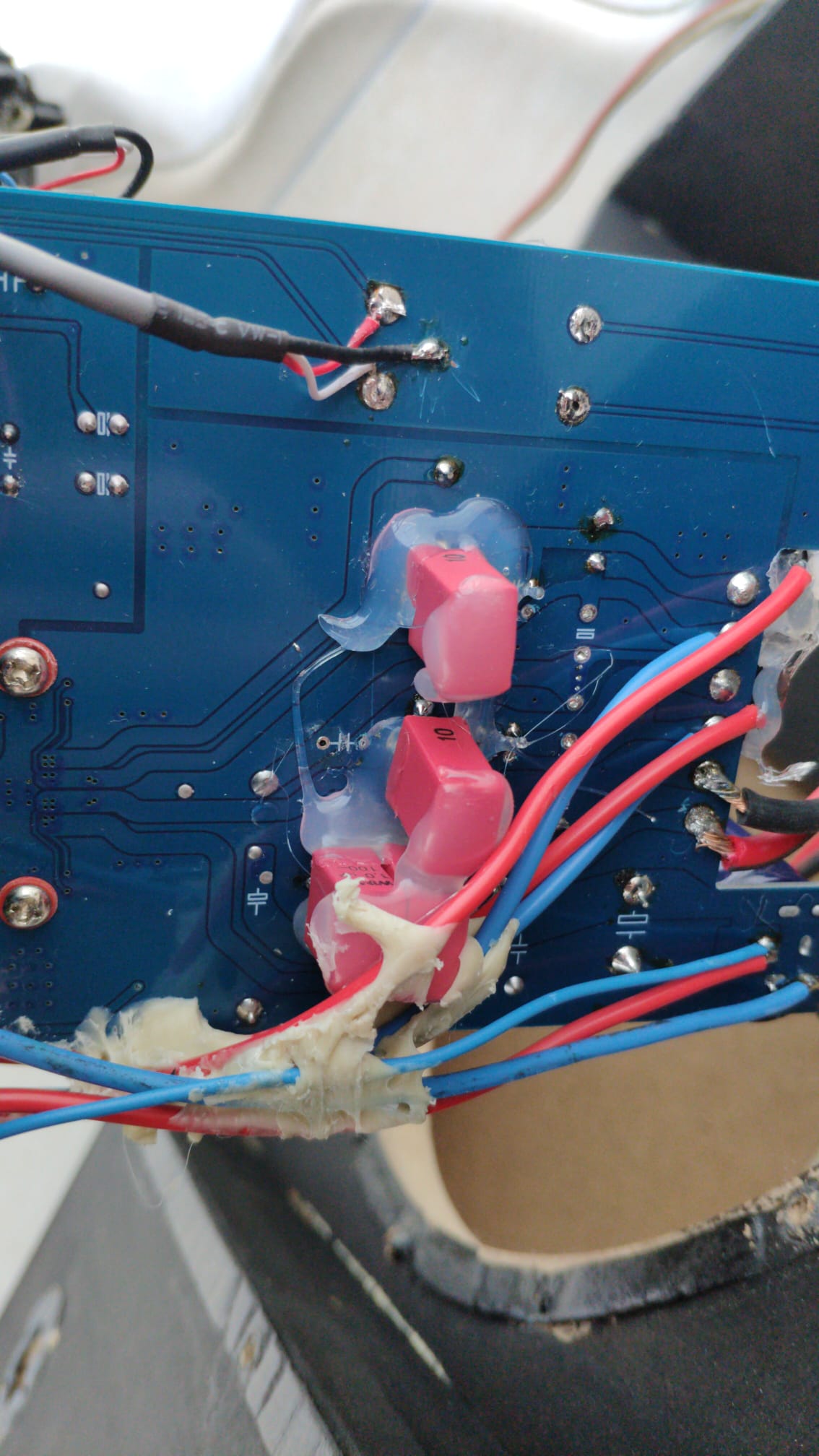

You will be surprised. I managed to fit 2 Vishay MKP 1839 (those round ones) into my Lepai. I'm gonna see if I can get some normal rectangular MKPs to fit in the output side to replace those 105J100.
Coilcraft and Wruth inductors are gonna be a tough one to fit. I'll try to find some way.

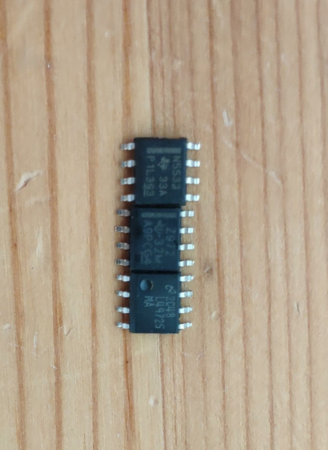

I have NE5532, TL972 and LME49725
Which would be the best for the TPA3255?

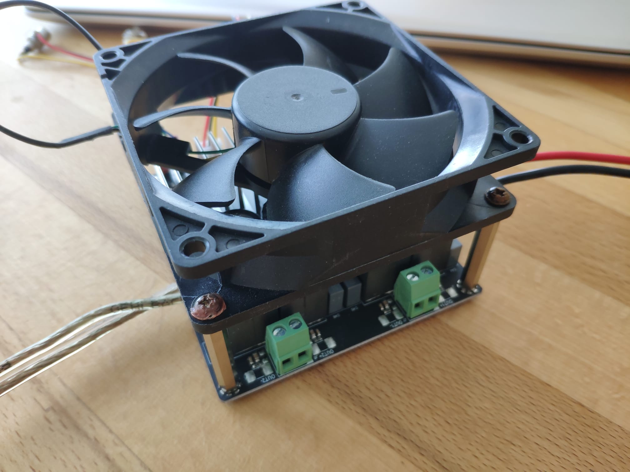

I was thinking about getting a tunnel with 2 boards and a FAN but fortunately you can mount mount a 92mm FAN directly... So i will look for having on each board an 92mm FAN.
Controller by tempsensor on the heatsink.
Will look later for using it with FAN at 5V... Will do thermal image but need to look for a supply for the FAN.

The case should have ventilation hole (top and bottom plates) so the hot air can escape upwards and replaced by cooler air (room temperature).
If you want can look for silent fan and mount on the case, powered by the aux 12v. noctua are very good. Personally I don't think you need a fan if the case is properly ventilated.
I agree, a little "imagination" and a good ventilated case so as not to need a fan, I made mine with some ITX case (PC case) :

The box needs an important grilled area on tob and bottom ato get enough airflow.
As DrMordor states, having the chip underside may be more "universal". It looks like it is the way implemented by Hypex with nCore and Purify. The modules are built on a solid metal bottom plate, connected I believe to components that need cooling.

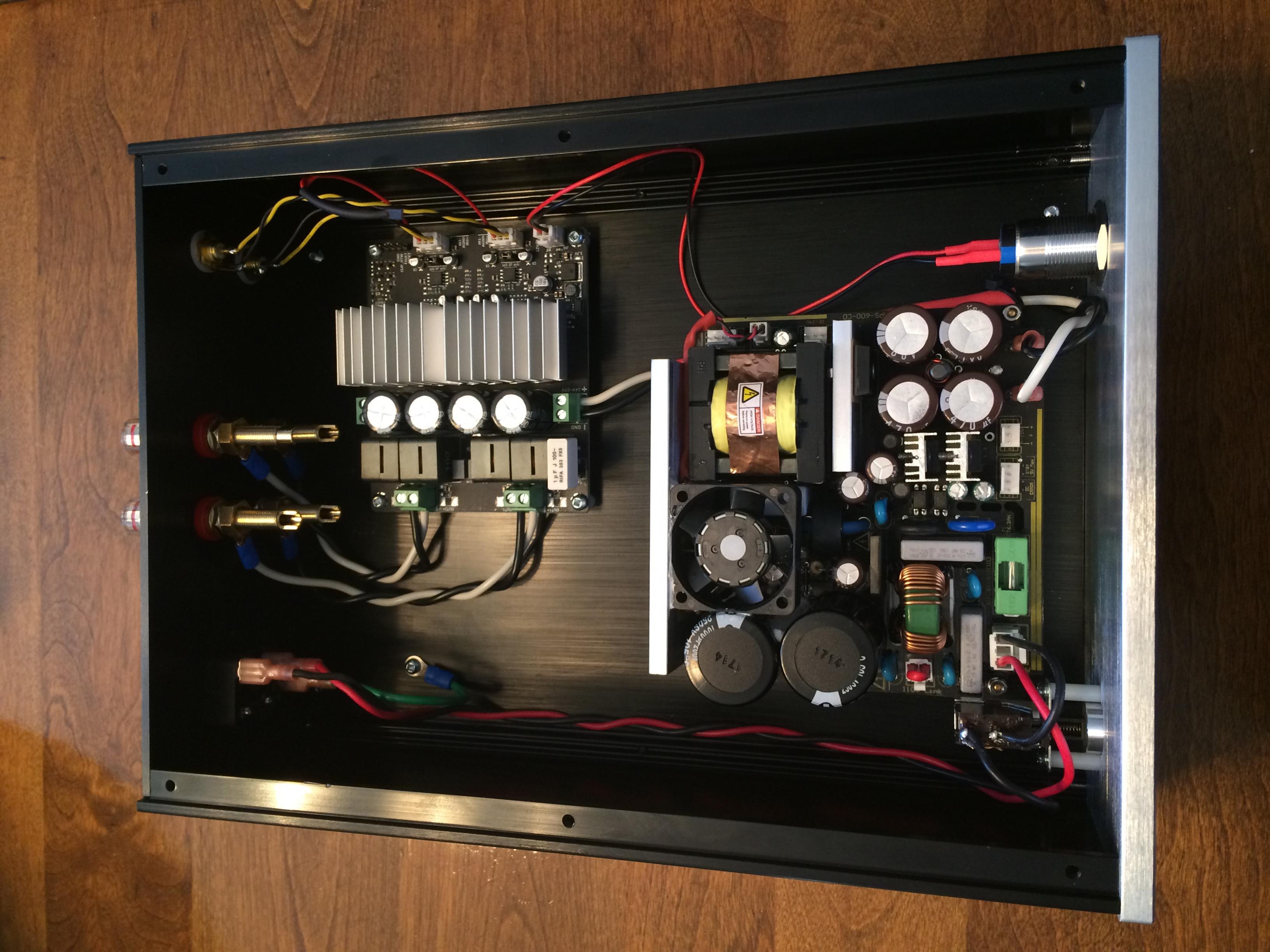

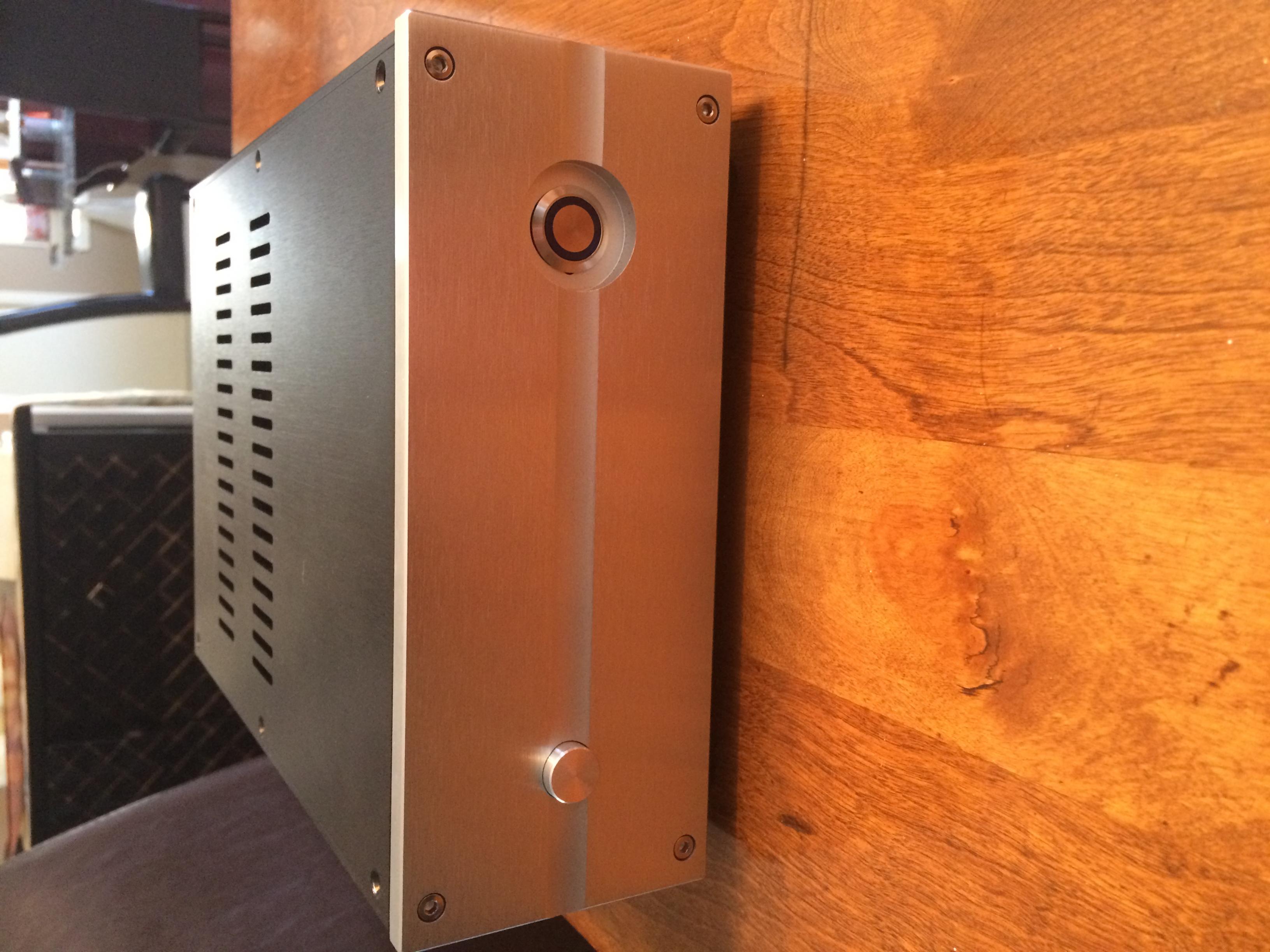

I’d say it’s important to have an enclosure with ventilation, they are harder to find but worthwhile so your amplifier and power supply don’t overheat.
Below is my layout and ventilated enclosure.
BR
Eric
