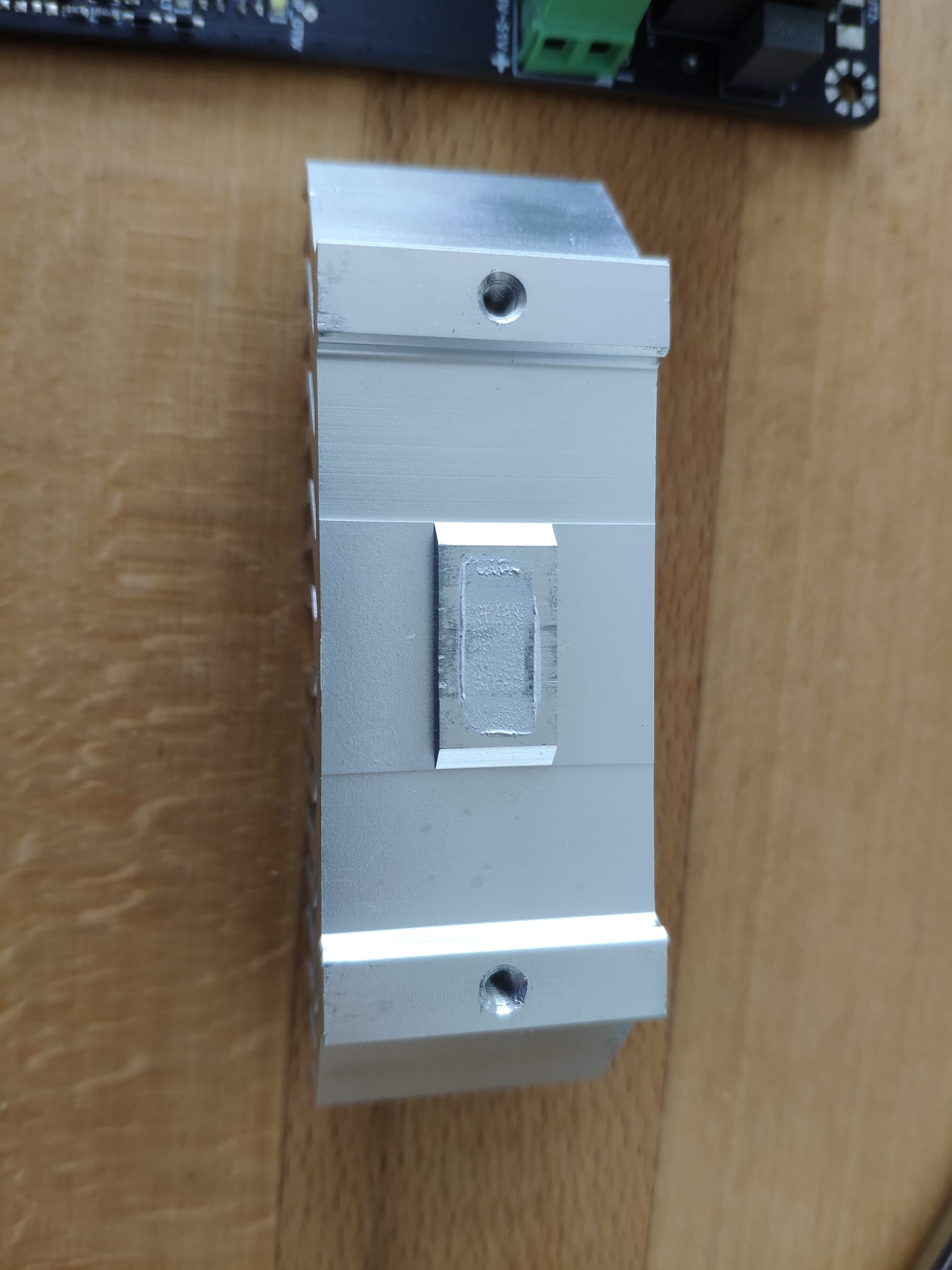

So i checked thermal paste. Looks good.
The board is hard for desoldering... at 380°C it won't put all solder and the caps are still locked^^
For 65$ you get a really good amp. For 250$ you can get better but is the difference as big as the price???
I am still very happy.

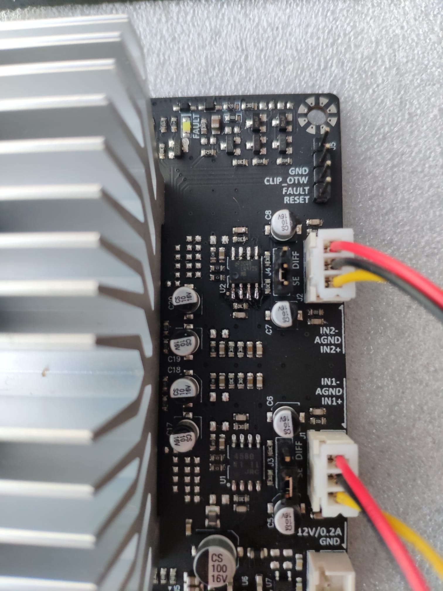

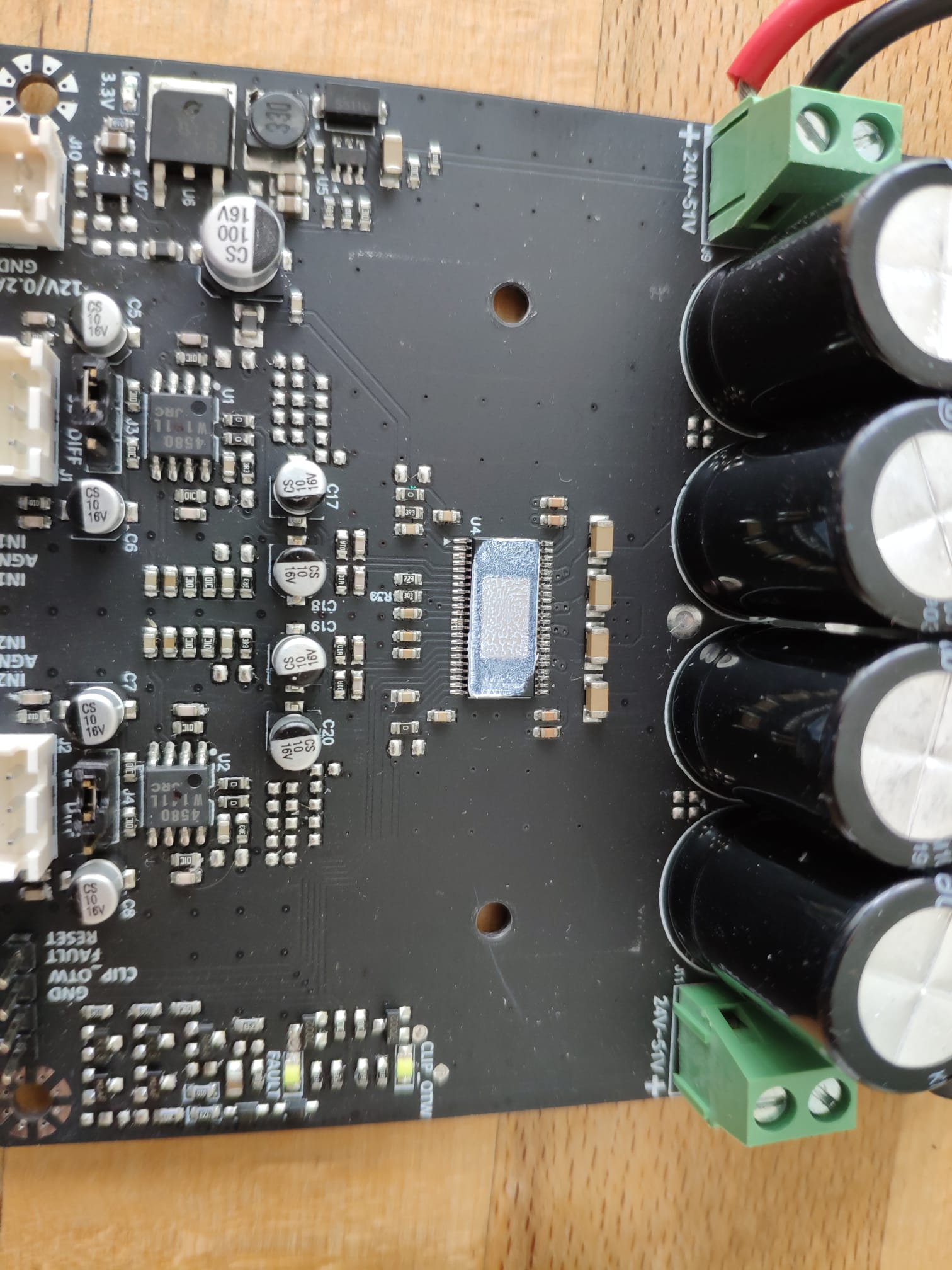

So guys I did it.... I change OPAMP and outputfilter.
I switcht with the balance but for me no difference... Amp drives 2 JBL AC2212 per channel. As pream I use a Behringer Xenyx 302 USB.
Some little changement in highs. Not much but my girlfriend also says modded one are better.
I don't know if I will take my MKP caps from my cheap china amp and solder them from bottom...:D
Some little changement in highs. Not much but my girlfriend also says modded one are better.I don't know if I will take my MKP caps from my cheap china amp and solder them from bottom...:D
OP Amps, I guess LM49720 ?
Tell us more

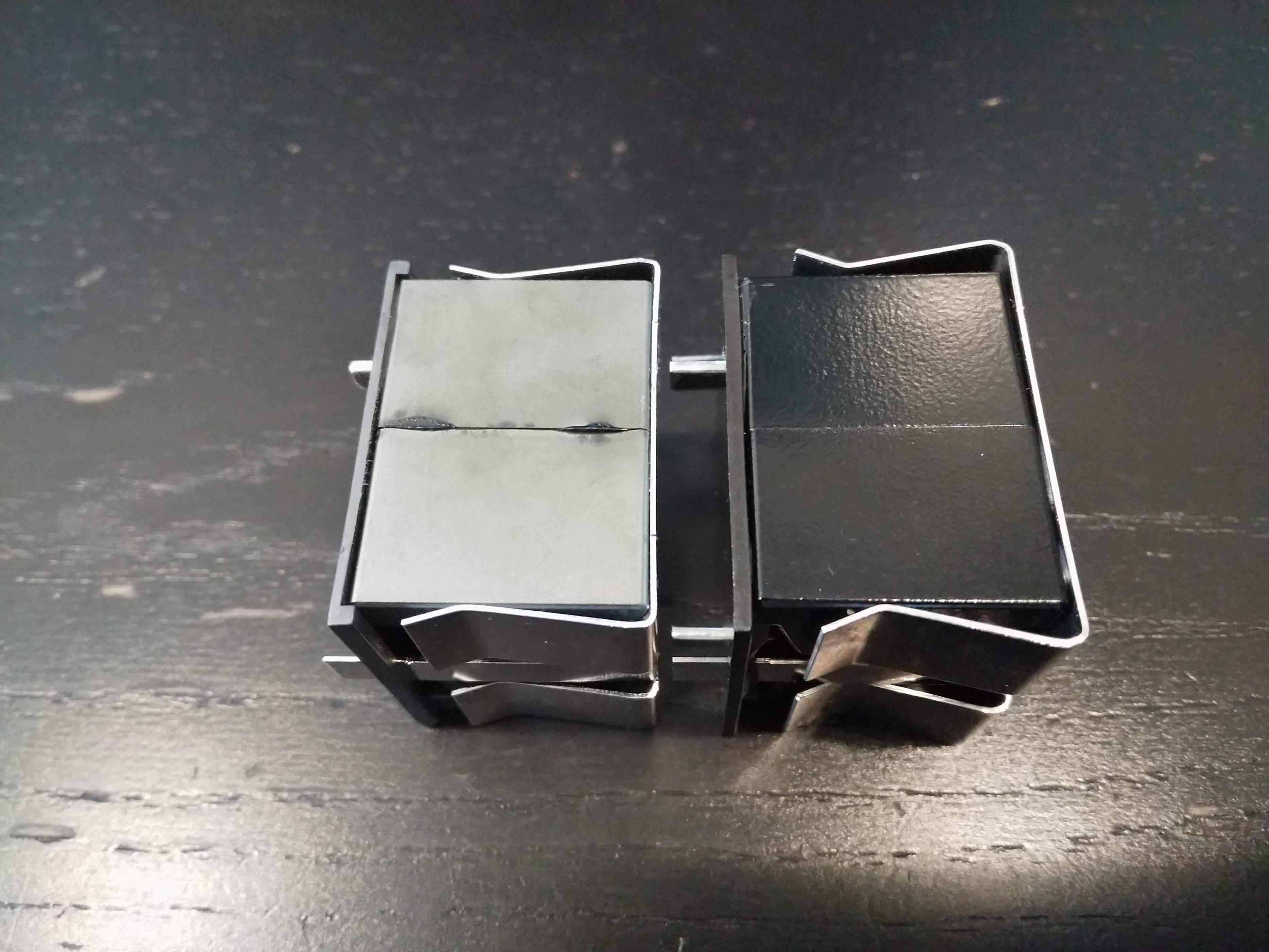

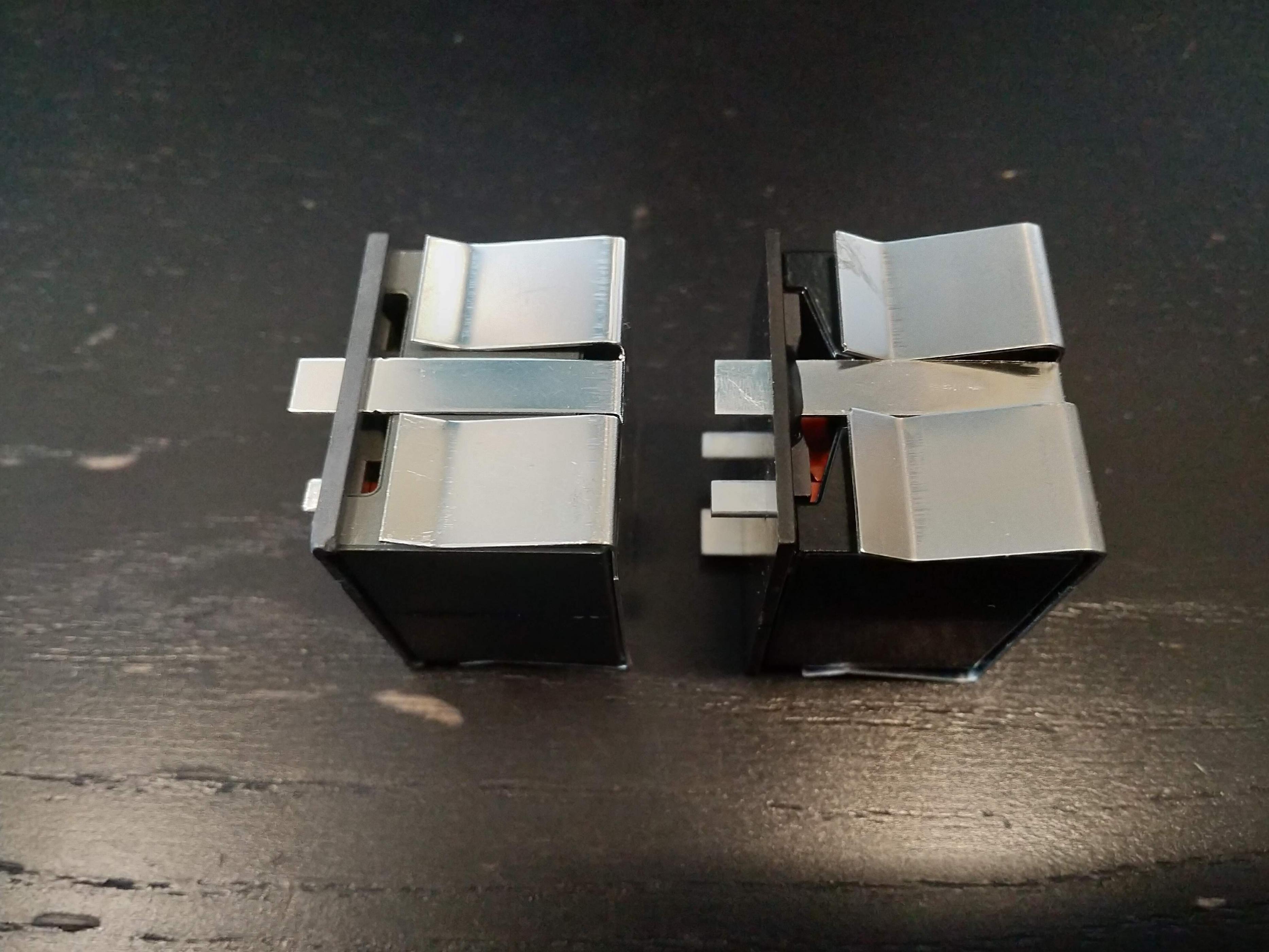

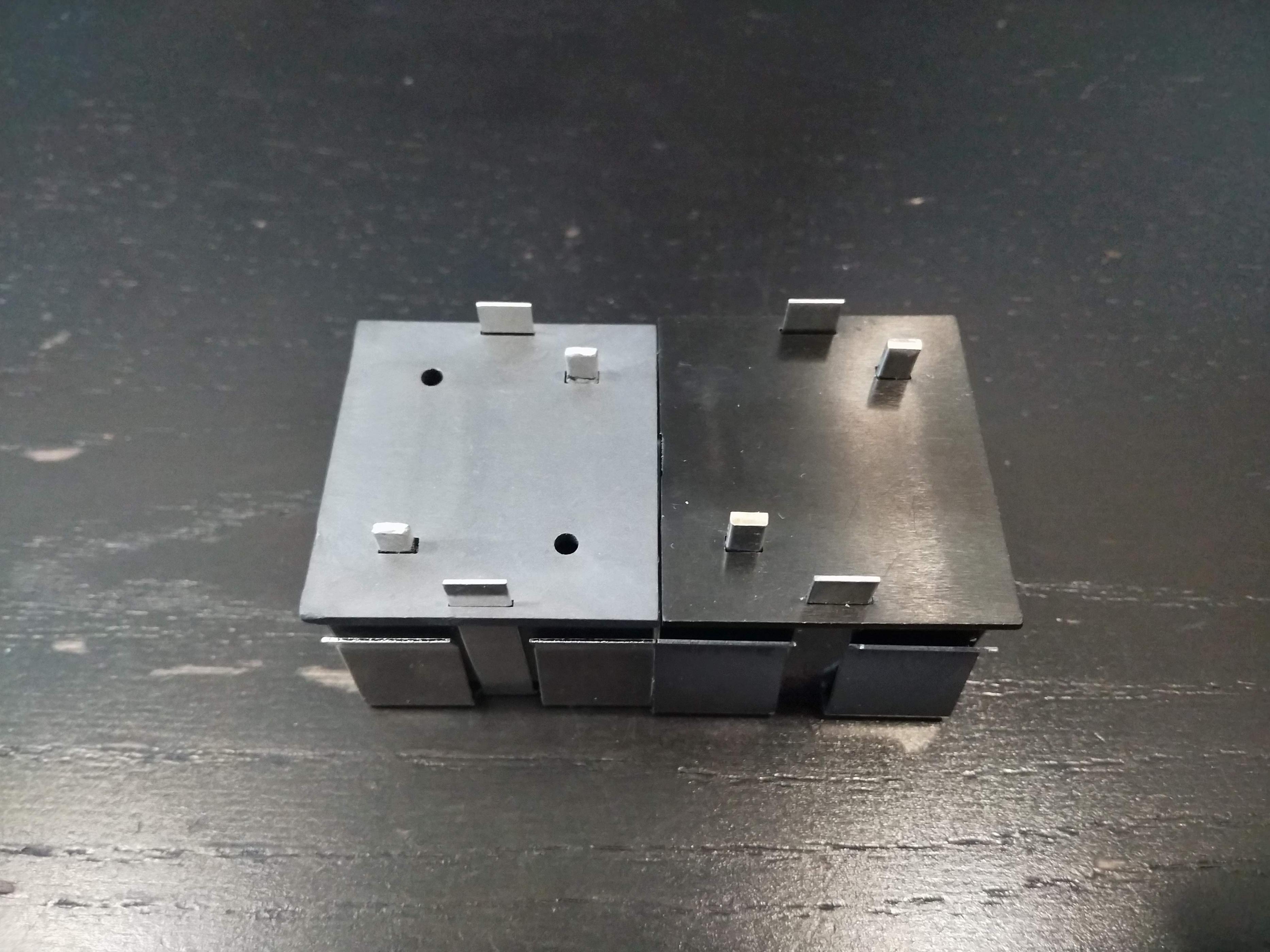

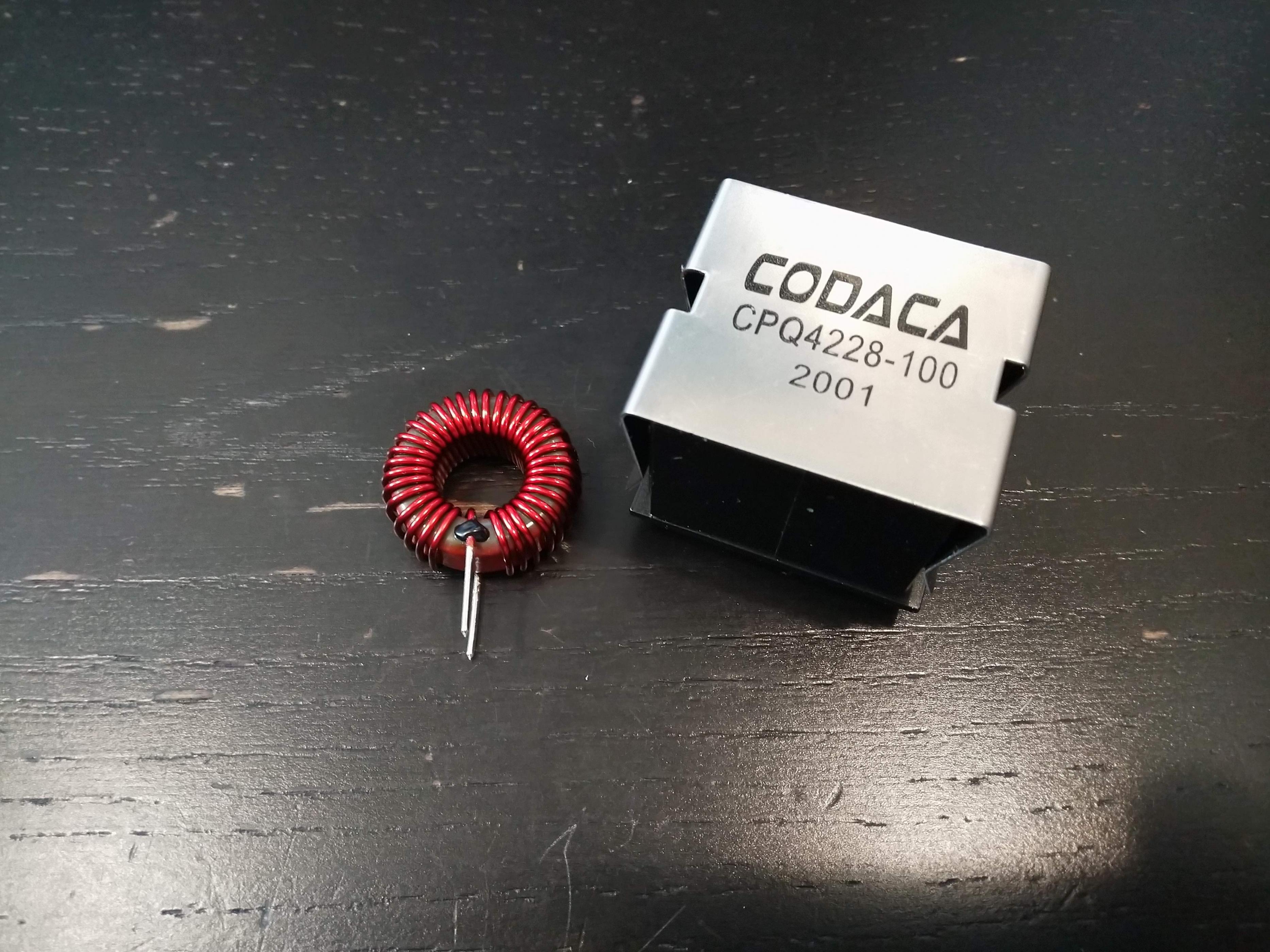

On a more TPA related note, I wanted to point out a curious finding that goes back quite a ways in this thread regarding inductors.
I have a Coilcraft AGP4233-103ME and a CODACA CPQ4228-100 both in-house now, and I had assumed these were the same part just with a re-brand from Coilcraft.
Physically speaking, that could not be further from the truth. These are completely different parts and are almost certainly not made in the same factory. From the datasheets, these should be identical. Both share identical DCR and exactly the same saturation current. All dimensions are identical between both parts on the datasheets as well.
In reality, the Coilcraft part is notably smaller (2mm shorter, and 1mm less tall) but weighs a surprising amount more (141g vs. 128g for the Codaca part). Given the metal clip parts are very close to the same size, this indicates the cores are made from different materials, with the Coilcraft part having a significantly denser core material.
See the attached images for the obvious visual differences as well.
I will test both carefully for distortion to see if there is any performance difference to go along with the obvious physical differences.
As a final note, these things are absolutely massive. I'd say at least 8-10 times the size of the stock output inductors from TI reference board.
Owen
Owen
Hi, thanks and really interesting.
What is your TI TPA32XX board for testing ?
I wonder what influence the inductors will have on TI EVM performances, looking forward to see it.
As reminder, see below THD / inductors influences (ref Board, top end TPA32XX 360 Customs, based on EVM spec)
it seems that flat wire coils are more efficient, especially those with a die cast core.
