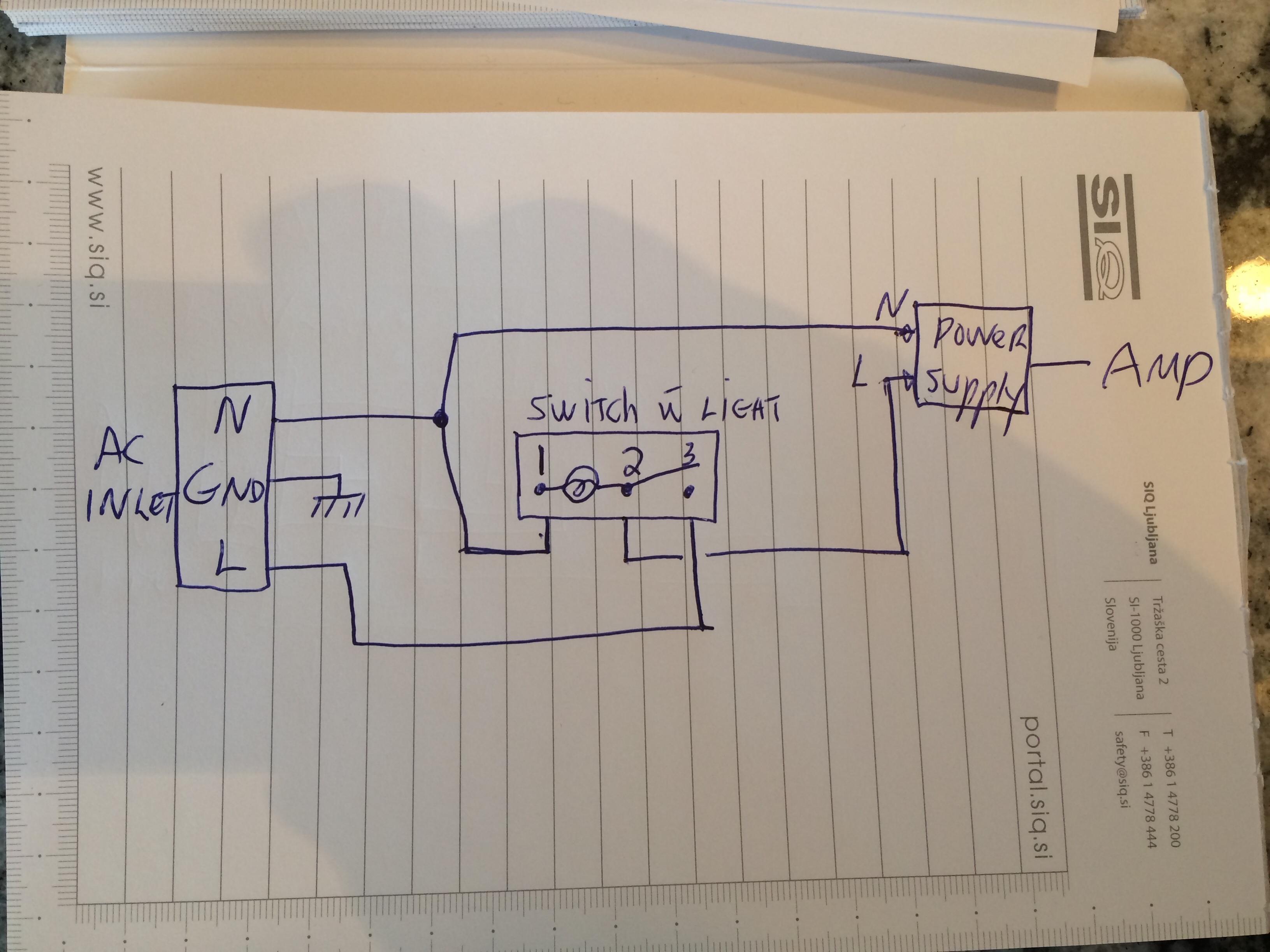

OK I have everything wired up using the antek 200W transformer (i originally thought that it was 30v but it turned out to be 28v still pretty good). i fired it up and it went dark after 3 seconds. i thought i had a short but checked the fuse and it is fine. turns out that the on/off switch died. its a weird switch that has an amber LED embedded in it and i know that i wired it incorrectly but i still dont know what was the mistake:
the switch is rated for 12A 125VAC and it is similar to this:
1 - from the AC inlet the L (for line i guess) goes into the fuse and from fuse it goes into the switch.
I connected the L from the fuse to the 3
I connected the - from the AC inlet to 2
i connected the + that goes into the transformer to 1
originally 1 and 3 were swapped but it didnt work. i dont know im confused maybe it didnt ret it. I was confused with this switch from the beginning

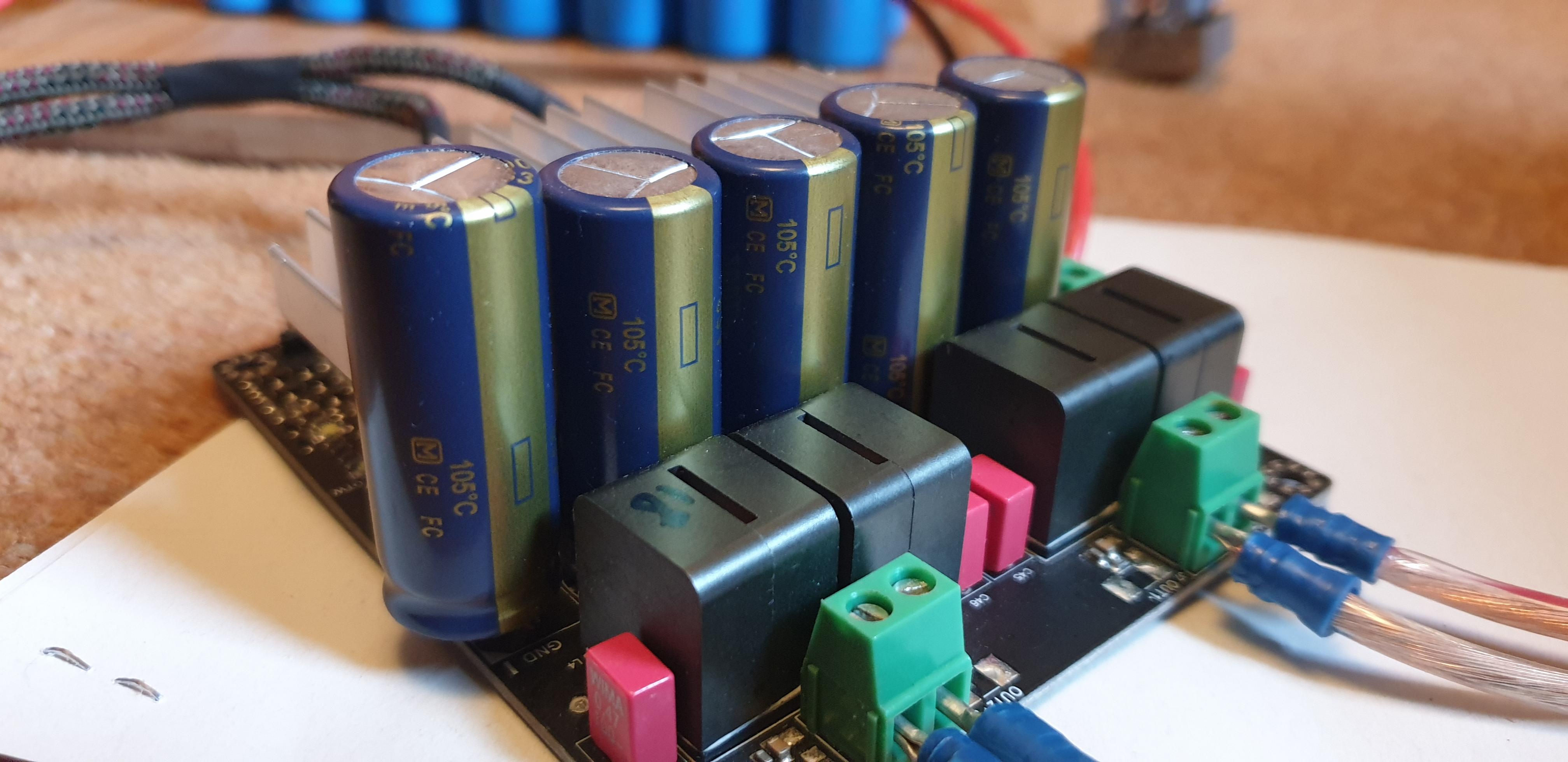

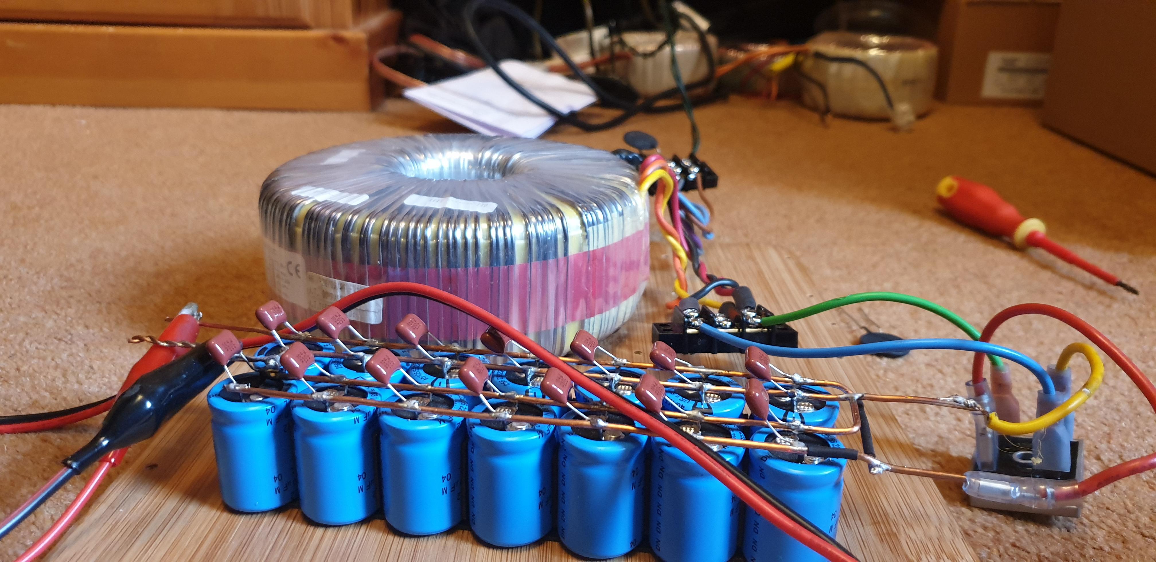

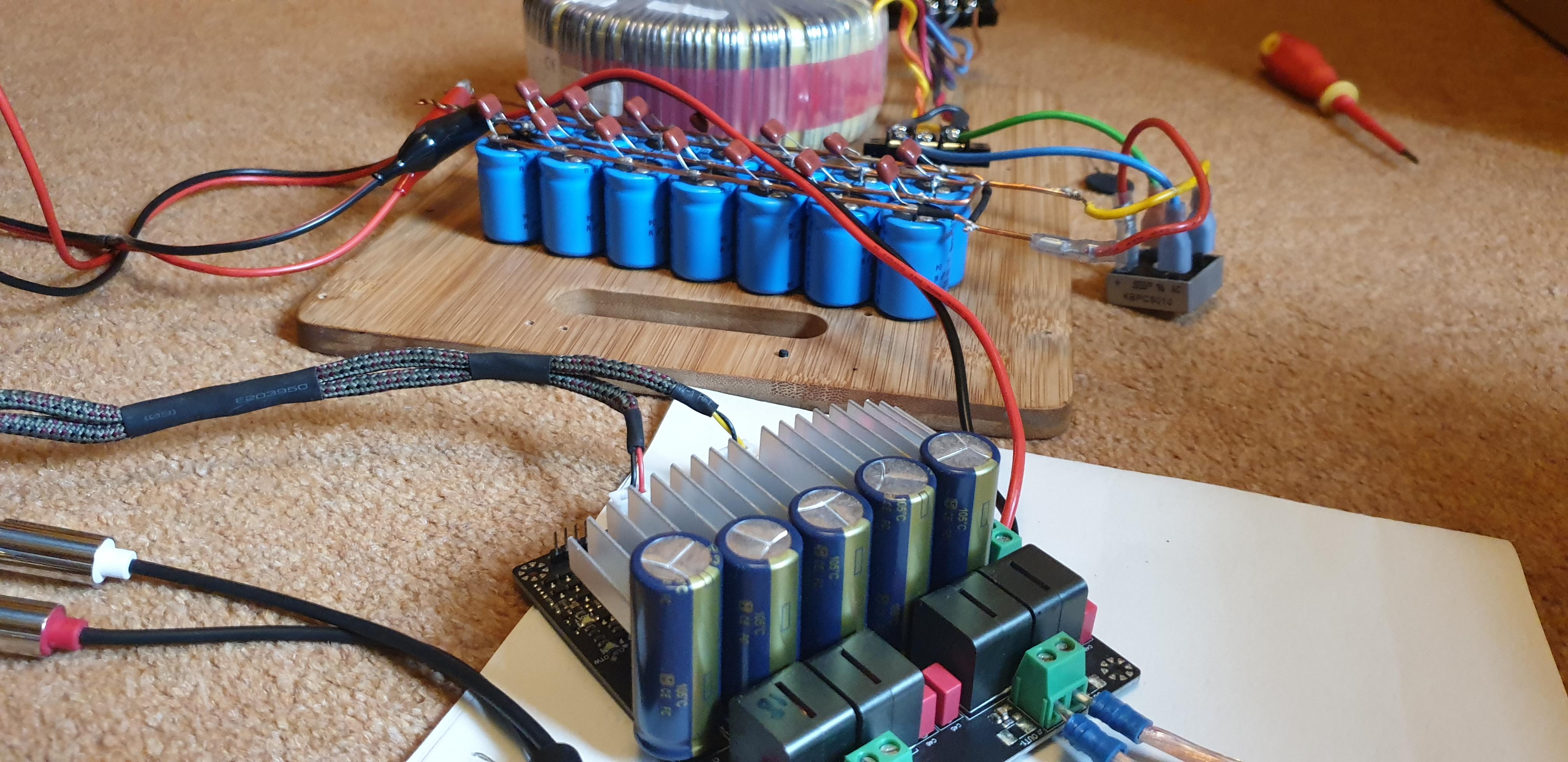

Had my 3e 3255 for well over a year now. It has been out of action whilst I finally implement in a chassis and finalise the PSU.
So I have an overkill unregulated PSU....525VA 35V...giving 49vdc. 2200uF caps with 0.1uf film bypass.
Replaced the onboard filter caps with larger 63v 1200uf Pana FC x5.
Output filter caps replaced with Wima 0.47uf
Just got it testing tonight but it works again and is sounding very good...albeit just Jerry rigged up on the floor.
Monitoring amp temps as 48V does make it quite hot . Output inductors and the chip heatsink are very warm....can hold fingers on indefinitely but it gets a bit uncomfortable
