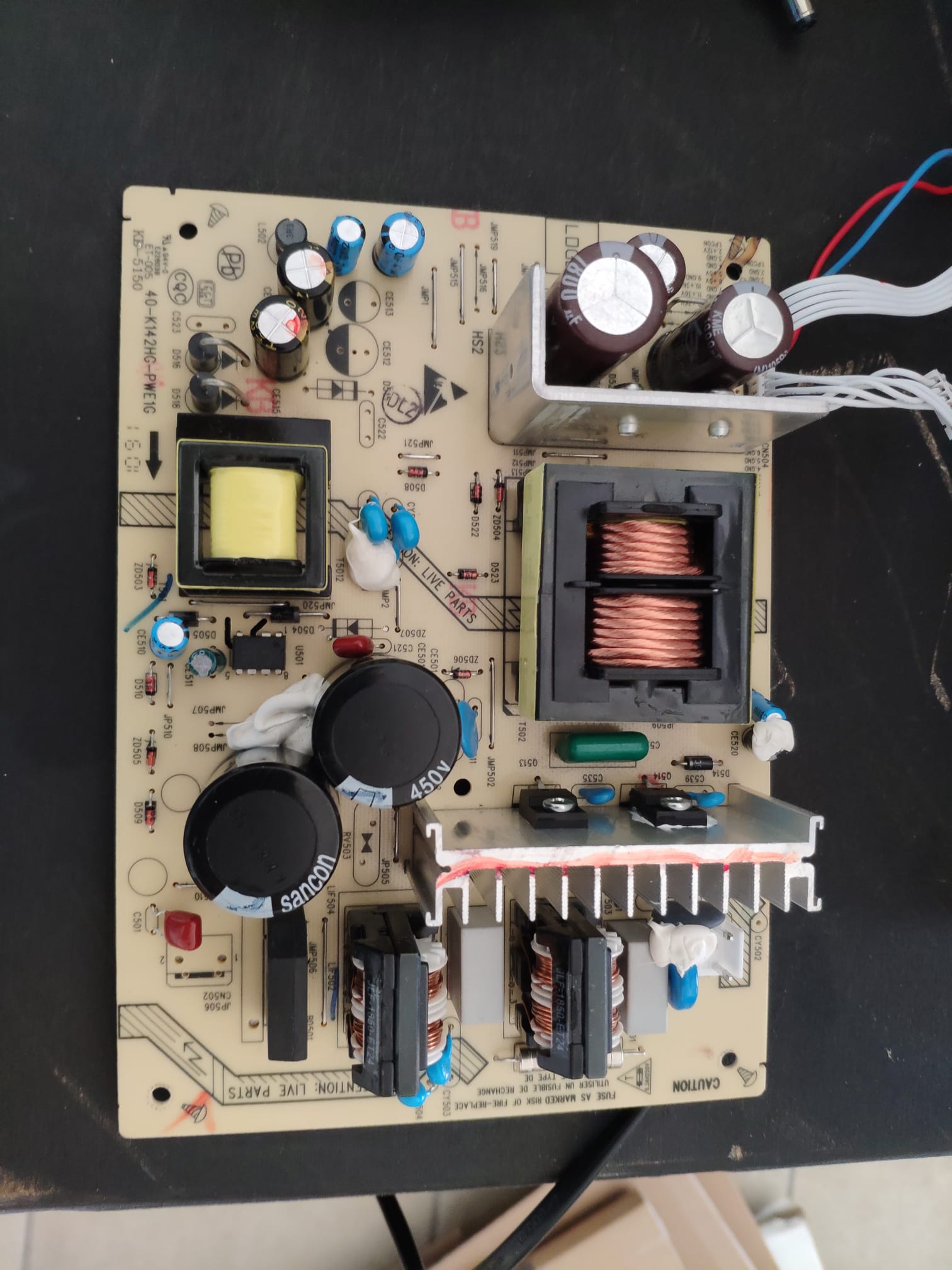

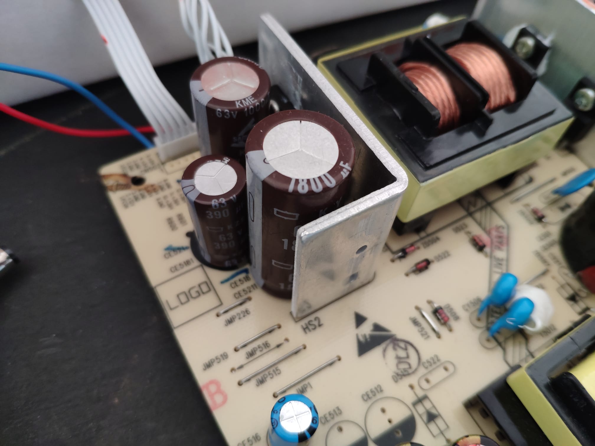

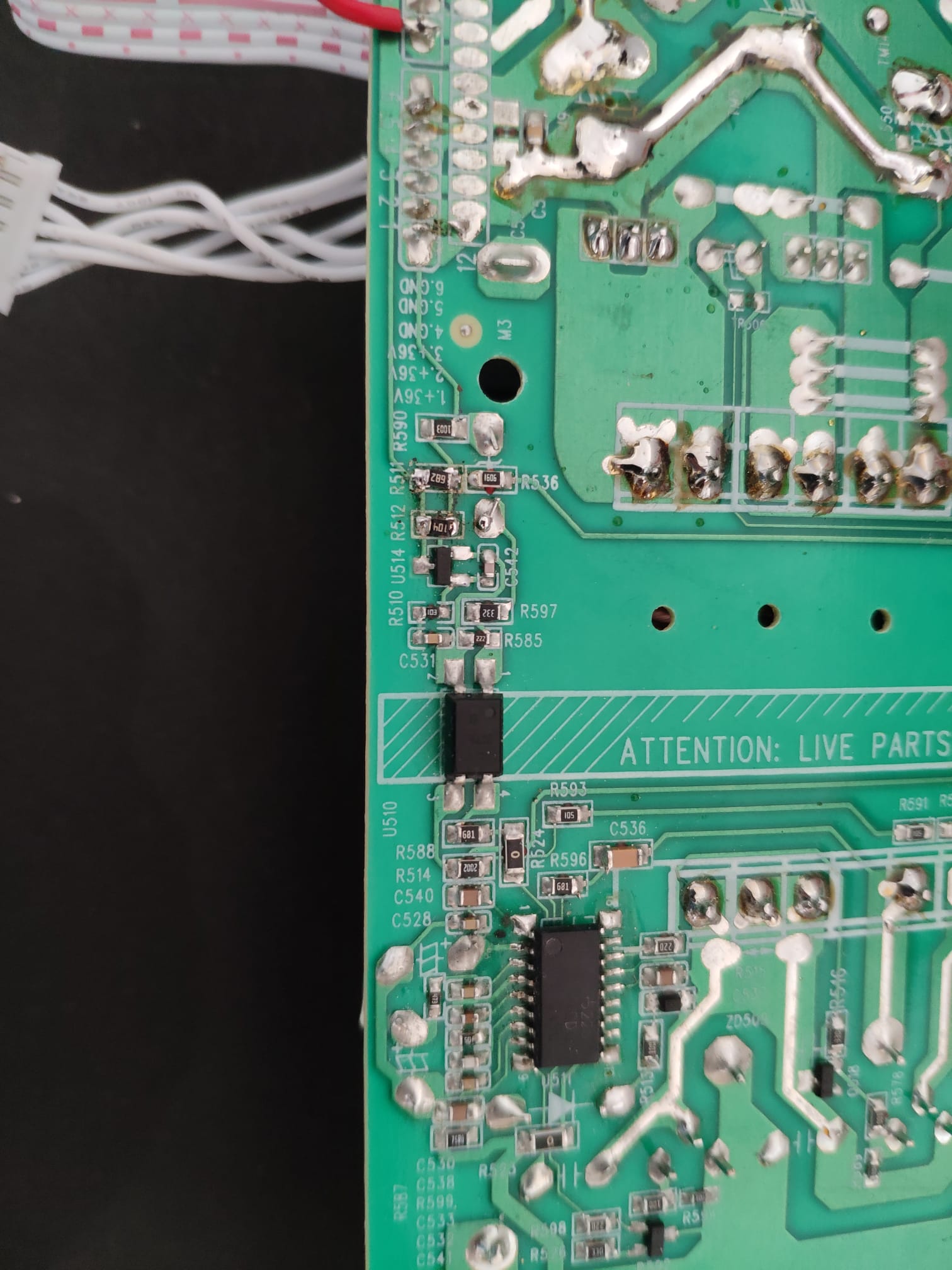

I am happy. I found an easy way to mod one of my recycling power supply.
Original voltage output was 36V. I change resistor from TL431 feedback to 41.8V.
So it would be almost the same voltage as my fully charged battery pack.
The power supply is LLC and works good also under heavy load.
No thermal heating.
It has 12V auxiliary output.
I just have to wait to get my TPA3255 mono and the DSP :-(

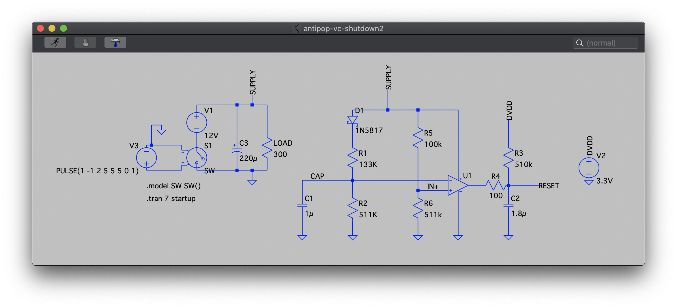

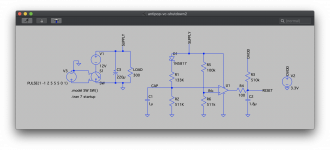

There seems to be some debate as to whether it's OK to power up without the Speakers connected. This was debated in one of the threads some time ago - I think the last time someone suggested using a circuit that isolated the speakers on power up.
The frustrating point here is that if the Anti Pop circuit (1 chip and a few SMD parts) is designed in at the point of manufacture it's probably less than a fraction of a $1 in parts. It should be a mandatory part of any TPA325x design.
That said, where you have a complete amplifier including Power Supply in a box the mains switch is usually before the Power Supply so the Anti-Pop circuit is probably not required.
@hansueli, I was on Vishay MKP1839 for my other amp, but it's an axial cap. I think it's pretty good for the price. I haven't tried the TDK or the Panasonic yet.

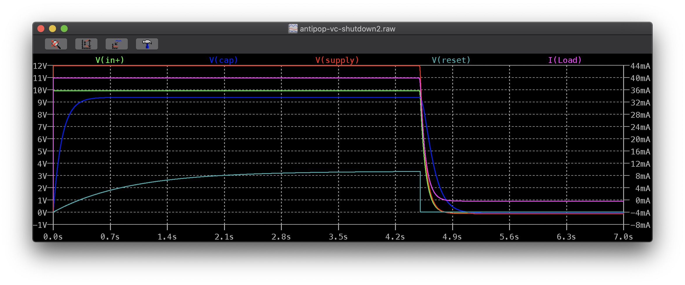

I have simulated the anti-pop circuit and it looks like it works well.
There's a 10ms delay between flicking the switch and going low, I don't think that will be a problem.
Please note that the capacitor and resistor values can be tweaked, you do not need a 10uf.
@impuls60 you are facing a loud shutdown as increasing the capacitance will delay the shutdown time as well, that's why you will need the cut-off.
