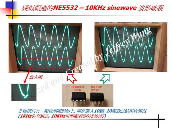

New to this thread and thinking about modding my aiyima. Since there is a high chance that the opamps are fake, what about something simple, affordable and easy such as the OPA2134. I have not seen much discussion as a potential update to the ne5532.
The ne5532 in the Aiyima are more than likely counterfeits.The print of the logo in the package is sharp (good) but the casing is different to the originals I have seen around (not good). It seems that the fake has a notch on the end but original has a dimple. Or they may came from different fabs.
A Chinese site that can barely comprehend even with google at my side, has tested both and claimed that while at 1 kHz there is no difference, at a 10 kHz there is ( see the broken signal). It seems that fake are either relabeled inferior products (remarks) or plain fakes with a simpler and smaller wafer.
一分錢一分貨 - 勿買來路不明的零件 - 疑似假造的NE5532測試結果 (Dual Channel OPA) @ 不務正業的Marketing :: 痞客邦 ::
NE5532, a real one, properly implemented. its a great chip. And they are cheap. But if I have to upgrade them, I want something better yet I don't want to double to cost of the amp with some very expensive replacement opamps. And lets be real, if the compensation and filtering are poorly designed, no upgrade will make a miracle. I am not stating that is poorly made, but if you recall the Objective dac and headphone amps, NWAVGUY,,he demonstrated that basic opamps with good design could yield reference performance.

This is probably why we feel such an improvement when swithing the OP Amps of the Aiyima TPA32XX. As you can read, no need to spend so much for getting a great OP amps (OPA1656, OPA1627 OPA1622 and probably others) make a great update.
As you know, I also tested the Burson Audio V5i whose price is more expensive than that of the amp itself...(see my previous review)
Your analysis does not surprise me, the NE5532 are probably fake, I agree.
