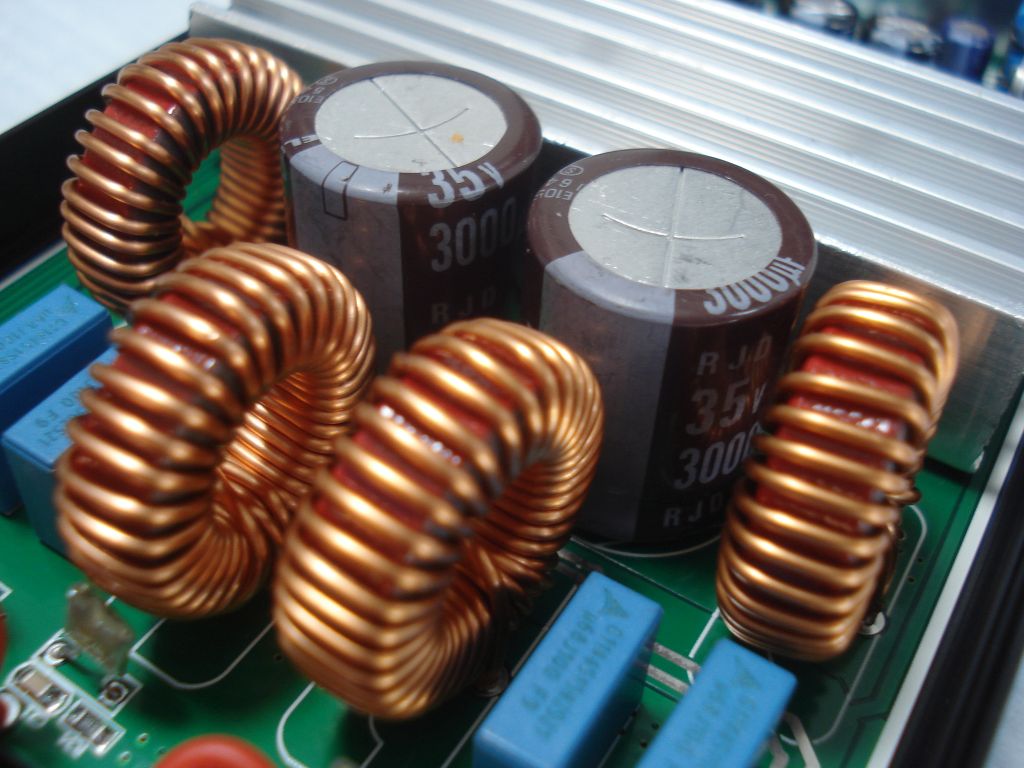

So it has arrived, and guess what, it is different. Guess I will have to refer to this as the Green Board!
I have studied the pictures of the black board too closely, but I can see the inductor in the middle of the pre section is a different value, but it still has Nichison Gold and Elna power caps, so maybe just an iteration.
Any way it sounds fine. I'll let it play for a while and then compare it to my Tisbury passive/Quad 306 that I use in my office.
Oh and a silly question, how do I get the bottom of the case off. It looks like the volume control knob needs to come off, but I've pulled pretty hard on it. Do I just need more brute force?

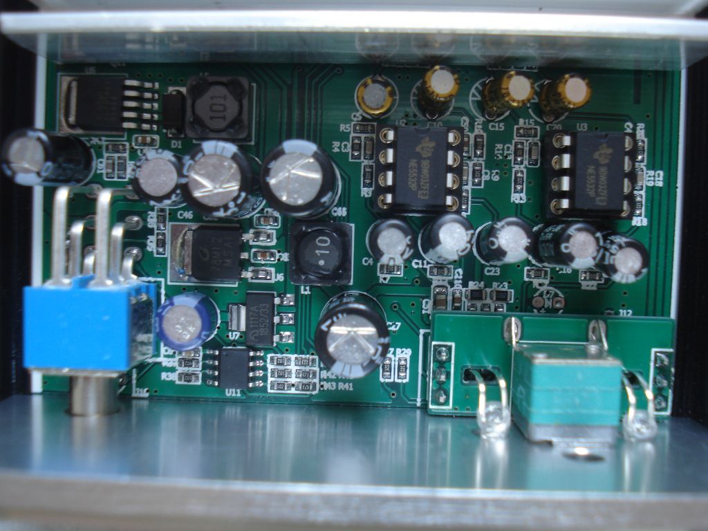

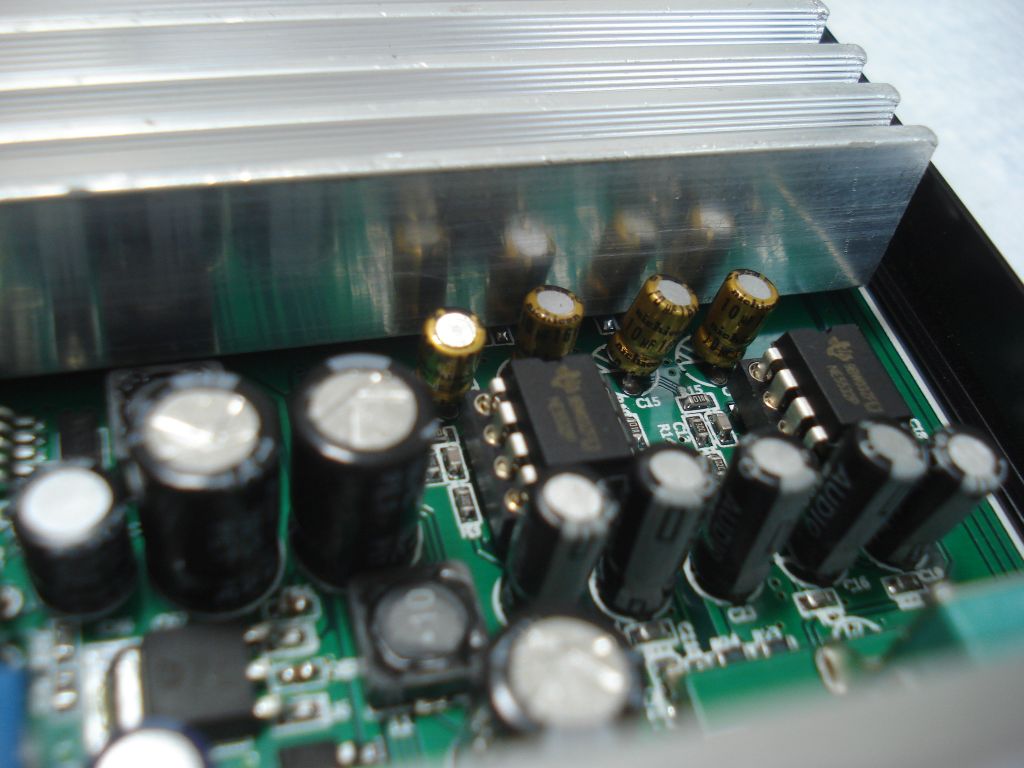

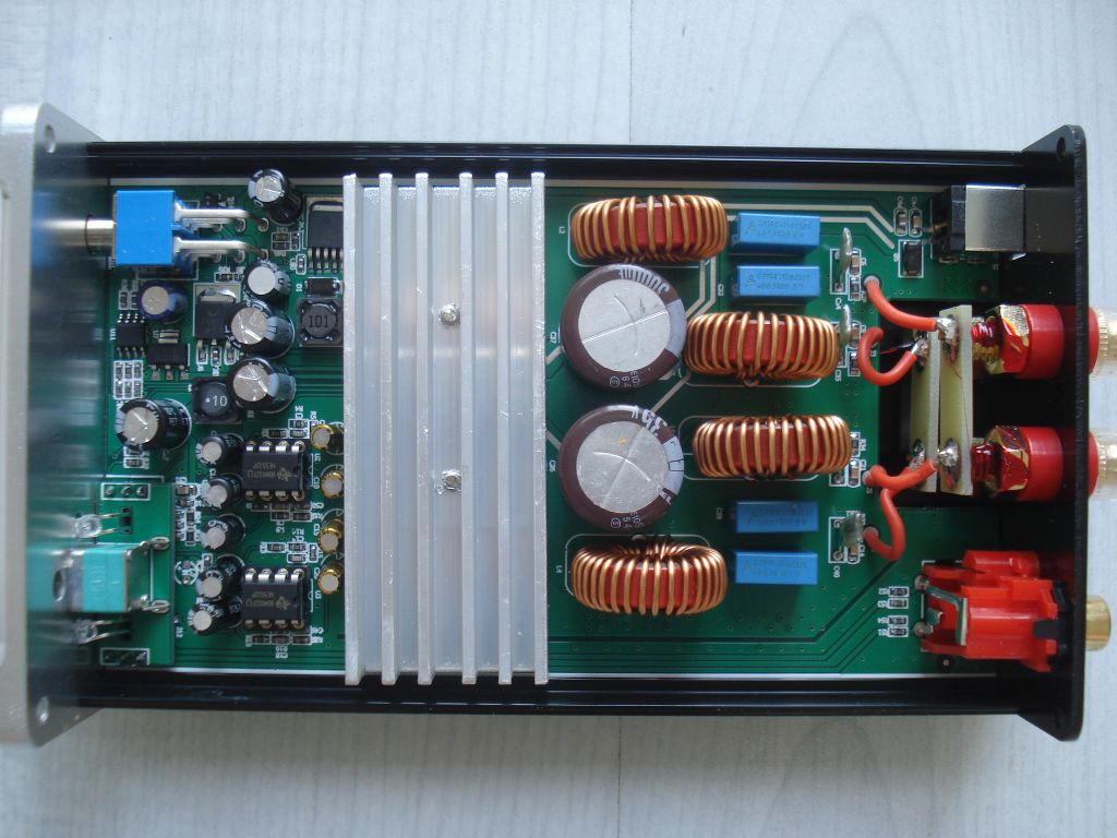

Seems you have the same version of bushellj :
Signal Input to Op-Amps are TK "Audio" Caps 10uF 50V
Signal Output from Op-Amps are Nichicon Gold 10uF 16Volt.
and other changes...
The "Tilera PCB" is fully Elna equiped.

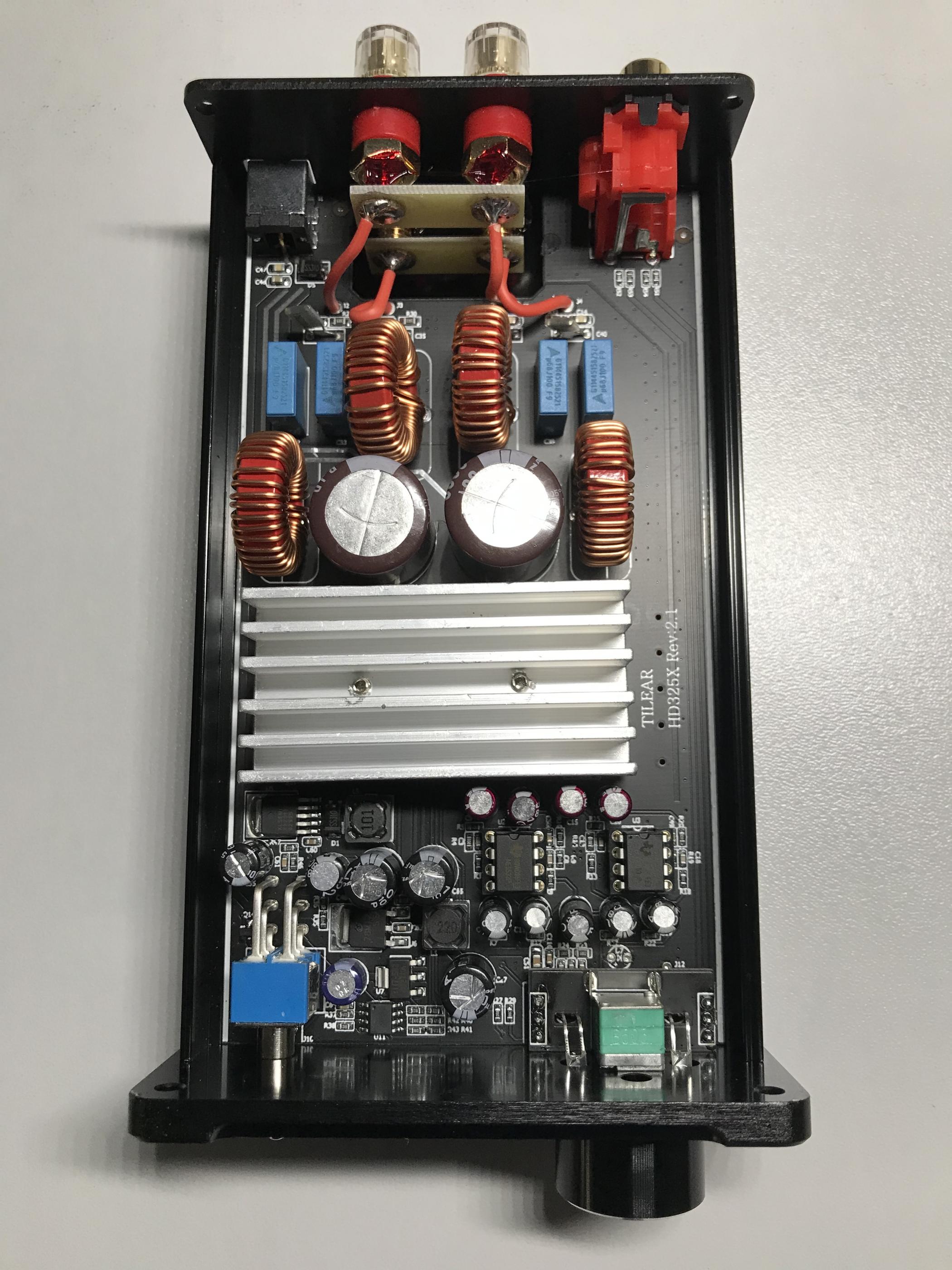

Thanks for the pictures (TOP = "Tilear" PCB)

Hi Lee (and Danny),
Looks like you have received the identical board that I received earlier this week.
Yes the caps look similar as Danny already stated and the Inductor on the 12 Volt Power Supply seems to be 10uH rather 22uH used on the original board.
You just need to update the Op-Amps to OPA1656 as I think we all now accept that they sound better than the original NE5532. I have a pair already on adapters if you want some - Same as I provided to Danny. Just PM me.
In comparison to my TPA3255 based model (Aiyima A07) The TPA3251 (Aiyima A04) certainly appears to be the better option. Having the Anti-Pop circuit is probably the prime advantage !! Both mine have been upgraded with OPA1656.
Even the Output inductors actually look better made on the TPA3251 model !!
Just running both at 30Volts from a Mean Well LRS-200-24 SMPS the TPA3251 appears to give better bass - maybe because the main Power Supply Caps are 3 times the capacity at 6,000uF as opposed to the 2,000uF on the TPA3255 model.
As for Power output (from the Data Sheet) the TPA3251 provides 100W at 4ohm and 50W at 8ohm. The TPA3255 provides 65W at 4ohm and 50W at 8ohm - All at 30Volt Supply Voltage. My KEF Q15 Speakers are rated at 6ohm.
The gain of the TPA3255 is 21.5dB whereas the TPA3251 is 20dB so not a lot of difference in the specification. I think my TPA3251 actually sounds a bit louder at a given position of the volume control. As we don't have a circuit diagram for these boards we don't know if there is any gain at the Op-Amp stage or if it is the same between the two boards.
So unless the TPA3251 isn't loud enough for you the TPA3251 would seem to be the better option for most domestic situations. I can certainly annoy the wife at anything above half volume !! My primary source is a Mac Mini just using the headphone port.

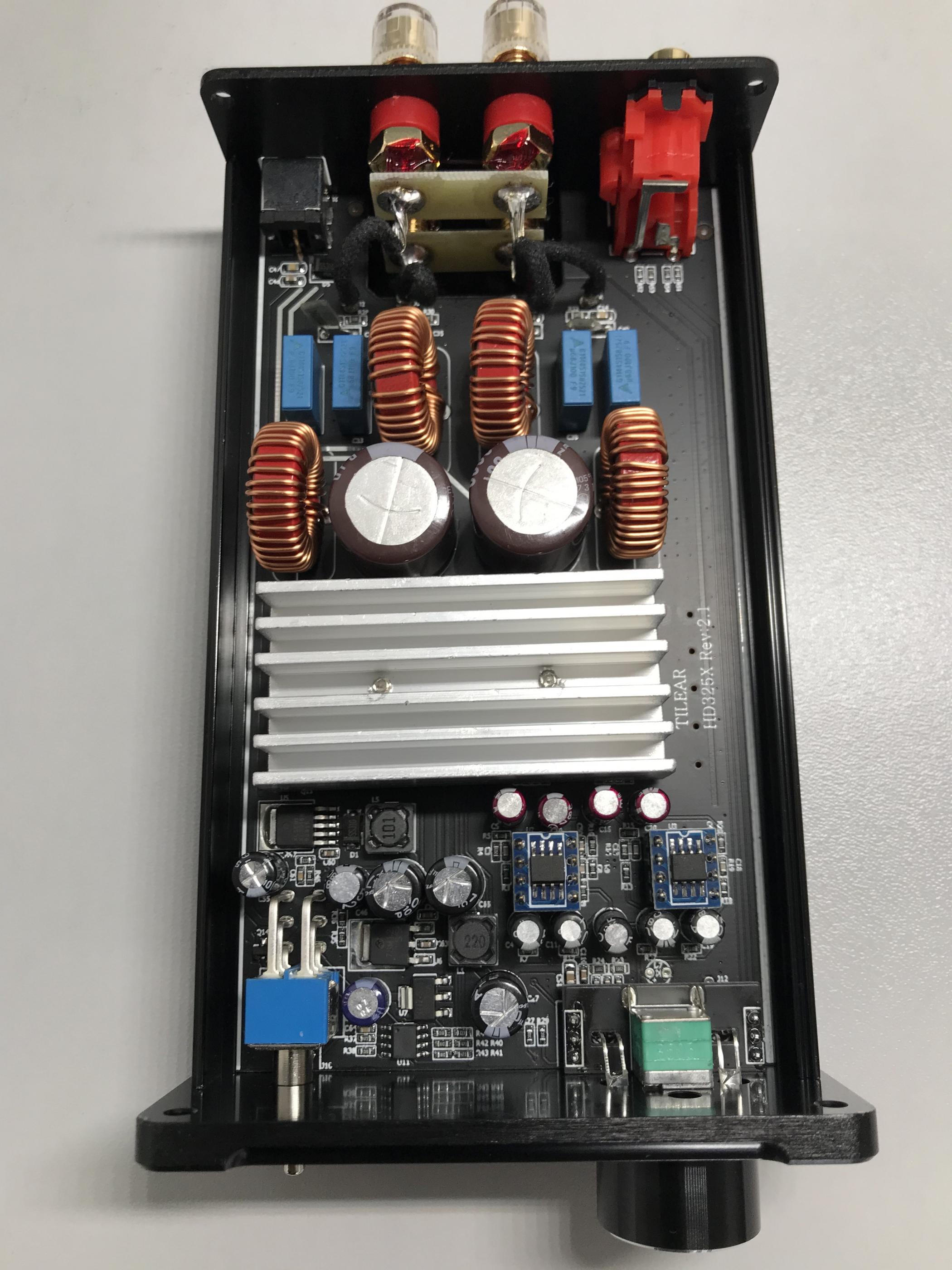

My friend's new Aiyima TPA3251 2.0 amp
I finally received delivery of my friend's new Aiyima TPA3251 2.0 amp from Amazon.com. I had ordered it from Amazon over a month ago, and I'm not sure if COVID-19 is to blame, but Amazon stated that the units were in stock, so I am not sure why it took so long to deliver it.
Anyway, I plugged the unit into my main system as a power amp and listened to it for a few hours. As with my unit and another friend's unit, the amp is thin on the bass, a bit sibilant in the highs, and basically, it just isn't exciting musically.
I extracted the stock NE5532 op amps and installed a pair of double OPA627AU op amps mounted on DIP8 adapters from eBay seller alice1101983, and the tone was warmer with a smoother presentation and more extended bass. The sound stage went from flat and forward to three dimensional with significantly better separation. The amp was definitely more enjoyable with the new op amps.
However, I was not finished, and proceeded to remove the red speaker binding posts hook-up wire and replaced it with Duelund DCA16GA 16ga Tinned Copper wire with waxed Cotton insulation. I had run out of my favorite Cardas quad eutectic solder, and used Kester 44 solder instead to solder the wires in place, and touch up all the other solder joints of all through-hole components in the signal path including the RCA connectors, capacitors, inductors, etc.
I gave everything more time to burn in and it is impressive how the little bit of wiring can improve the sound quality. I played Laurie Anderson's soundtrack from the concert film "Home of the Brave," and the music was more lively compared to when I listened to the amp prior to changing the wire. Maybe it was simply touching up the solder joints. All I know is that it sounds much better now.
Considering that I spent about $95 on the amp, op amps, some wire and a 32V DC/5A switching power supply, it makes a very affordable gift for my friend who just moved to Brazil to work with underpriviledged youth in the inner cities. I wanted to give him something that was compact and energy efficient, yet can drive his vintage speakers with ease.
I hope the TPA3251 amps that bushellj and LeeHibbert purchased sound as good as the Aiyima "black board" TILEAR HD325X Rev. 2.1 unit with Toshin Kogyo UTSP and Elna Starget Red Robe caps. It's unfortunate that the Chinese manufacturer(s) of these amps cannot ship what they advertise. As daniboun previously advised, it might be best to spend the extra money to get the "black board" TILEAR HD325X Rev. 2.1 unit.

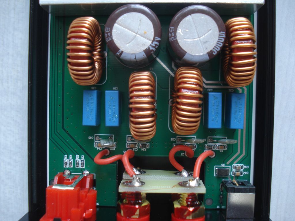

LeeHibbert,
- All you have to do is remove all four hex head screws from the rear plate and the four hex head screws from the front plate.
- Remove the top plate of the chassis.
- You'll also need to remove the Phillips head screw that mounts the RCA phono jacks to the rear plate.
- After that, you can gently pull the rear plate with speaker binding posts from the phono jacks, and swing the rear plate up and out of the way of the bottom half of the case.
- Then you should be able to slide the bottom half of the case rearward to remove it.
Rich
Perfect instructions, got the bottom off. I wanted to unscrew the heatsink to see if there was a revision number hidden by it, but they have sealed the screws.
The green board has Rubycons and Nichison. It would be fun to compare, but since James and myself are in the UK, that won't happen any time soon. Mind you I fancy doing some gravel riding in South Carolina, so I could always bring my bike and 'Green Board'.

Hi Lee.
I have had some OPA627AU on order from the same supplier as Rich since I ordered my original TPA3255 unit but they still haven’t arrived yet !!?? It will be interesting to see the comparison with the OPA1656. I am certainly not short of bass with these Op-Amps but then I don’t expect much from my little bookshelf speakers. One day I might have the time to try some more serious speakers - I have some old Epos ES14’s in the loft which are notoriously difficult to drive but used to sound good when set up right.
I have found that my enjoyment of music with both these amps has really come done to the quality of the source material - they are that transparent. I ripped loads of CDs some years ago but find that the newer HQ material on You Tube typically sounds better. I have not yet tried hooking up my old Arcam CD Player which was my default source before the Mac Mini took over and I now stream everything - the CDs just stay in the cupboard !! Just seems too big and clumsy now !
