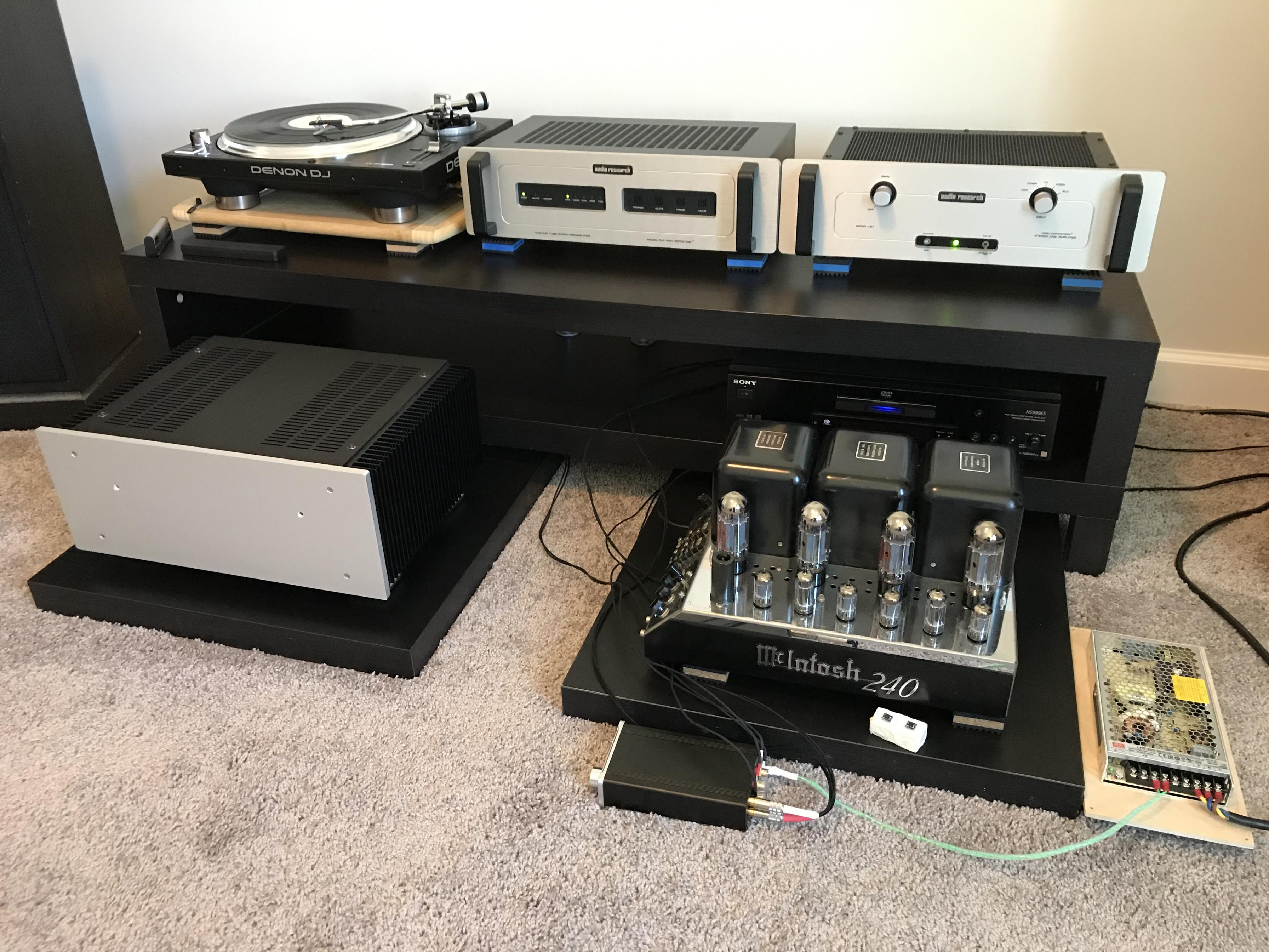

In comparison to my tube amps, I'll take the tube amps, the MC240 and Dynakit Stereo 35, over the Aiyima amp. Tube amps with my Klipsch Forte II speakers create this incredible scale and image that is life-size and life-like. The Sony VFET amp sounds very much like a tube amp and creates a huge soundstage with incredible depth and detail. The Aiyima TPA3251 and the Texas Instruments TPA3255EVM amps are great, but they cannot create the soundstage depth or the tonal richness of my reference amps. Interestingly, most people would be very pleased with the Aiyima amp's sound until switched to one of the other amps for comparison.
The best sound I have ever heard from the TI TPA3255EVM was when a friend lent me a now-extinct PonoPlayer DAP with the audio output circuitry designed by engineers at Ayre Acoustics and used an ESS Sabre32 ES9018K2M DAC. I used custom-built balanced cables from the PonoPlayer to the RCA connectors on the TPA3255EVM configured in differential mode, and I was amazed how good it sounded. Using a balanced source with the TPA325x amps in differential mode is probably the best scenario. If I had a fully balanced sources and a balanced preamp like an Audio Research LS22, I could really take advantage of the TPA325x amps run in differential mode.
So tomorrow, I will wire in the Coilcraft inductors and do some more listening. daniboun has provided me the contact information with Audio Science Review to have them conduct some testing of the Aiyima amp using different op amps.

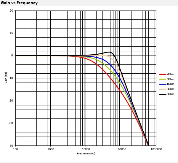

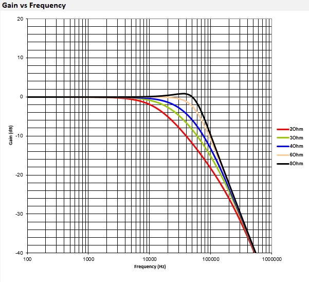

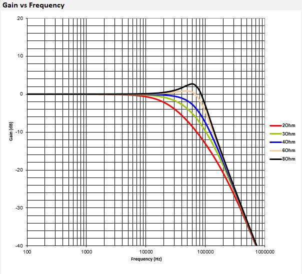

I installed the Coilcraft MA5173 7uH inductors in the Aiyima TPA3251 amp and the sound quality is further improved in terms of clarity, detail and imaging. The amp with the stock inductors is on the left, and the same amp with the Coilcraft inductors is on the right.
I measured the stock inductors and they are 12.5uH. I calculated cut-off frequency and Quality Factor, Q, for three different inductor values using the free TI Class D LC filter designer tool:
..L............C........f(cut-off)............Q
7uH........ .68uF....72.9kHz...........0.623
10uH...... .68uF....61.0kHz...........0.522
12.5uH... .68uF....53.7kHz...........0.474
Below are the plots for L = 7uH, 10uH and 12.5uH (C = 0.68uF):
Depending on your speaker system's impedance, the Coilcraft MA5172 (10uH) might be a better inductor to use. TI's TPA3251EVM amp uses 7uH.
