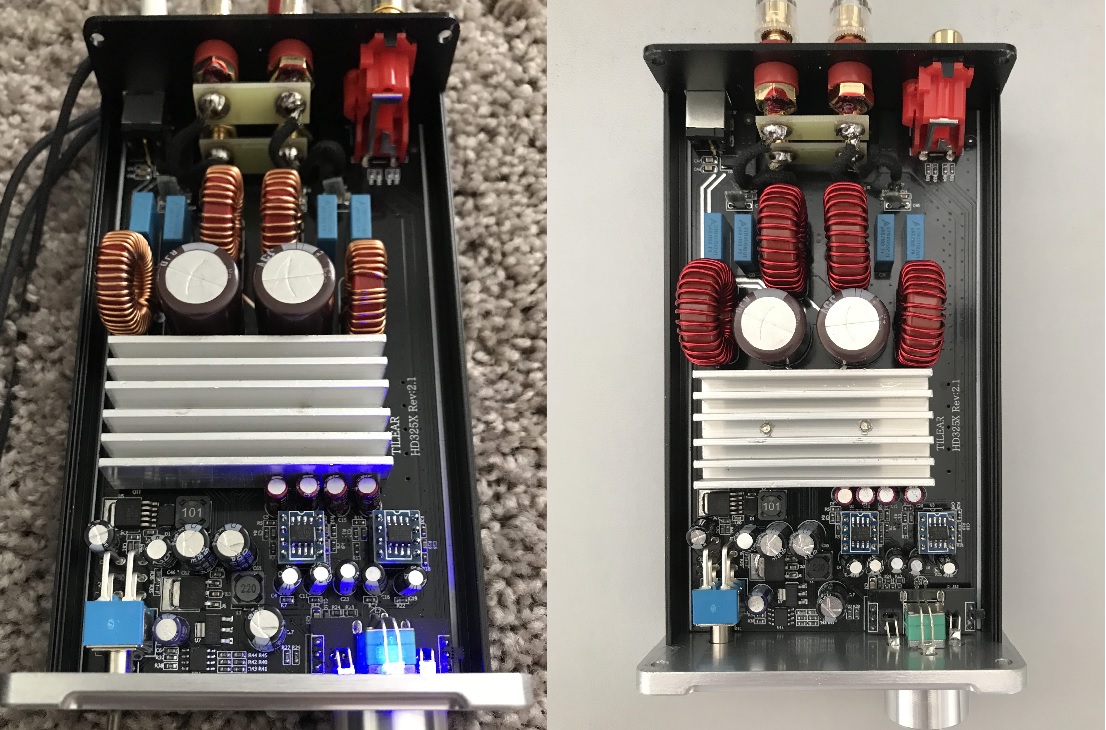

The Coilcraft inductors wire and leads are slightly larger in diameter than with the stock inductors, and the through-holes are somewhat tight, so you will need to use a good solder sucking tool and technique to thoroughly clear out the holes. Otherwise, it will be next to impossible to properly install the Coilcraft inductors.
You also have to be careful with your solder iron not to touch the adjacent components like the Epcos output filter caps. The space is very tight.

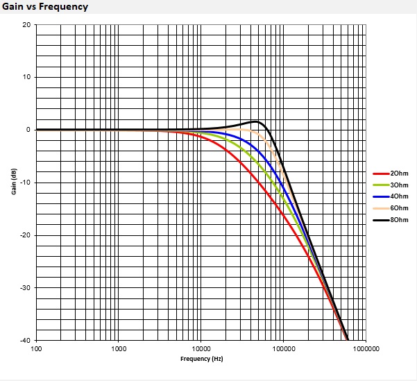

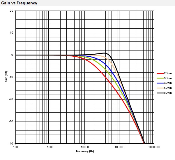

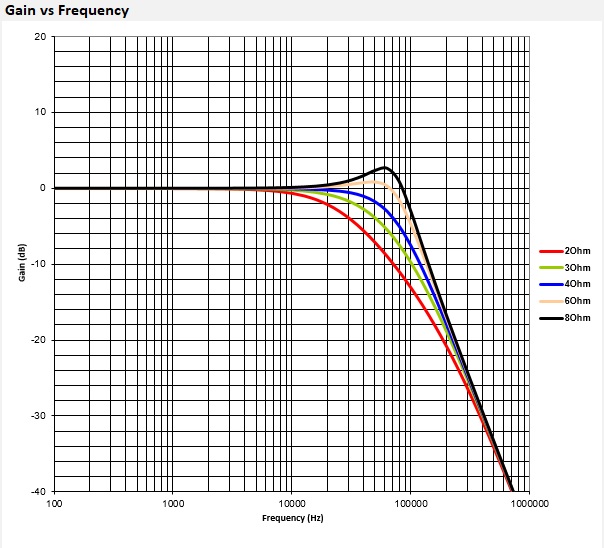

I installed the Coilcraft MA5173 7uH inductors in the Aiyima TPA3251 amp and the sound quality is further improved in terms of clarity, detail and imaging. The amp with the stock inductors is on the left, and the same amp with the Coilcraft inductors is on the right.
I measured the stock inductors and they are 12.5uH. I calculated cut-off frequency and Quality Factor, Q, for three different inductor values using the free TI Class D LC filter designer tool:
..L............C........f(cut-off)............Q
7uH........ .68uF....72.9kHz...........0.623
10uH...... .68uF....61.0kHz...........0.522
12.5uH... .68uF....53.7kHz...........0.474
Below are the plots for L = 7uH, 10uH and 12.5uH (C = 0.68uF):
View attachment 842889 View attachment 842890 View attachment 842891
Depending on your speaker system's impedance, the Coilcraft MA5172 (10uH) might be a better inductor to use. TI's TPA3251EVM amp uses 7uH.

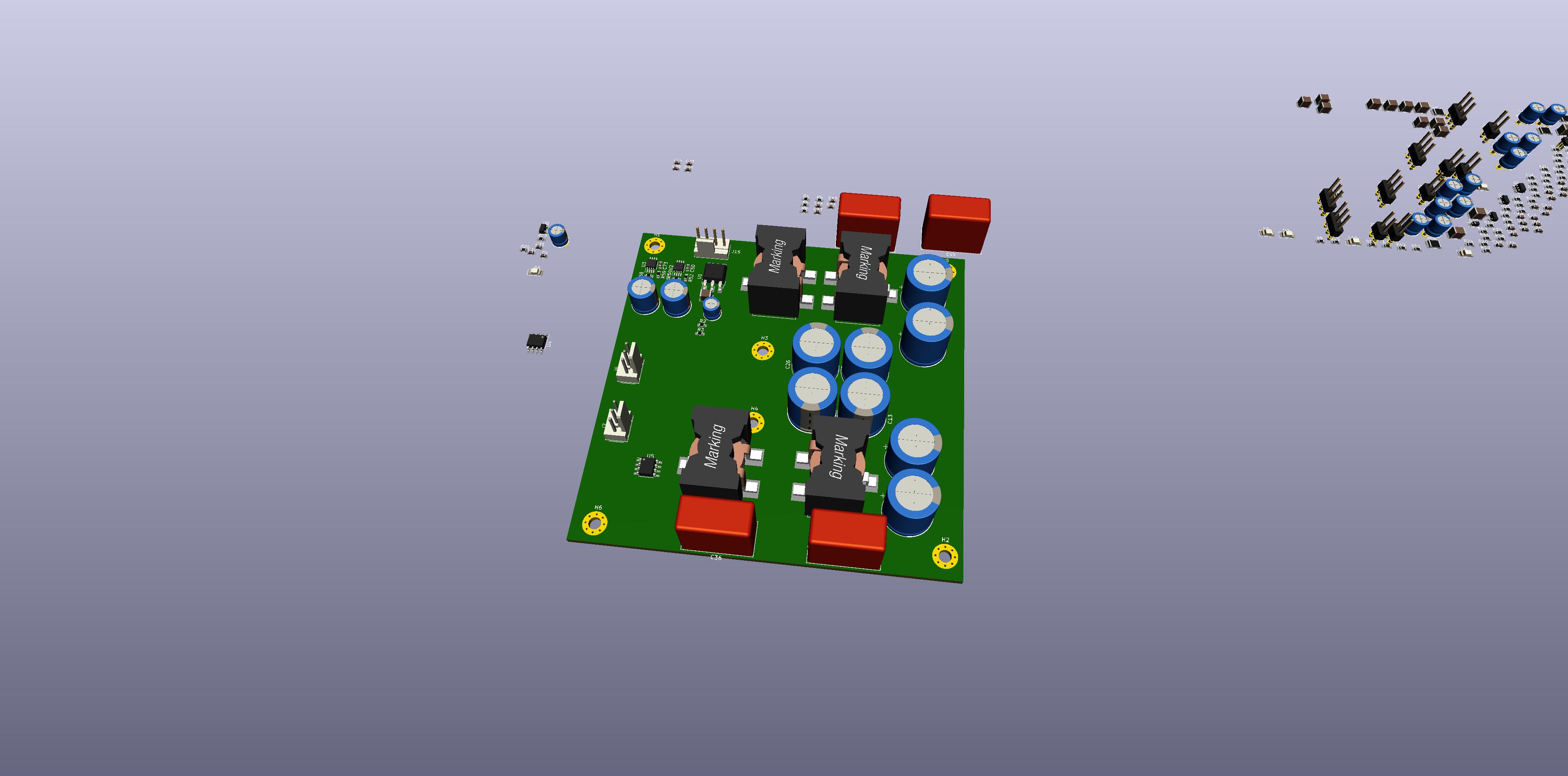

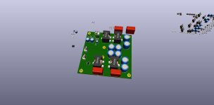

I made an order for Wurth 7443630700 , Codaca CSCF2014 and nanocrystalline core
When I receive them I will take measurements.
I am preparing a PCB for these inductors.

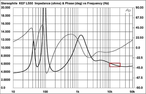

You really need to understand the impedance vs. frequency response of your speakers to know whether changing the output filter inductance will have a positive effect or not. I chose the Coilcraft MA5173 based on the fact that the 7uH inductance appears to be a better match to my KEF LS50 speakers than the 12.5uH stock inductors. Here is a plot of the impedance vs. frequency response for the KEF LS50 speakers from Stereophile where I highlighted the 10-20kHz impedance dropping from 6 to 5.6 ohms:
My Klipsch Forte II speakers have an impedance of 10-12 ohms in the same range of 10-20kHz, which could result in an actual rise of high frequency content based on Texas Instruments' LC filter designer spreadsheet. That hump in the 8 ohm curve (black) between 10kHz and 90kHz is not desirable.
As vacuphile mentioned before, a 10uH inductor like the Coilcraft MA5172 will work for most speakers with 6-8 ohms nominal impedance, and a set of 4 will fit inside the Aiyima chassis.
