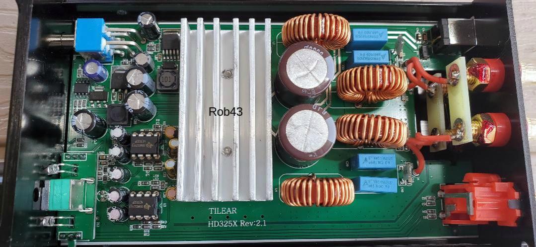

So this is what I got with the Green PCB :-
New Circuit Board inside - No longer branded “Tilear" but otherwise looks similar. No version numbers on the PCB !!
From the look of the PCB compared with the TPA3255 they appear to be from the same design house as most of the tracks are identical. The only major difference is the Switch (Double Pole) and the extra circuitry in the TPA3251 model adjacent to the switch which I am guessing is the Anti Pop stuff.
Main Power Supply Caps are 2 x Elna 3,000uF 35V. Interesting that this is 3x bigger than the TPA3255 model (2 x 1,000uF 50V) but lower voltage of course.
12 Volt Power Supply Caps are mostly Rubicon 470uF 16Volt
Signal Input to Op-Amps are TK "Audio" Caps 10uF 50V
Signal Output from Op-Amps to TPA3251 are Nichicon (gold coloured) 10uF 16Volt.
So the caps, other than the main Elna ones, are all different from the original board.
Every batch of boards appears to have different components - But that is what makes buying stuff from China so exiting - You have no idea what your going to get until it arrives !!

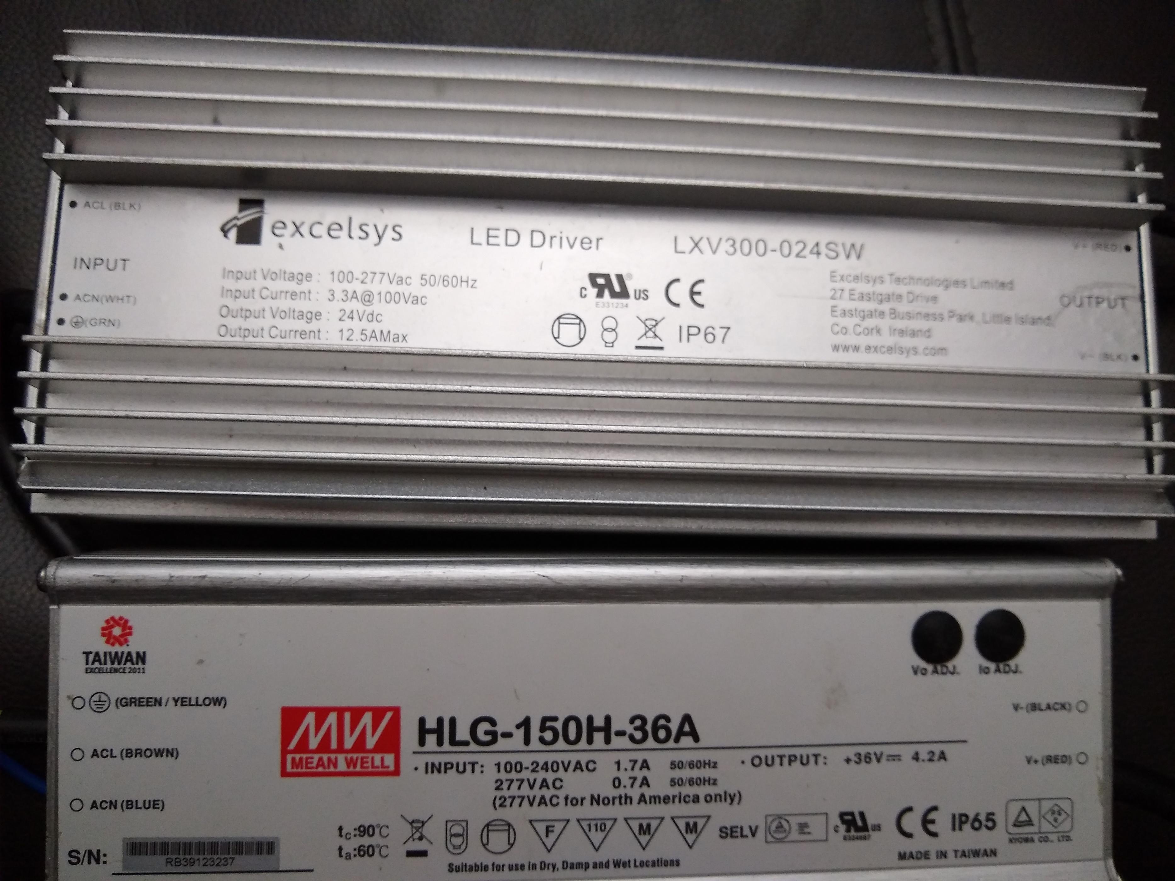

Two of mine. Decent manufacturer with real certification, fused inside and sealed. They are designed for led signs to be outside and to operate 24 7 365 at full power. Even used they have a great value.
Uw Daniboun. I love the French saying, true and awesome.
Meanwell is a great brand, I know it and own one of their PSU.
