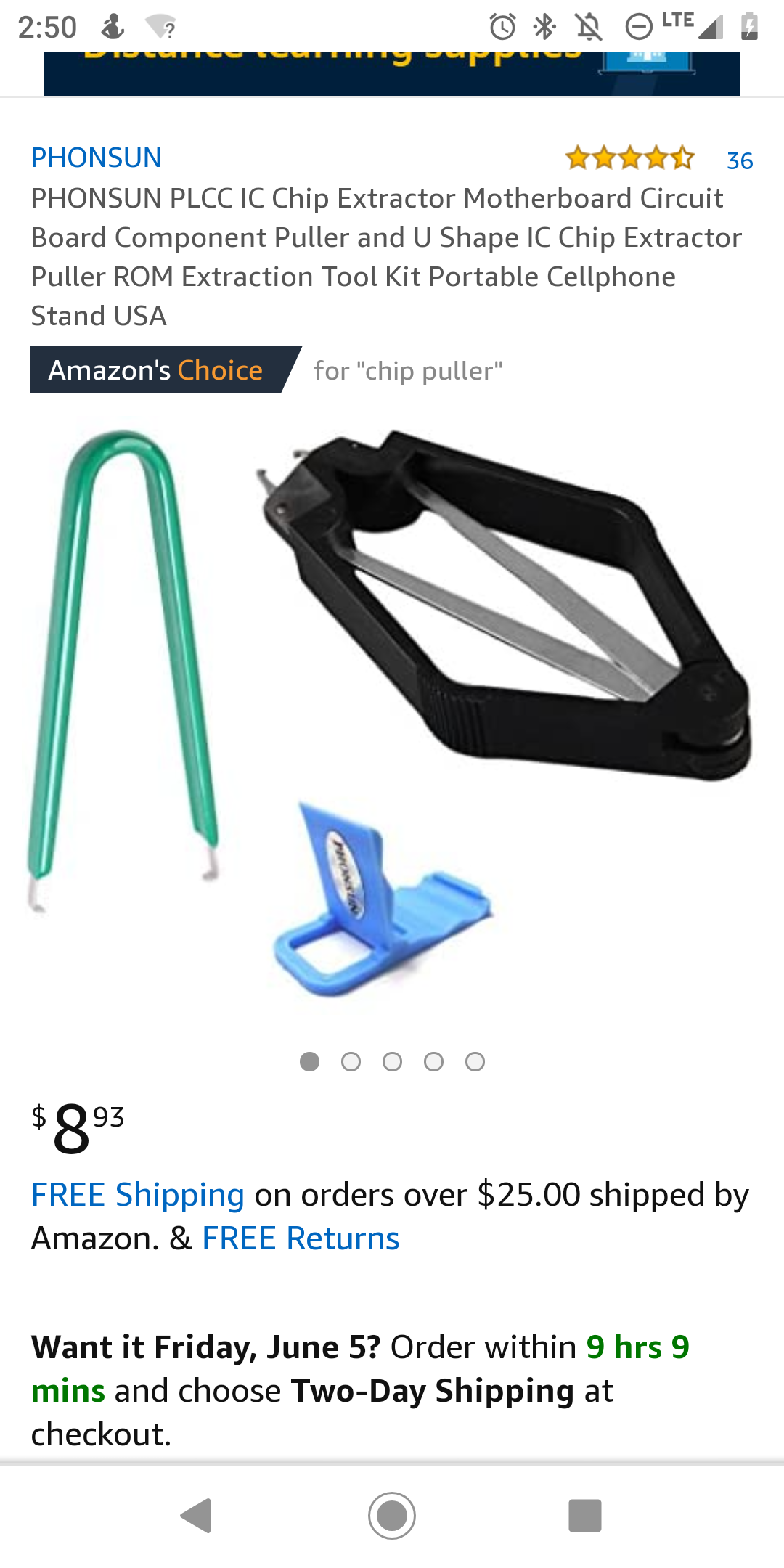

Oh and of course change the Opamps. Speaking of which, is there a proper tool to remove the opamps?

There is an easy way to remove OP Amps, you just need a fairly thin and solid wire that you insert between the socket and the OP Amps and then you gently pull it towards you and straight. Works fine for me !

Thanks for the tip.

The tool is a dip extractor tool. Not required but makes life easier and pins do not get bend. I am adding a pic of one without the link as I have no idea if the seller is good. They are common.
The problem with the Aiyima Amplifiers is the Signal capacitors are so close the the ends of the chip that there is no space to use a normal extractor tool.
I have found that a pair of angled tweezers are the best tool to remove the original DIL8 chips as ou can slide it in between the legs from the side and then just pop it out of the socket.
