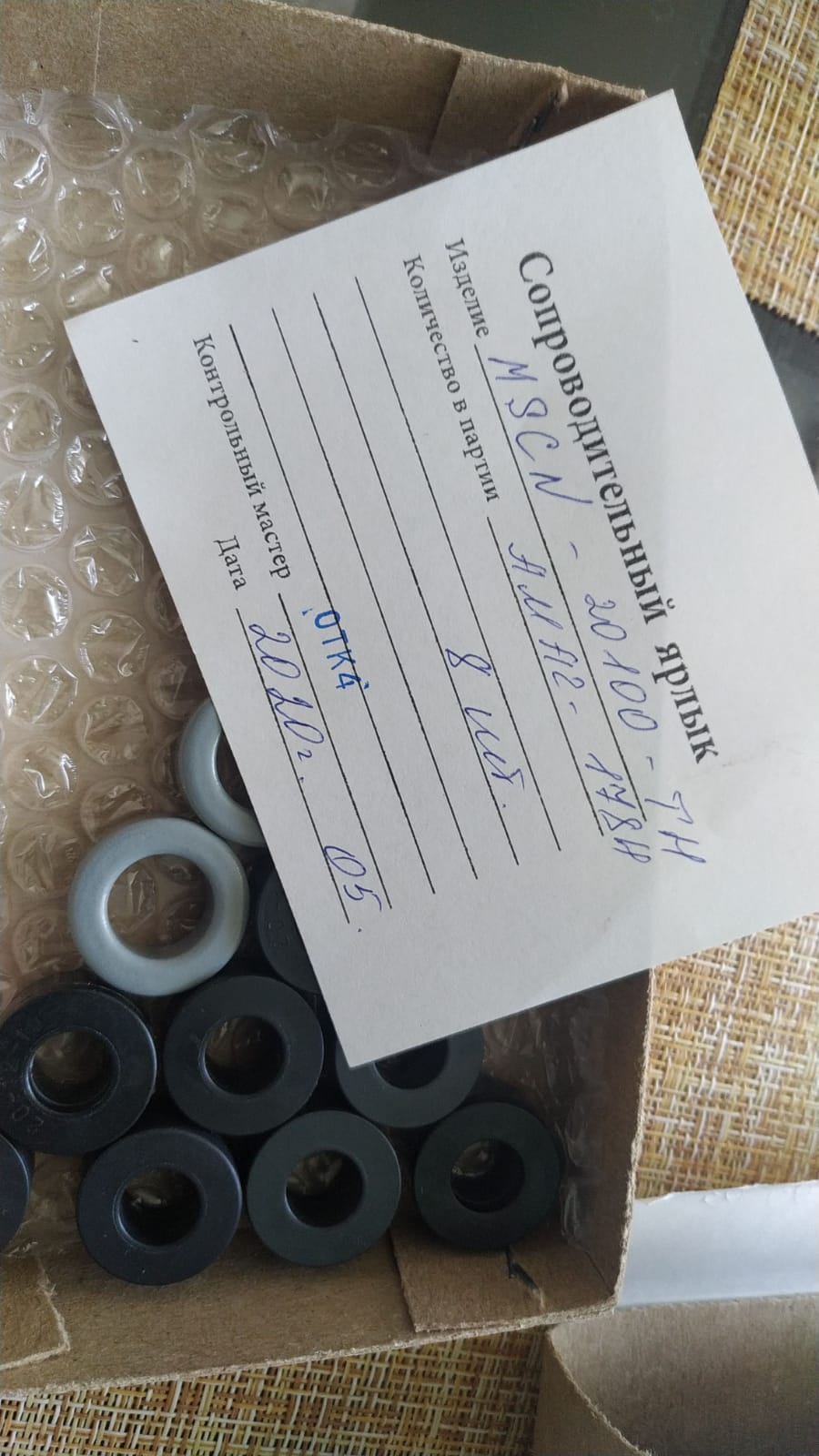

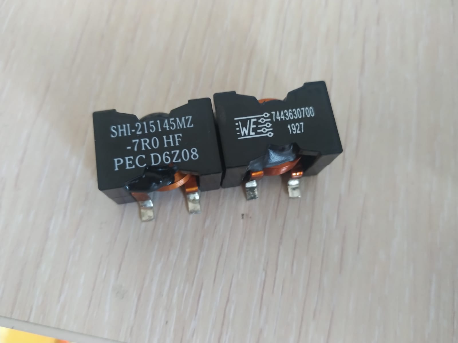

I made an order for Wurth 7443630700 , Codaca CSCF2014 and nanocrystalline core
When I receive them I will take measurements.
I am preparing a PCB for these inductors.
