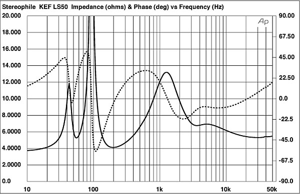

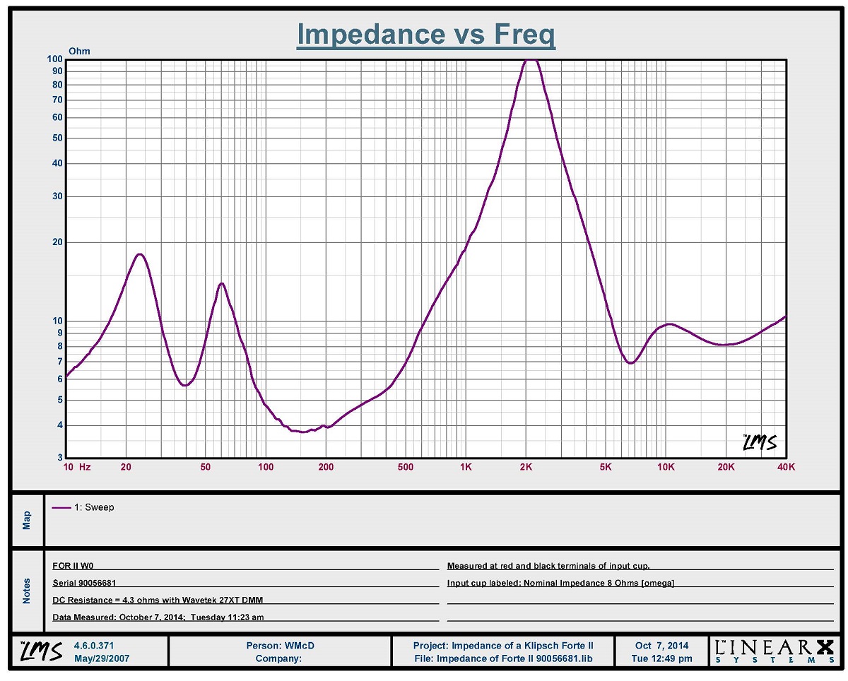

ClaudeG, you are correct. I bought the Aiyima TPA3251 2.0 amp to use with my KEF LS50 speakers. My Klipsch Forte II spekers in my main system has a completely different impedance vs. frequency response between 10kHz and 20kHz.Having said that, I can't outline enough that simple copy paste from "Rhing" isn't a good idea at all. He knew what he was doing and the values he chose where not just as per TI's example (that's merely a coincidence)... but as per TI's calculation sheet. In short, if one wants to play with that, output coils value and output caps value have to be CALCULATED for YOUR speakers. I am quite convinced "Rhing" would have chosen other coil values for his other speakers...
Caps and coils form the output filter of this Class D amp and it works in conjunction with the associated load. In short, you have to know the impedance of your speakers in the 10 to 20kHz band and then calculate various cap and coil combos until you find one that suits you (gives the best possible response and damping).
Claude
KEF LS50 Impedance vs. Frequency
Klipsch Forte II Impedance vs. Frequency
After installing the 7uH Coilcraft inductors, the amp sounded better suited for the KEF LS50 speakers. With the Klipsch Forte IIs, the amp still sounded good from the lows through the mid-highs, but the highs were slightly tipped up where my system sounded brighter overall. If I wanted to optimize the amp to the Klipsch Forte IIs, then a similar inductance to the stock 12.5uH inductors would be appropriate.
