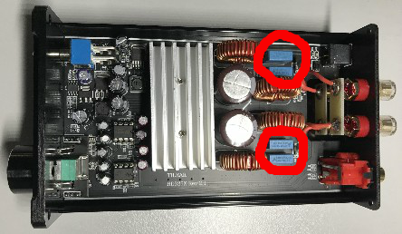

I don't recall seeing what size caps. I believe the originals are 0.68uf or am I wrong?
If you are referring to the Red circles, yes they are 0.68uF.

I have calculated the filters we want for the RF-8000-F and I will change both coils and caps (the latter because of their value, the former because of their value and quality).

My new build is getting:
1) My power caps = 3300 uF
2) Inductors = 10 uH
3) Output filters 0.68 uF and or 1 uF (I'm trying both)
The biggest issue is size, there's a very LIMITED amount of space to work with.

"While at it, it would be pity not to reconsider the entire output filter (read caps and coils) and of course to adapt the unit to the LS. These are quite specific and have around 10 Ohm between 10 and 20kHz, so that requires some unusual calculations.
Long story short, as sadly compatible 12.5uH quality coils at Mouser's don't seem to exist, I will have to play with 10uH and 15uH coils... and also with the caps value that are available in MKP (don't want to start adding caps in parallel to get the perfect exotic value). That leaves me with 2 choices, as the 12.5uH / 0.25uF combo doesn't exist in real life...
1) 10uH / 0.22uF, very good results up to 20kHz and far beyond (quite free wide band response), sadly cut frequency perhaps unusaly high at 107kHz but still 24dB attenuation at 400kHz and 32dB at 600kHz (carrier of the Class D chip).
I like that unusual choice as still resonable coil re distorsion and losses and size, it gives a very good Q... the only downside I see is the cut frequency is a bit high in absolute terms, but have no clue if that's a real problem as I never played with Class D.
2) Classical choice by the book, 15uH/0.3uF, perfect Q, Fc at 75kHz, -34dB at carrier's frequency, as for 1 less than 0.1dB deviation at 20kHz : the "computer's choice"... and a choice that is also more acceptable for different LS. So what's wrong with it? Well, a similar sized 15uH coil is likely to be less performing in audio terms than a 10uH one (distorsion & Co), and it is all about audio performance, isn't it? Hence option 1's existence... especialy as its only downside is mainly (only) 4dB less damping at the carrier's frequency while it therefore still keeps output coils reasonably sized... "
In short, if you go 10uH coil with the Klipsch look at what would happen if you don't change the cap value aswell and or move to 1uF...
Hint, with your LS and 1uF you get a 2dB peak at 20kHz (bright sounding) and a +4dB at 40kHz peak, not great at all mate...
Oh and with 0.68uF it is slightly better, but still not great for the 10R you are considering in the treble band...
Good luck
