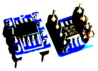

I just received the OPA 627AU IC's and installed them in my Aiyima 04 place of the stock 5332.
Volume level dropped by quite a bit , almost half .
Is this typical for this IC swap ?

Nope!
Often in that case one of the pins is not making a good contact
If the adapter board isn't rock stable in the socket, try to rock it slightly or push it further down if not inserted properly.
They should be NO volume loss at all, gain structure is elsewhere around the op amp (resistors, fixed gain per definition)

Thanks for your reply Claude , the 627AU chip on adaptor went right in to the mount easily and securely .

I removed the 627AU IC's and reinserted the 5532 IC's and typical operating volume returned .

The opa627 is a single opamp while the ne5532 is a dual.
You will need one that has two of the opa627 on a board to actually replace the one in your application.
Also the ebay opa627 are all ad744, not bad at all for the price, but are not what are advertised.

Do they both have the second chip on the bottom of the adapter like this picture ?

Again, the ad744 are great sounding fet input opamps, but that particular vendor has been known to sell total garbage, fyi.
You can’t use a single opamp in place of a dual part.
Thanks , the 627 is only a single chip , there isn't another one on the bottom .
Is the single chip unusable ? Or just result in half the power ?

Unless you're able to solder in an identical bottom chip on both adapters, I'd call them unusable.

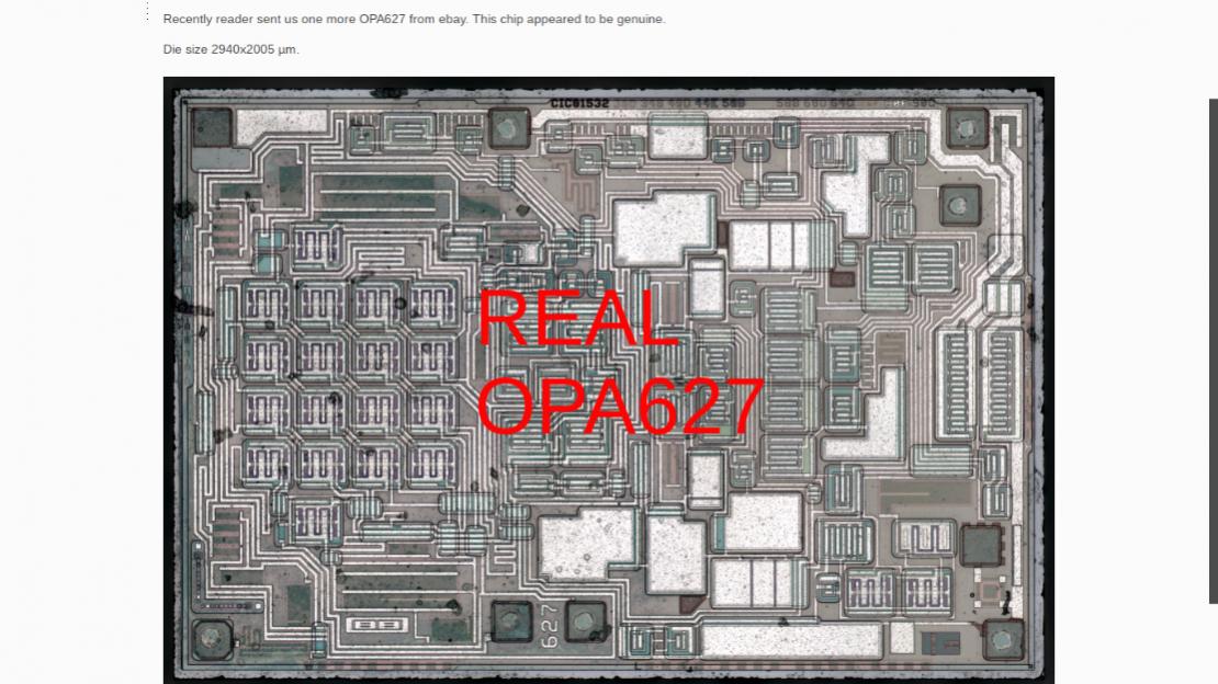

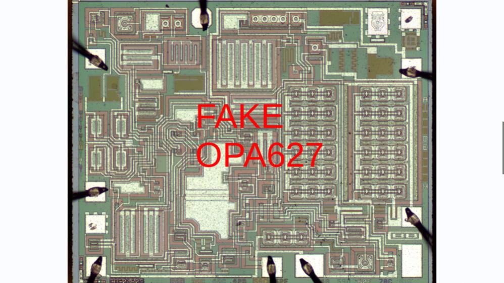

OPA627 is very expensive. The price of the IC chip is over $15. A DIP8 conversion module with two of them costs over $30. The distribution of new IC chips is small, and most of them use used IC chips.
Most of the cheap OPA627s sold in China are fake. We cut the name of the cheap OP amplifier and sell it with the OPA627 name stamped again.

Let's face it, a ~$4 dollar OPA627 from china is a fake. The same real Ti OPA627 from Mouser or Digikey is about ~$28 each.

EBay electronics 101 regarding the fakes. Try searching for “fake opa627 ad744”.
There are many great sounding opamps out there, and for the price of 4 legit opa627, I would rather have something else. I do use the ad744 however.
