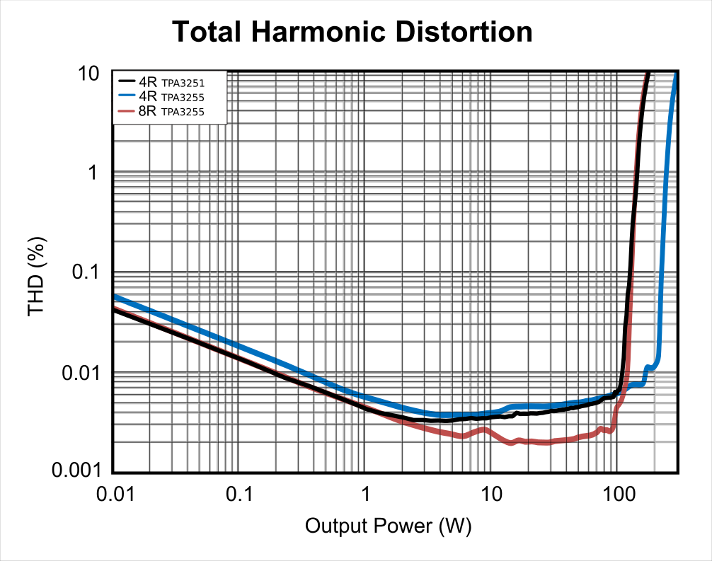

Plus it seems that the 3251 has ever so slightly lower distortion vs the 3255.

From the datasheets:

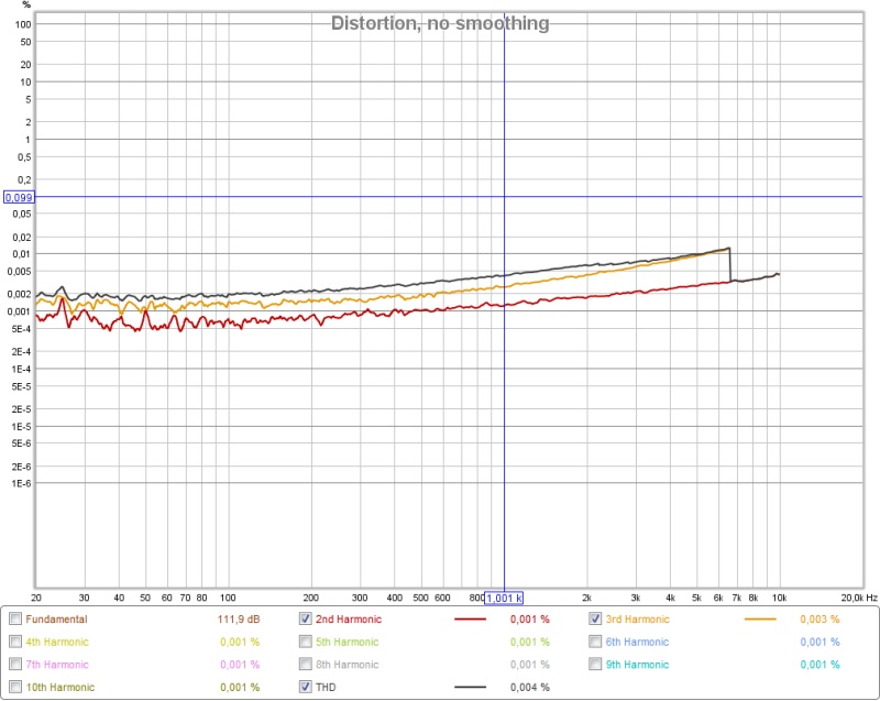

The tpa325x range is known for having rising 2nd order distortion as frequency decreases and it will be interesting to see if that is improved.

it appears that the 3rd harmonic is still dominant and would be more important that the reduction in 2nd harmonic value? Not sure how you could lower the 3rd harmonic or make it lower in level than the 2nd?
Kindhornman,

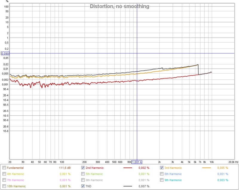

I do not think that the reduction of the third harmonic below 0.003% will be noticeable to the ear. Conversely, you can raise the level of the second harmonic using a DSP.
That measured analog amplifier class A. This amplifier became my standard for sound quality.
The odd order harmonics are dominant with these designs. This is because they are bridged/balanced and as a result the even order non linearities tend to cancel out.

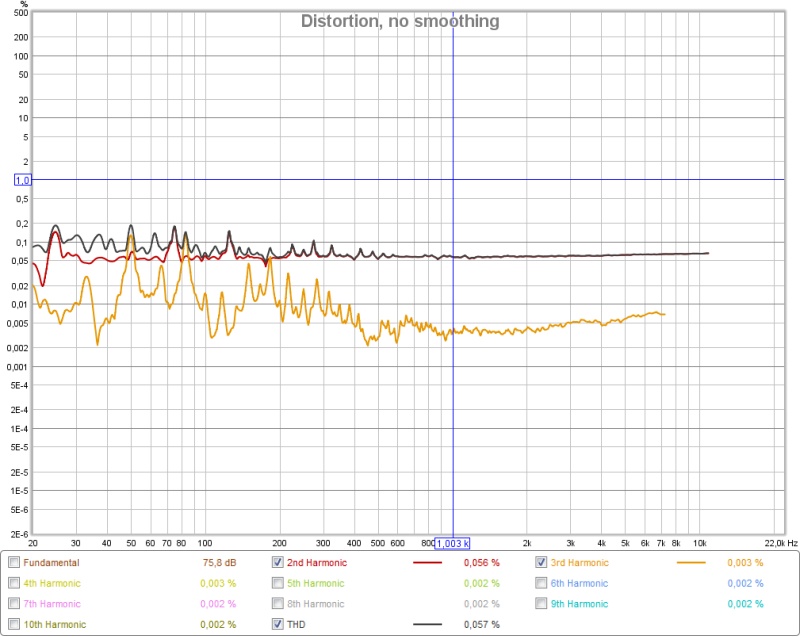

Gmarsh I am using an ASUS Xonar Essence ST soundcard ADC for the measurements. The signal source is a DAC based on the ESS 9018.

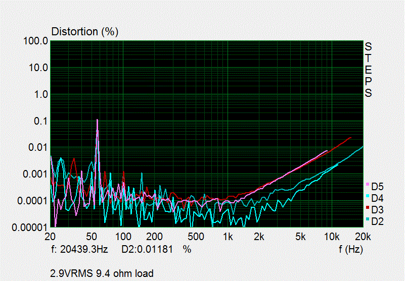

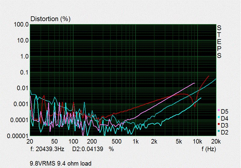

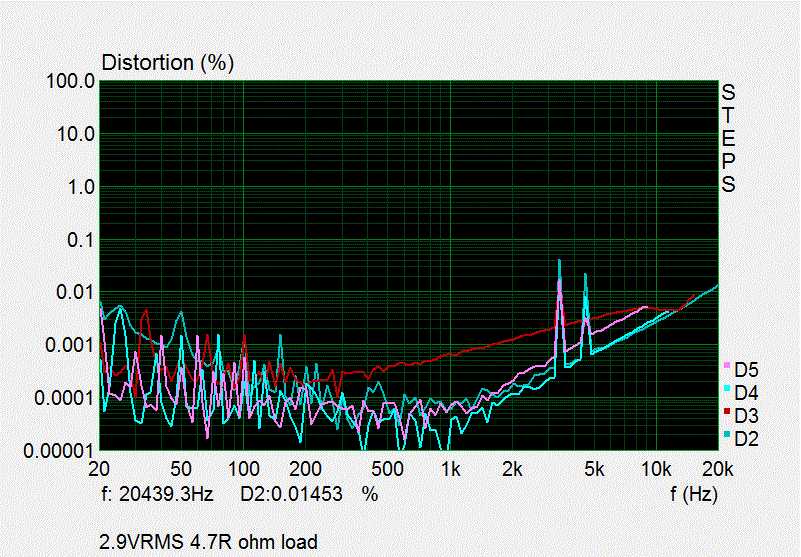

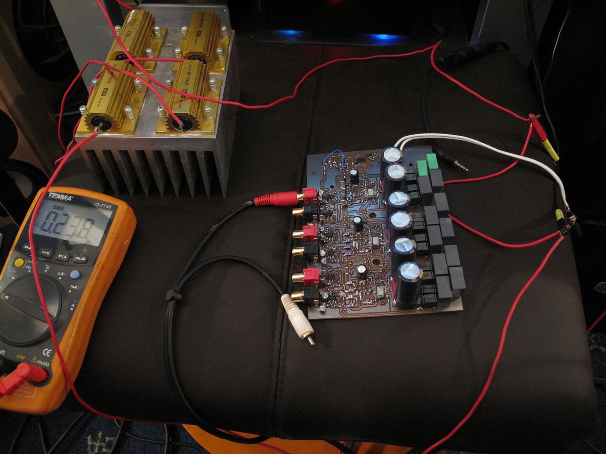

Well I've now got the amplifiers back in their case and wired up to the proper power supply. (A picture of the old one can be found in this thread somewhere).
It is always more of a challenge to build a multichannel amplifier vs a stereo version. Circuit board complexities increase making routing harder and with circuits that deal with both low and high level signals this can result in some degradation in overall performance.
With my previous 6 channel design this was the case but only to a small degree. The overall level of 2nd order distortion was higher than it should otherwise be and instead of hitting a minimum of say 0.000x% it was sitting more around the 0.001-2% level. Nothing excessive, but compared to my implementations with the TPA3250 in combination with the PCM5242, I knew I could do better.
Of course the 6 channel amp uses single ended inputs and thus requires a degree of signal conditioning to feed the TPA3251s. The other implementations had the PCM5242 literally centimetres away from the 3251 and driving it balanced, so that could have also been a factor.
The old 6 channel vs new 6 channel had one slight difference besides the post filter feedback and that was how the RC filtering was applied. Previously I had a 3.3R resistor feeding each gate driver PSU pin. This is how the datasheet suggests you isolate the gate drivers from VDD, with VDD fed directly from the regulator.
The demo boards do it slightly differently though. They have the gate driver pins connected directly to the regulator with VDD then fed via a 3.3R resistor.
In my PCM5242 implementations I went with the second options as it's ever so slightly less complex (one 3.3R resistor vs two!😀). As this appeared to work really well I figured I'd duplicate that in the new 6 channel, post filter feedback, implementation.

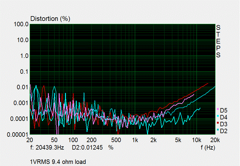

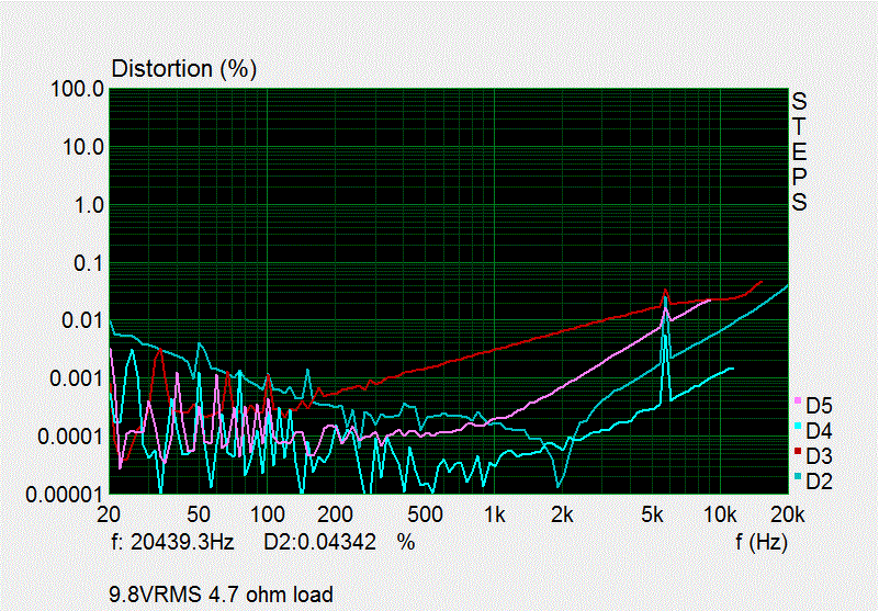

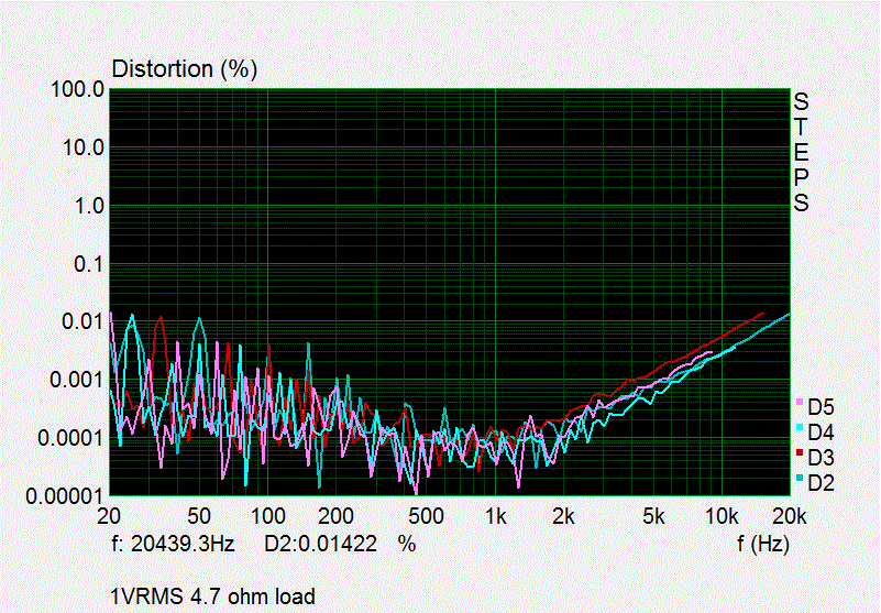

Either way I have now measured all 6 channels and can say that this is a definite improvement vs the old one. It basically solved all the old issues, gives lower noise and a frequency response that's largely unaffected by the load impedance.
4 out of the 6 channels measure as the attached pictures show. Drive levels and the load connected are annotated.
The other 2 channels do show slightly higher levels of 2nd order but in this case it's only to a level of around 0.0008% instead of ~0.0002%.
Ignore the uneveness towards the lower frequencies as this is a result of some ground noise. And ignore the odd spikes here and there as that's an anomaly in the ASIO configuration that pops up every now and again.
