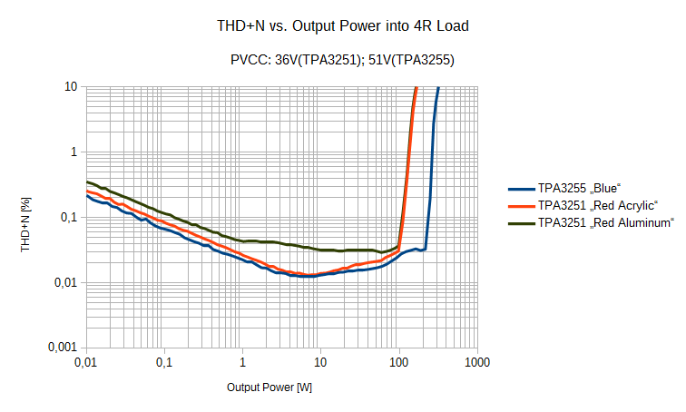

No question that film caps provide better THD performance than MLCC's, if the voltage swing on the cap in the circuit is enough to cause the uF's to change with the audio signal.
Try repeating that plot at lower test frequencies and see how bad it gets.
Well, seems like you hit the trap. 😉
Two of these 3 amps use MLCC, one is using foil.
THD vs frequency is another story. MLCC (usually) tend to increase at low frequencies, yes.

Well, they might be winners in a different amp situation. The unanswered question is, if these foil used is not suitable due to inner construction (stacked vs. wound) and/or geometrical size and location regarding noise pickup.

MKT: R82DC4100AA60K
MLCC: GRM21BR71E105KA99
Data for the MLCC:
Capacitors | details for GRM21BR71E105KA99# | Murata
Have a look at dc-bias and ac voltage rms.
