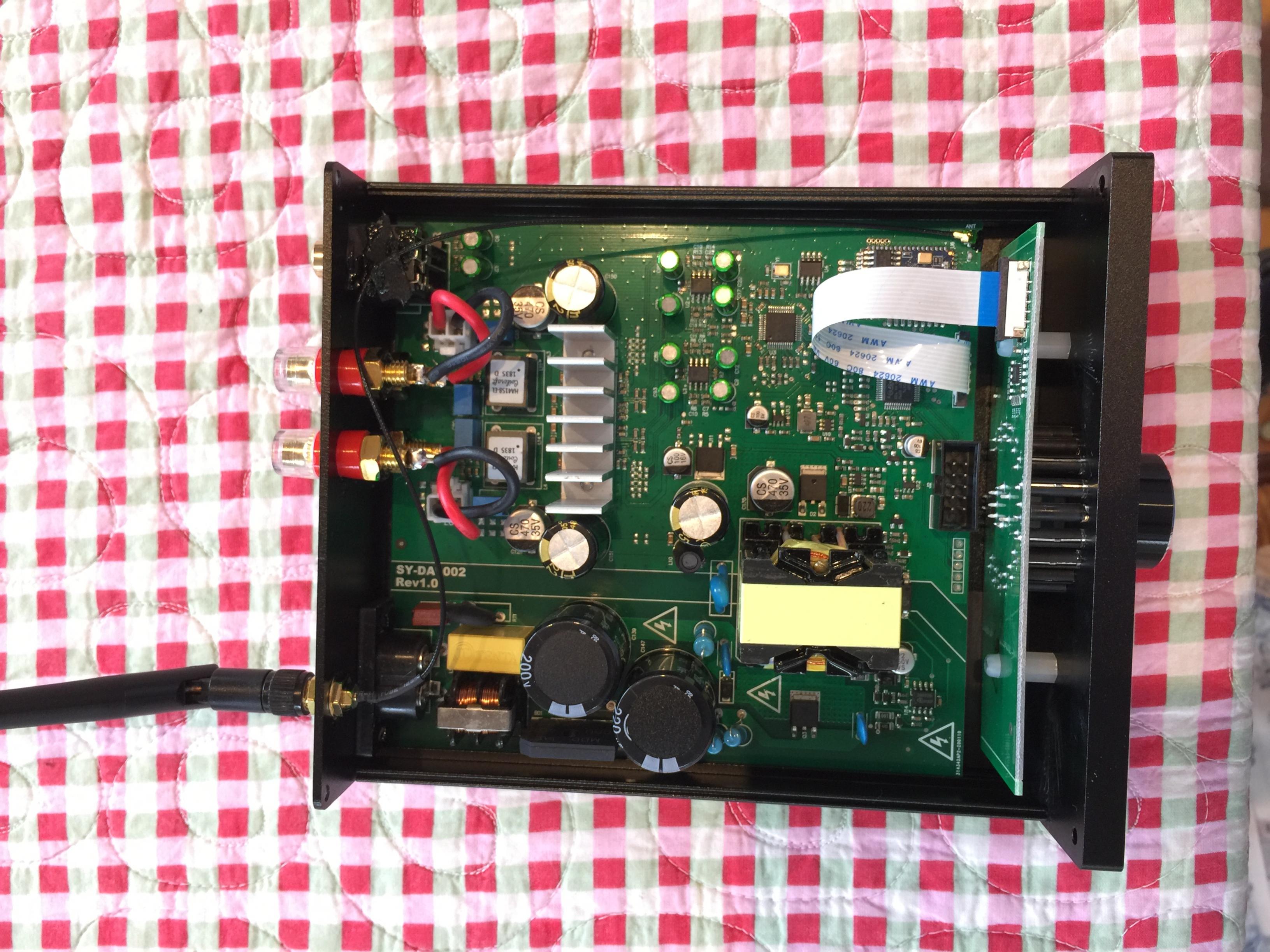

at your 3rd pic you see in the circle the pins of programming the µC (micro controller chip) beside. dont ask me why this amp need some (mybe the mute setting during power up/down). and i remember that forestsgump has trouble with pop off noise. no idea how to set up this µC.

Just received my 3e-Audio TPA3250 amplifier with Bluetooth as suggested by another person on here. 14 days to deliver to the UK from China.
Very Very pleased with this amplifier. The fact it includes the internal power supply is a major step forward from other similar Chinese TPA3251 and TPA3255 amplifiers - I have both the Aiyima 04 TPA3251 and Aiyima A07 TPA3255 amplifiers and they are both good.
Actually prefer the TPA3251 as the lower operating voltages allow bigger Caps in the Power supply - three times the capacity.
Only started to play with this new model today so time will tell but early impressions are very positive. It is absolutely silent, whereas all the other amps I have tend to emit a small amount of noise with no signal. The Bluetooth module does not appear to affect the main amplifier - No noise from this source. The design seems solid - No Power On clicks !
Very nice not to have external brick of a power supply and only slightly larger - In fact I prefer its size to the many Micro Amps that come out of China.

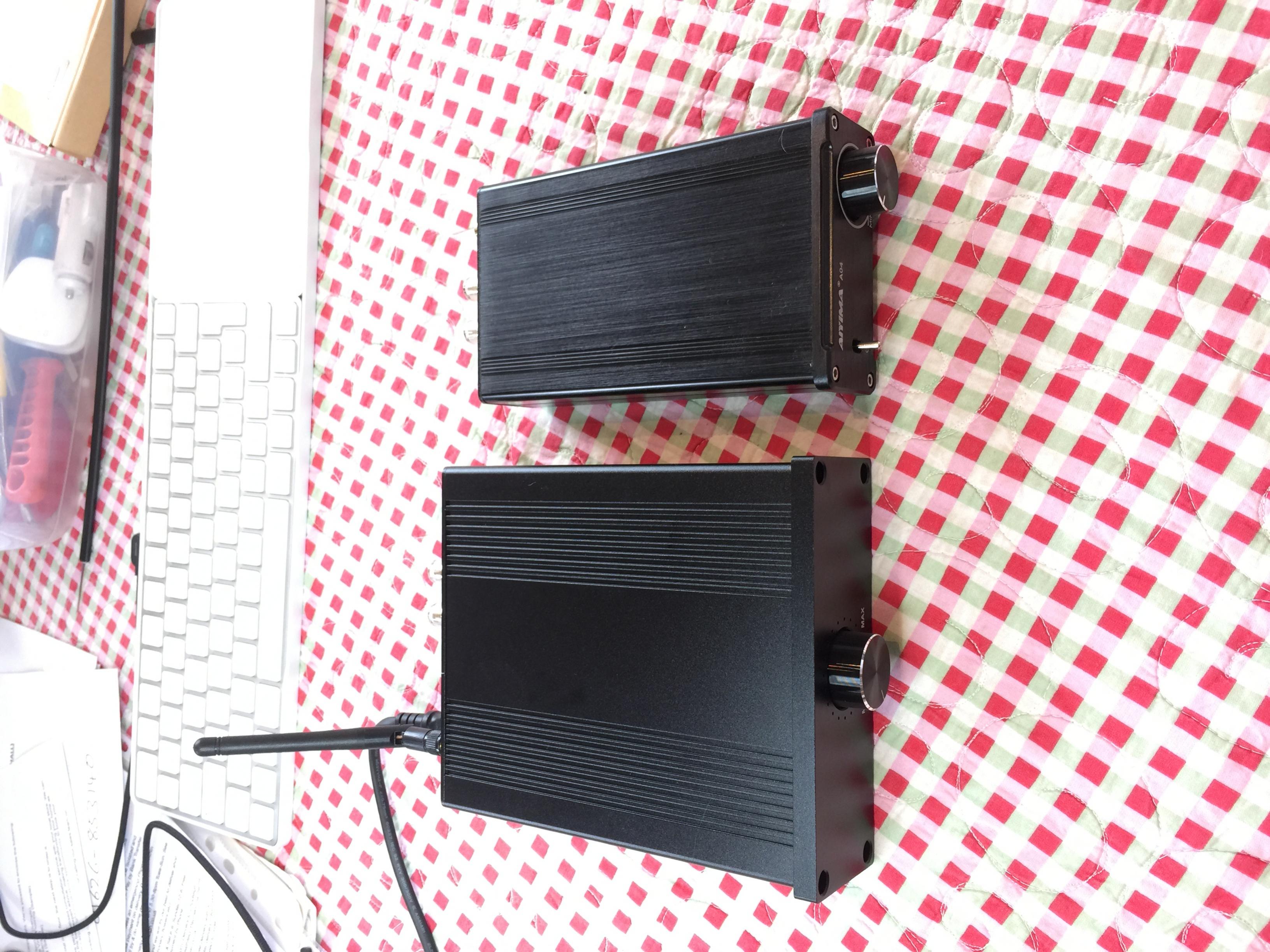

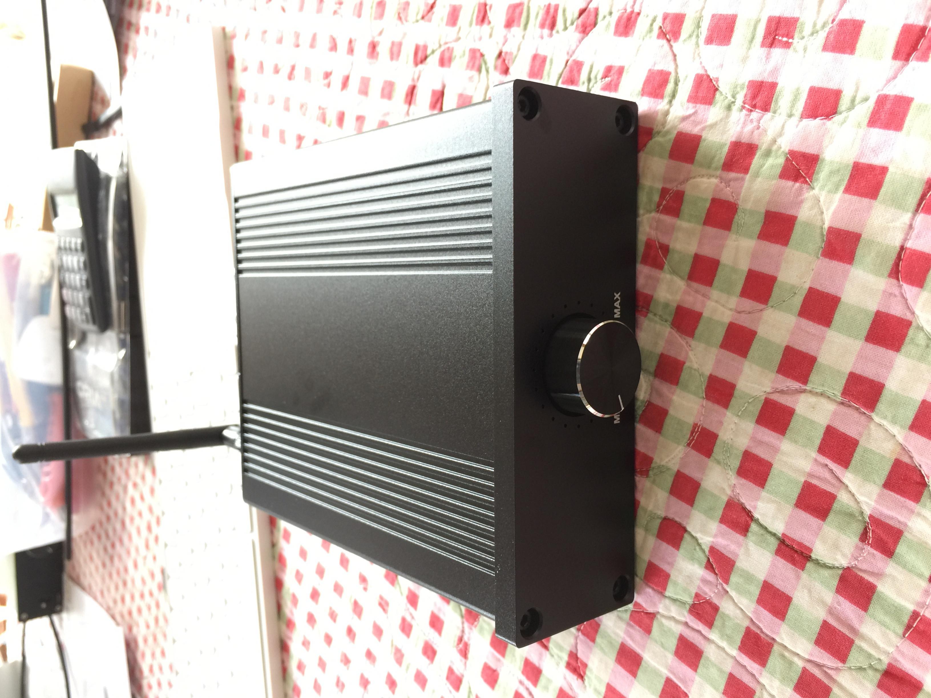

Just received one of these today - Very impressive. Nicely built and sounds good out of the Box.
Have attached some photos and comparison with Aiyima A04 TPA3251 amplifier.
I think the integrated amplifier from 3e-Audio will be much easier to live with as no external Power Supply brick to find space for !!!
