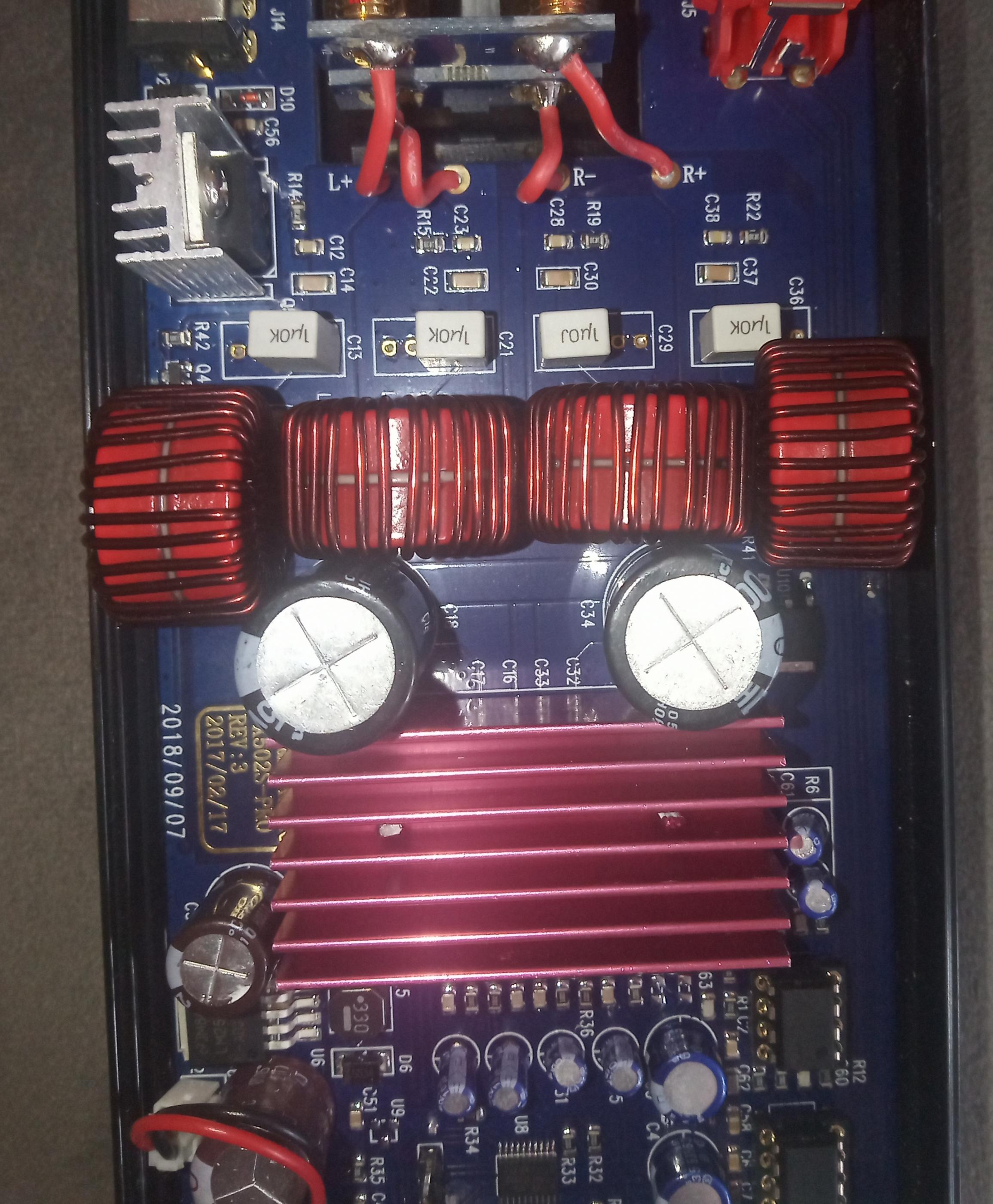

Those are 13mm Diameter only
Done by Chris, in his amp!
pulse width modulation (PWM)) air coils they work, but not luchschim way
for air coils, the washout is too small to exclude mutual influence, current protection is triggered
limits the ability to use a 32-volt psu. Maximum current output and the decline in the bass

Hi saran
ok.
use a tool with small and sharp/hard edge - like a a small screw driver and scratch it carefully away. normally the glue around the coils is not too sticky. so after de-solder push a little bit with your fingers and its gone. on the pcb there is a isolated cover....no problem to do so.
chris
Hi saran
ok.
chris
Thanks Chris for guidance.
Mouser order placed yesterday, Inductor coil order in aliexpress placed today.
Inductor may be very long to deliver. lets see.
will update here, when there are any changes to the amp.
