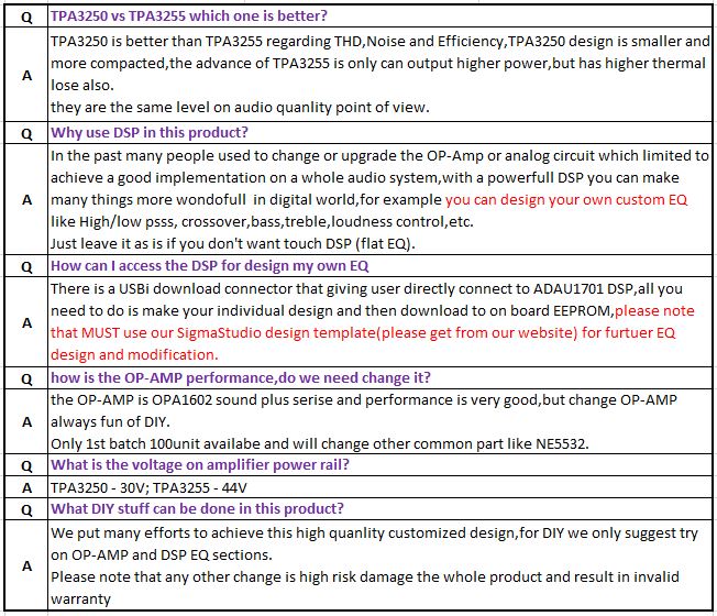

Hey that AliExpress link says that it's got DSP that can be set by the user. Does it have any mention of how to do that?
There is a USBi port inside the amplifier where you can plug an interface board between the DSP and a PC. Here is some of the Q&A questions which include details of using the Sigma Studio Design tools for modifying the EQ settings.
Probably not something for beginners at this stage but it would be perfectly possible to package this so it is a little easier. There will no doubt be some groups specifically covering this aspect of the amplifier.
3e-Audio will be releasing a manual covering the programming of the DSP in the next couple of weeks on their website. They will also be releasing a USBi interface board.

Just received my 3e-Audio TPA3250 amplifier with Bluetooth as suggested by another person on here. 14 days to deliver to the UK from China.
Very Very pleased with this amplifier. The fact it includes the internal power supply is a major step forward from other similar Chinese TPA3251 and TPA3255 amplifiers - I have both the Aiyima 04 TPA3251 and Aiyima A07 TPA3255 amplifiers and they are both good.
Actually prefer the TPA3251 as the lower operating voltages allow bigger Caps in the Power supply - three times the capacity.
Only started to play with this new model today so time will tell but early impressions are very positive. It is absolutely silent, whereas all the other amps I have tend to emit a small amount of noise with no signal. The Bluetooth module does not appear to affect the main amplifier - No noise from this source. The design seems solid - No Power On clicks !
Very nice not to have external brick of a power supply and only slightly larger - In fact I prefer its size to the many Micro Amps that come out of China.
