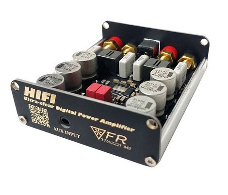

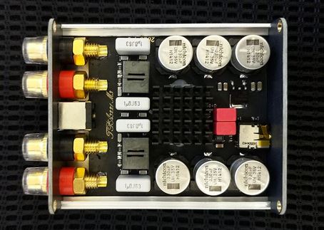

I just found this new TPA3221 amp.. It looks similar to TPA3250 but no UltraHD only HD.
Components looks to be better quality than most others.
Price is also really good.
TPA3221HIFI Verstarker Audio Board 100W * 2 Klasse D streo Digitale Endstufen uber TPA3116 T1444|Verstarker| - AliExpress
Only less than 36$.
What do you think about?

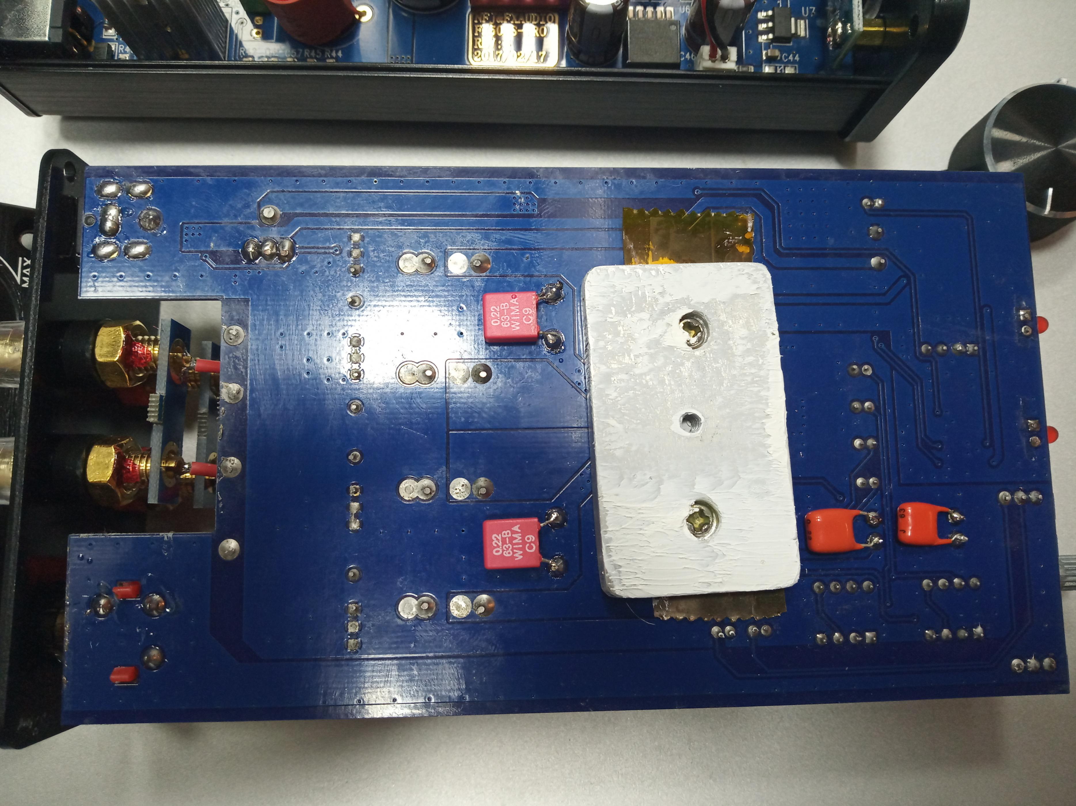

Received my FX502S Pro amp yesterday. Arrived in Just 7 days.
Got a different 24V-4A adapter bundled.
Connected with my retired old Denon satellite speakers from SYS5.1 package, for testing purposes.
The intended speakers (Pro Acoustics Junior F series towers)for this amp, i haven't yet collected from the selling guy.
Used my old mobile as song source. (Have regional songs in 320Kbps MP3, and MJ BAD Flac)
Through these speakers, can't define any clear SQ as of now, below are the observations made.
0. Using 24V-4A power brick as PS, Amp is still sealed, no mods done.
1. Amp power ON- Ok
2. Both Channels working-OK
3. NO hiss sound until full volume (without playing any songs).
4. For 1-2 minutes tried playing full volume, no error LED.
5. When I switch off the amp power button first all fine. But when i switch OFF the wall socket directly, have loud POP sound along with ERROR LED after 1-2 seconds from speakers.
After reading through the thread, i can't find any definitive solution for POP. even forestsgump used 32V power brick , to get POP.
Is the OFF-POP, normal, even with 24V-4A PS? anyway to eliminate?

Hi Saran
Please measure with DMM the real voltage at the output of the regulator LM317 because some Chinese resistors are labeled wrong. so your calculation is correct but the values are not real. remember the regulator works correctly if the input voltage is about 3V more then the calculated output voltage. otherwise the regulator is not working.
caps. the big 1800µF cap fine i used it and compared with other one. mine are original and good. a small cap (100nF-220nF foil )under the pcb in parallel to the big one is for additionally decoupling- other caps like a 10µF electrolytic are too big or can touch the housing- don do that!
pop off
please always switch the amp off - then switch the power plug off or pull out the wall socket connector. Why? if you switch off the wall socket first the stored energy in the caps are holding as long as possible the energy high until the power chips get loss of energy -----> this "generates" this pop off at the speakers output because the power chip is not hold in mute state.
