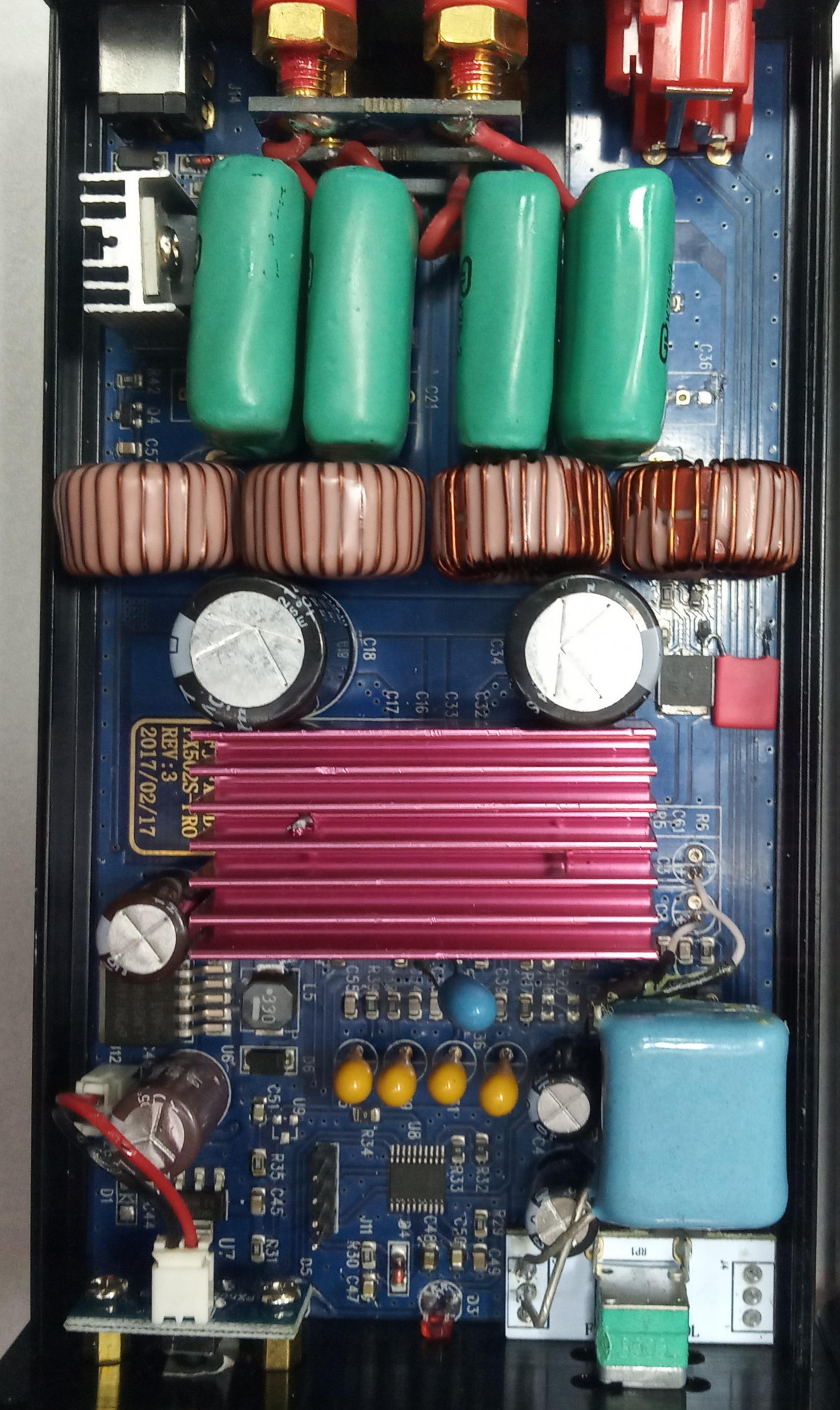

Hello,
Today I recieved my FX502PRO. As expected, it sounded far too bright as standard, with a recessed and somwhat muddy midrange. I bought some LME49720NA op-amps from a reputable source and quickly replaced the "NE5532" op-amps. The replacement was very easy using tweezers to pull the old op-amps out and slot the new ones in. The amp now sounds much better! Much less sibilant and the midrange has been brought forward. I think it's still a tad bright at times, but it is certainly far better than standard.
Here is what mine looks like - V5 board:
I did notice it seems to get warmer now with the op-amps changed. Anything to worry about?

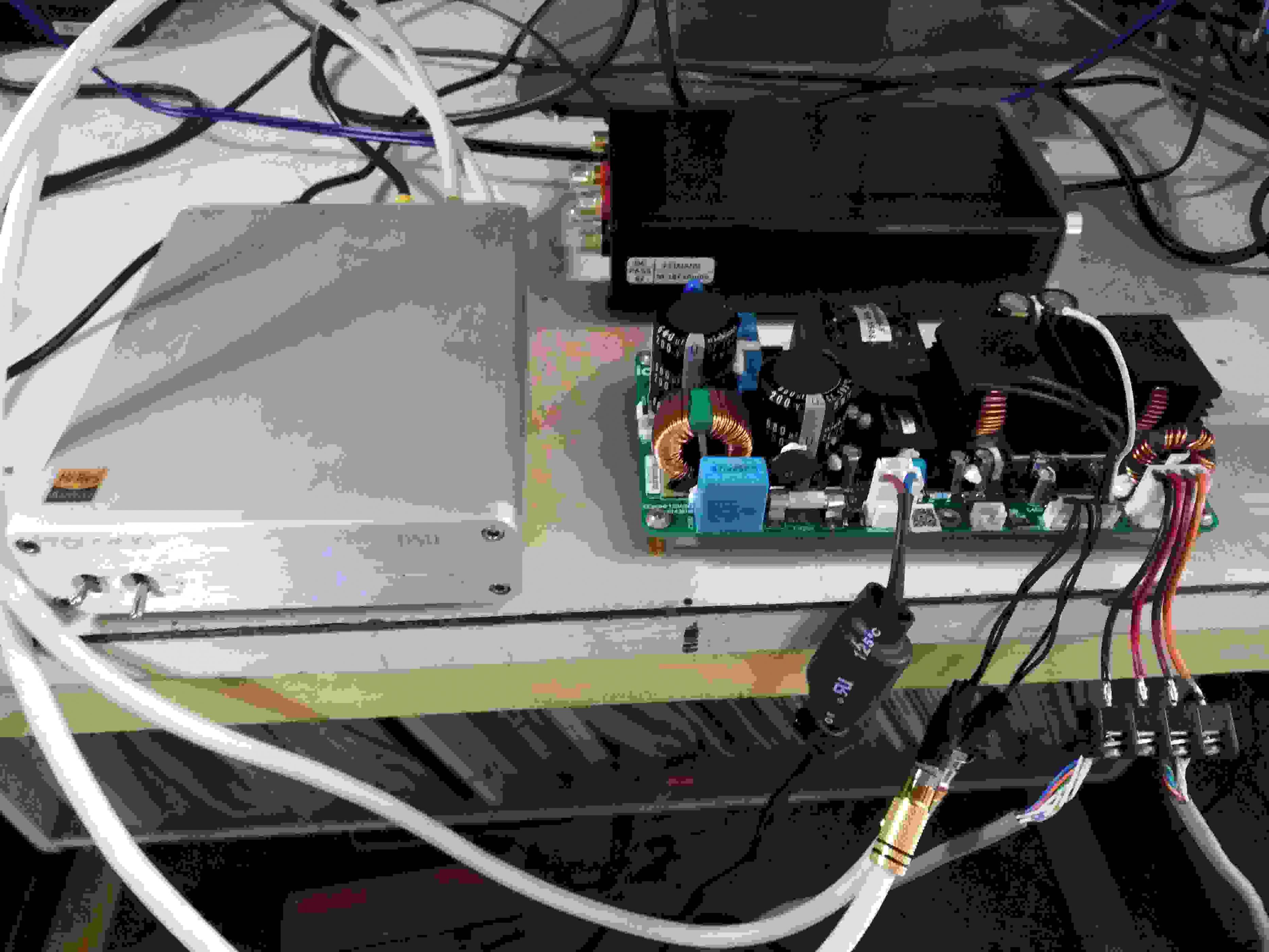

However Icepower 50ASX2 (SE version) should sound much better. If you are DIY kind, it is a better option. You will pay the same as for FX with a quality PSU, as Icepower has PSU built-in. Add couple bucks more for a case. It doesn't have volume control and it must be driven directly from a DAC or a pre-amp with low impedance (no pots between). I have both FX-502S Pro and 125ASX2 and Icepower outperforms FX by a big margin. More clean and analytical, no coloration. 50ASX2 should sound very similar.

I'd like to add, putting the Icepower module in a box do not require any specials electronic skills, even a soldering skills - crimping tool is needed instead, it may be problematic. Here is on my desk, FX behind:

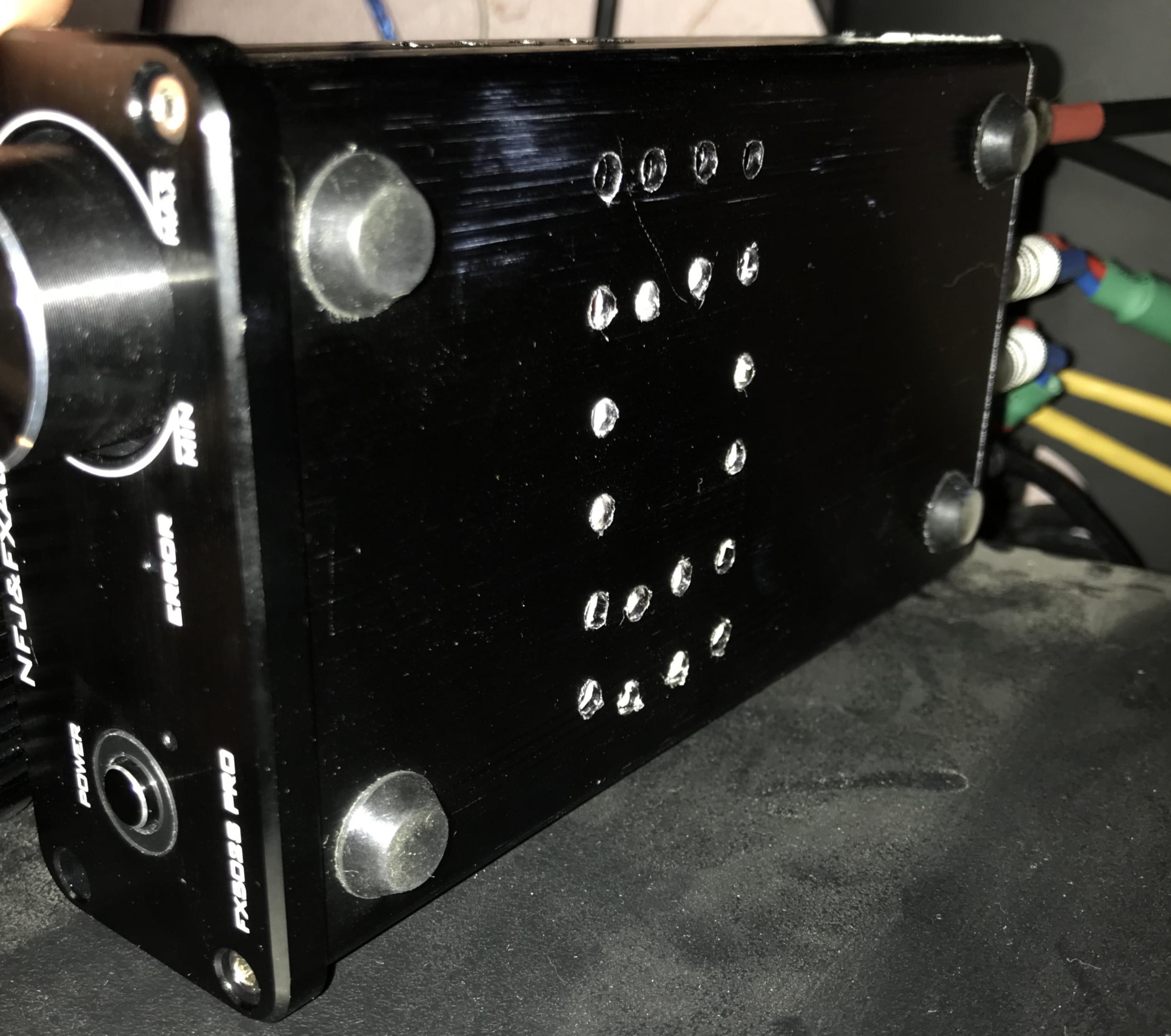

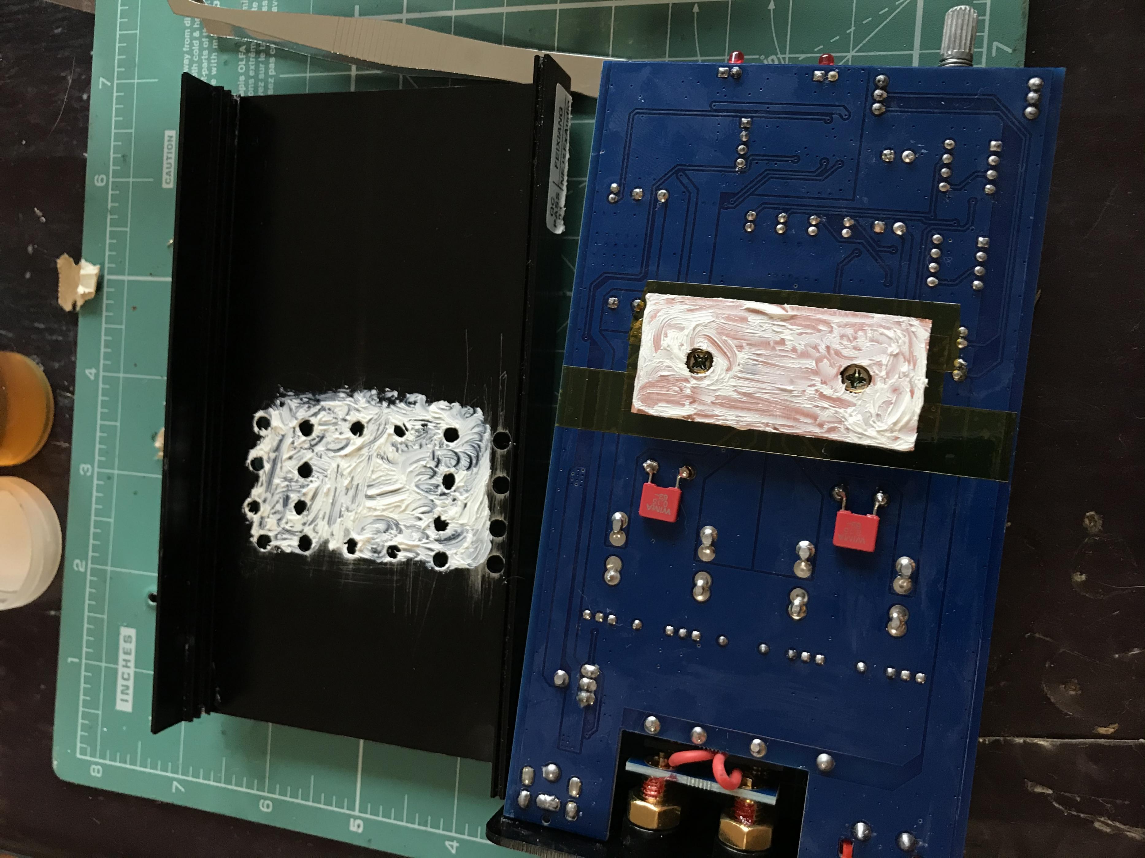

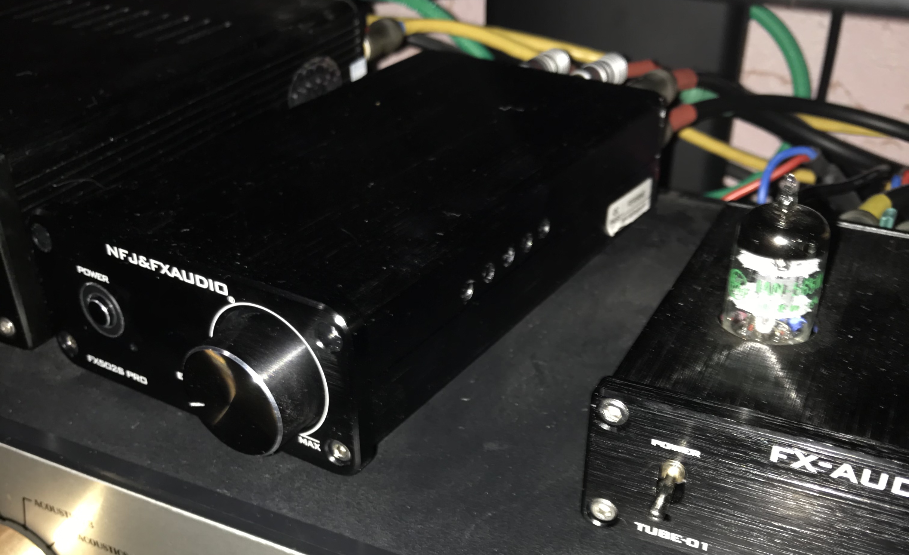

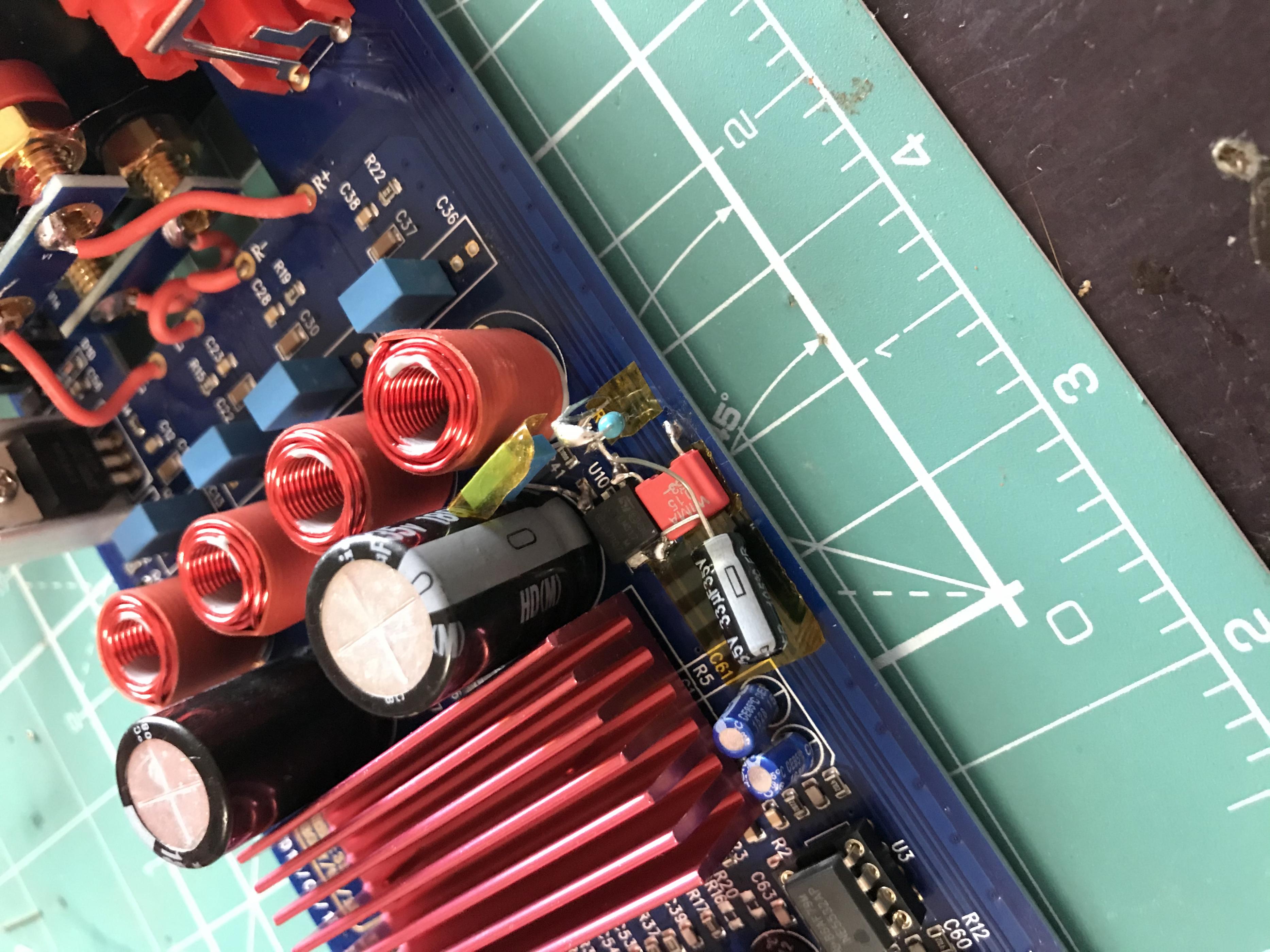

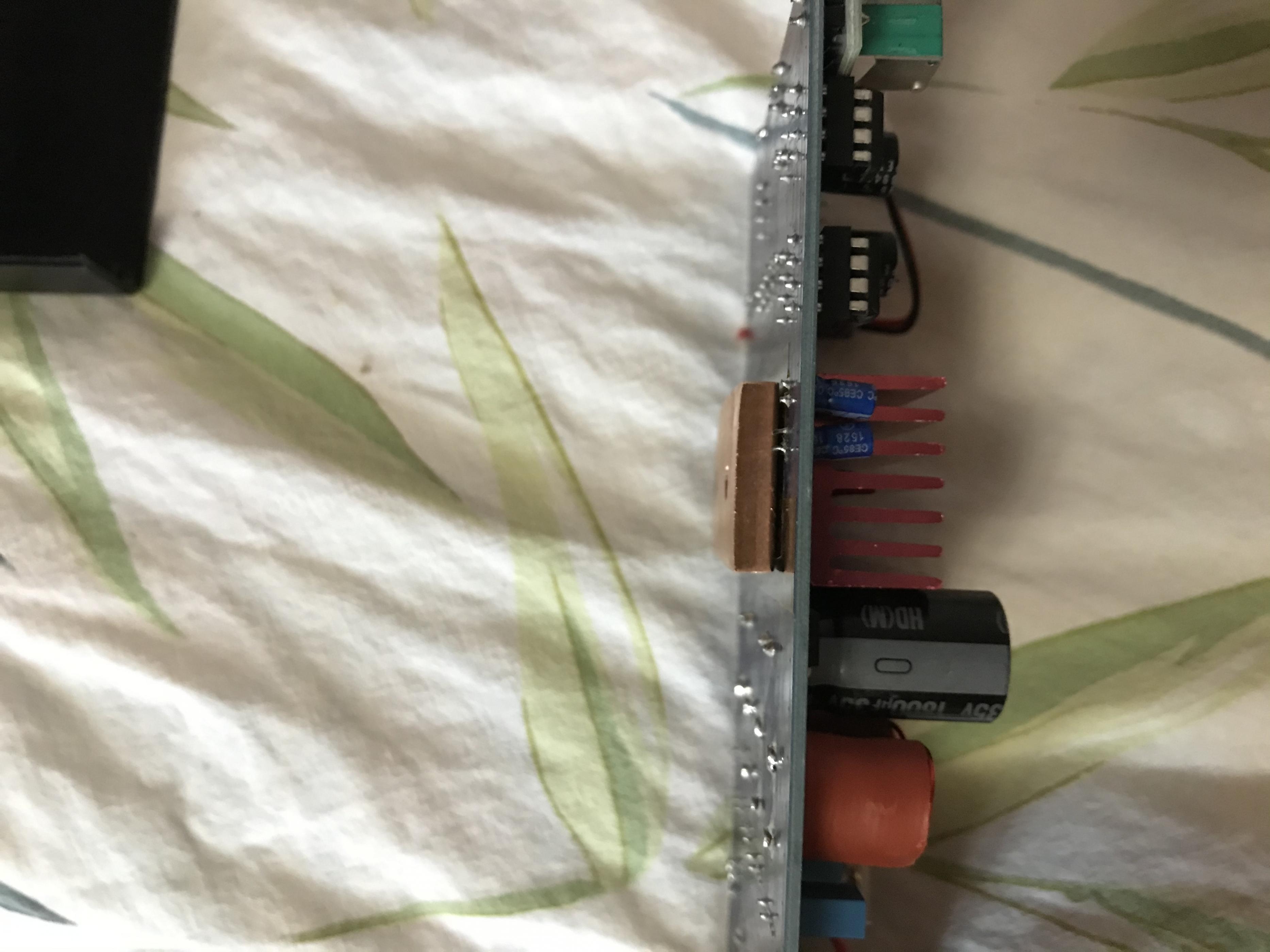

After reading this forum I did the upgrade. Copper radiator was installed. Change resistor R40 to 3.6k and capacitors near LM317.
After this change I measured output voltage from LM317 and it equal 16.4v. And I take attention that R41 is 300 Ohm! This is mean that factory change R41 from 240Ohm to 300Ohm. Should I go back to 4.3k R40 or 16V is normal?
P.S. Also I made additional holes for cooling.

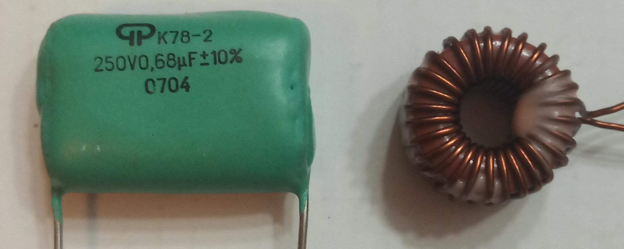

Hi demonmsk
the point of modifying the LM317 switching circuit is that the voltage must be more than 3v and the Cadj is installed.
evaluate the modification of the LC filter. 2 toroids T68 - 2 0.035 Ohm
