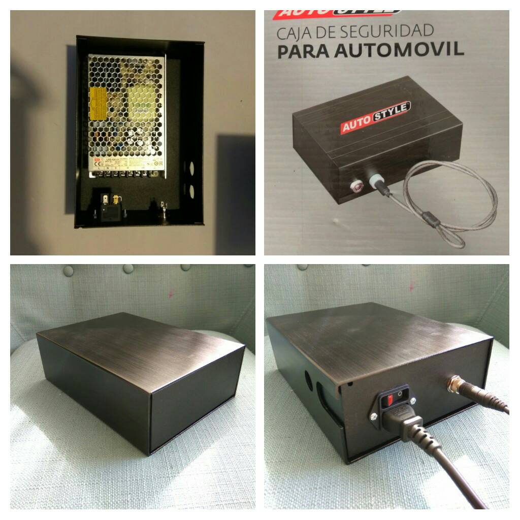

Hi
the Earth connection is done - additionally on case + correct the switch indicator lamp if its power on.
my son (10) helped me once again to build this...
I couldn't found a fair price case and ended up buying a 10 usd small car safe for the Mean Well P. S. [emoji2944]
It's bulky, but works well. I'm still waiting for the FX-Audio though 20190309_174533-COLLAGE.jpeg
I don't have that PSU (yet), but I see that the B1304 case (commonly available on eBay/Aliexpress) should be just big enough to fit, but ONLY if you hard-wire the power cord. If you search hard, you can find them for under $15 shipped, So a bit more expensive, and won't fit an IEC socket, but nicely finished and compact...
LRS-150-24 dimensions: 159*97*30mm (per datasheet)
B1304 internal dimensions: 160*120*35mm (measured)
I have the enclosure that I got as a spare for another project. Now I just need to get the LRS-150 :)
UPDATE: Actually, I just measured a clip-in IEC socket, and if you're VERY carefull, and orient it vertically, you might be able to fit in the case it alongside the PSU. But then your 24V socket would have to be mounted directly above the supply's screw terminals. Tight. Very tight. :darkside:
The chassis is connected to earth through the power supply body, I checked continuity with the DMM and it is working fine, but I didn't put a redundant earth safety wire [emoji87]
It looks like the volume of that case on Aliexpress is in the threshold of cheap shipping, because I couldn't find something bigger for a fair price

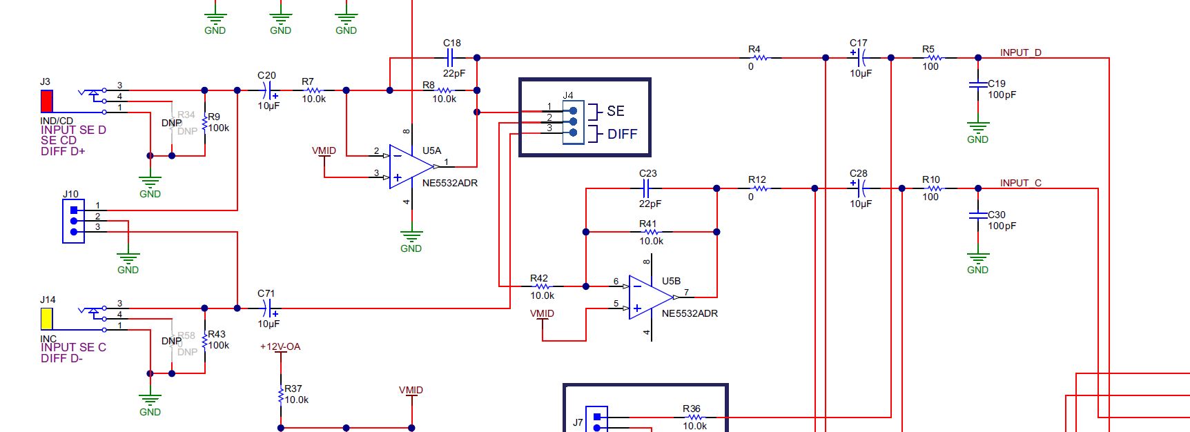

Has anybody been advantageous enough to bypass those crappy OpAmps and feed the chip directly with a balanced signal?
I have done that with all my gear that came with OpAmps and the sound quality always improved.
For domestic listening levels the TDA chips can easily do without any pre amplification.
At the moment I am transformer coupling my DSC1 balanced into the TDP3116 and the result is
absolutely fantastic.
I, too, have been going to do this for a long time. But not yet done.
Hi
i am not an expert so please wait until one confirm this:;)
in the implementation of fx502Spro it will not be easy because the board is not build for the differential/balanced input.
as you can read a the datasheet of the TPA3250EVM board you see 4 different input jacks...i show you in the pic attached what i mean.--> so this is the way it should be (jumpers set to diff) to feed the TPAchip with 1 channel differential-balanced.

is the idea of feeding the amp a balanced signal to avoid deficiencies in the DAC or in the amp?
My understanding was that balanced is used to avoid noise in situation with for example long cable runs-- is there some further benefit to it other than this? Even if you are avoiding OPAMP by running balanced, you introduce (expensive) transformers in their place (unless you have a DAC with balanced output).

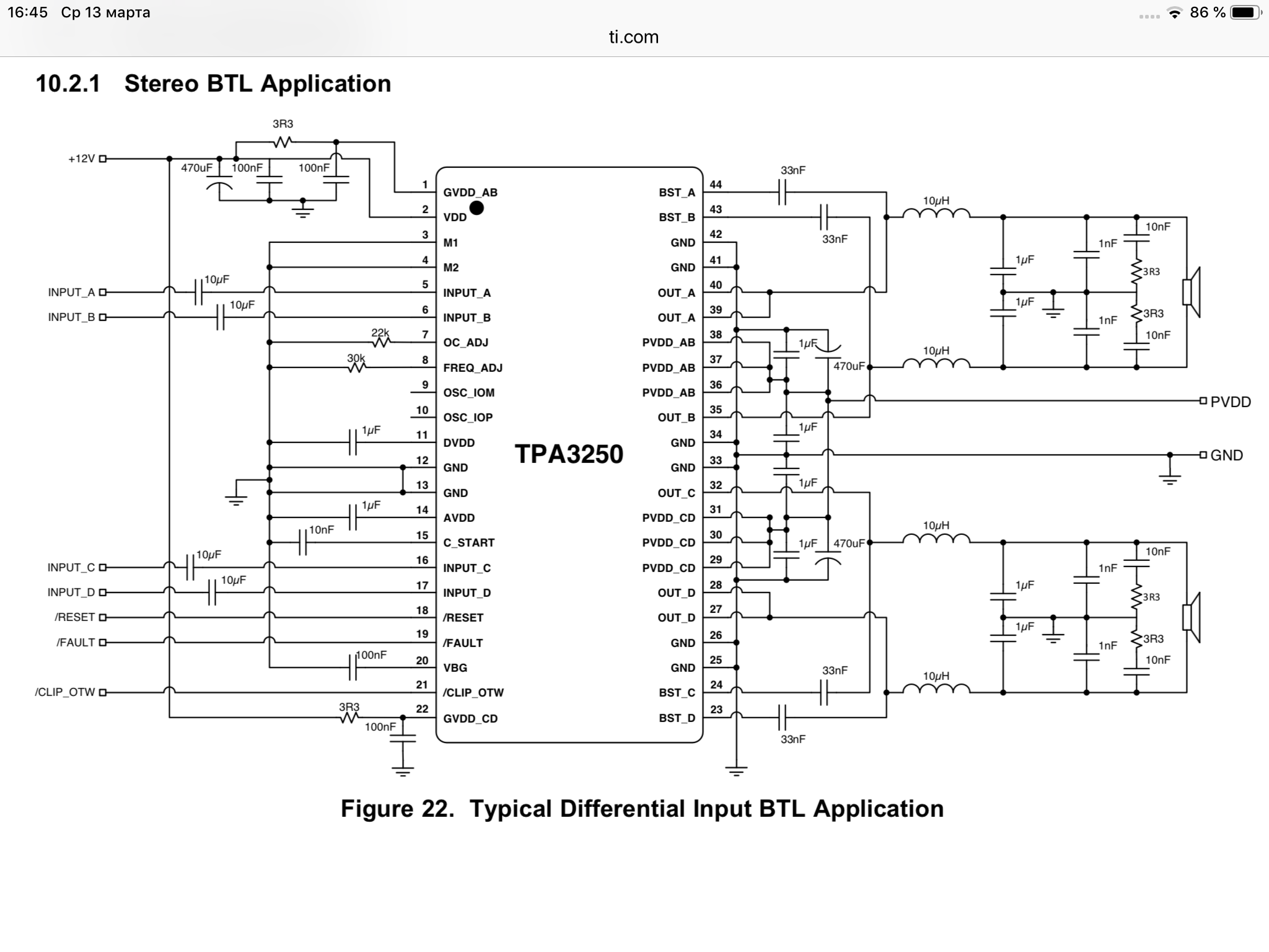

Datashit suggests connecting a balanced signal directly through capacitors. Capacitors are not needed unless there is a constant input voltage.
