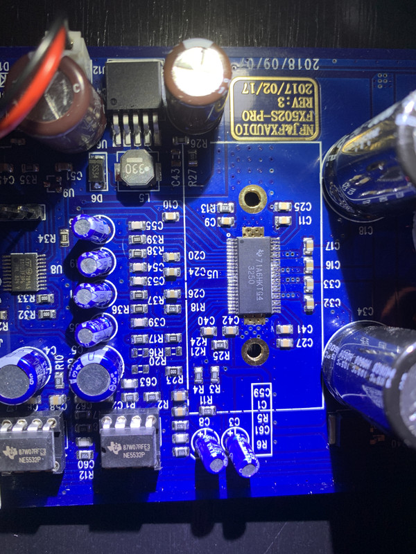

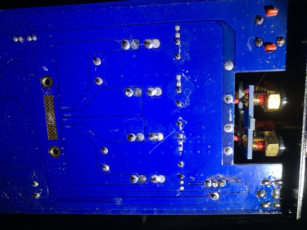

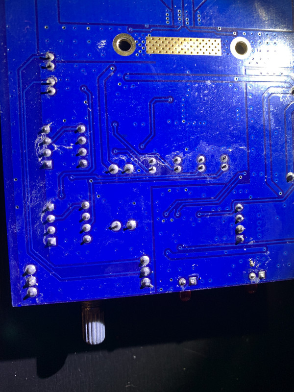

I had to prepare the orders for the parts so opened the amp... pfff what a dissapointment, as nice it is from outside so ugly it is from inside 😀 I am surprised it didn't blow up, check the images and the solder work on the PCB, never seen such a awful soldering, there are probably no shorts just thanks to soldering mask, so this was a ticking bomb of some sort...

The usual thing for Chinese noname manufacturer. For some reason, more well-known Chinese manufacturers as SMSL or Topping do not make amplifiers with this chip.

I would not say poor quality is related to this chip.Wiliks

I meant of course not about the chip. Now there is no choice, only this noname manufacturer made an TPA3250 amplifier. I think that SMSL or Topping or other well-known manufacturers would make a better quality board and amplifier at all. But for unknown reason other manufacturers did not make amplifiers with TPA3250

Yes some reflow solder dots are looking as "cold" solder points....its looks too dull
....resolder it again.
the hand made solder dots looking more shiny but they are not cleaned --> pcb cleaner or slightly scratch away...
