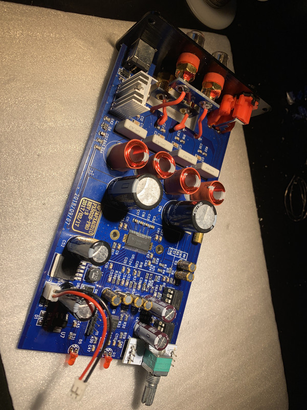

In a meantime, I managed to change my opamps for LM4562 and also all the caps for low ESR Panasonic and Nichicon with greatest possible capacity to fit the size. Also changed output foil caps for best low esr ones that could fit the size, and on all signal paths I have used Nichicon audio gold caps, hope it will help 🙂
I also changed the 30k oscillator set-up resistor, for 10k and increased switching frequency of the TPA from 450k to 600kHz. So far no listening tests just measuring it, as I have not improved my cooling yet. (still waiting for the block of aluminium to come)
It definitely produces some heat now thanks to higher frequency, but hard to tell how it will be with all the cooling mods and better PSU, as still dont have all the parts... But on low signal levels the higher switching frequency at least visually looks a lot smoother than the 450k... see the attached measurement what the residual switching poise looks like. Also on 1kHz sine wave it looked more noised before (on 450k) now the noise is so "thin and dense" its harder visible and so have a better feeling that it makes sinewave smoother on low signal levels 🙄

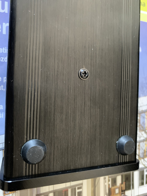

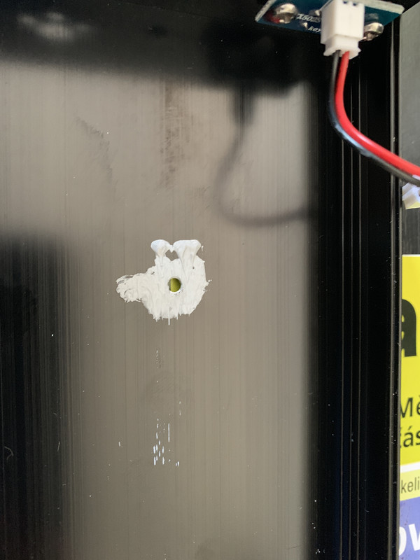

Finally i finished tuning of the amp! The cooling is from below by 5mm thick aluminium piece, I used arctic cooling mx4 thermal compound that even got into the vias below tpa chip, to avoid any shorts to surrounding pcb vias i used kapton insulation film below the aluminium brick and another tape for surrounding paths just to be sure its insulated properly. This tpa chip is indeed cooled from below as the purple heatsink is now barely warm 😎 here is how it looks like:
