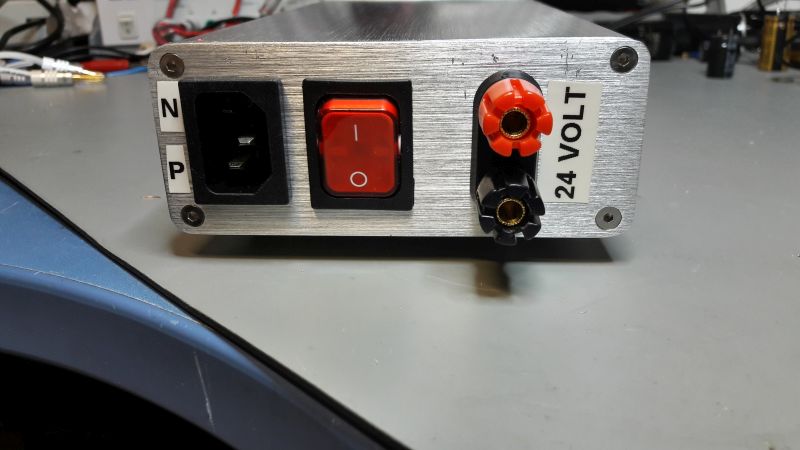

cheers again, I received my amp today, finally! and what a beautiful and small amp it is! It plays very well right out of the box and I was surprised by its power despite of size :-o
looking forward for my modifications, lets the tuning begin!
Just started with simple listening tests and measurements and it did 2x30W@8R with default 24V PSU with no mods so far, very nice! Still waiting to receive my 32V power supply so I am very curious what the differences will be, after modding opamps, capacitors, cooling and power supply.
This is my first class D amp and it is unbelievable how low heat it produces :-o

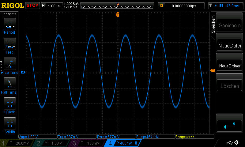

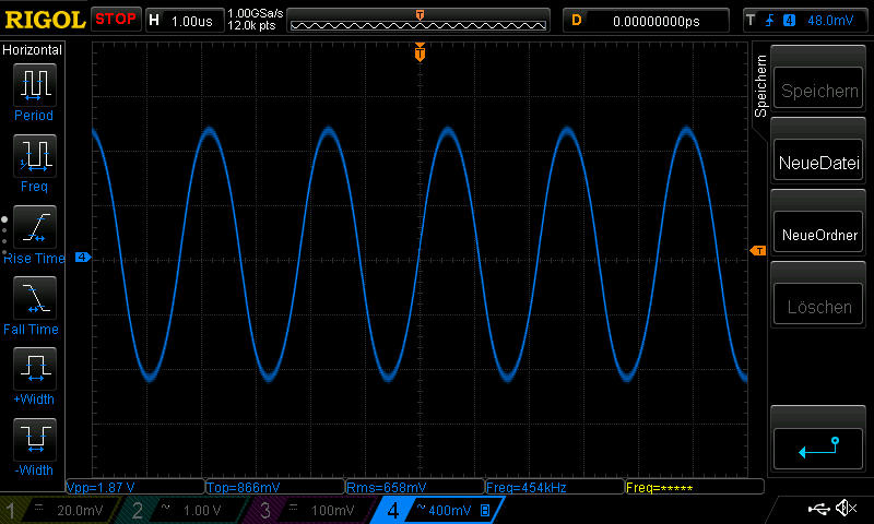

The audible noise-floor of the amp is very quiet indeed as was refered many times here, but after measuring it on scope it produces 200-300mV 450kHz inaudible noise, so not very good in that terms, but maybe this is the class D feature, or not proper output filter?

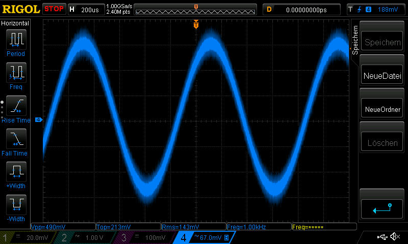

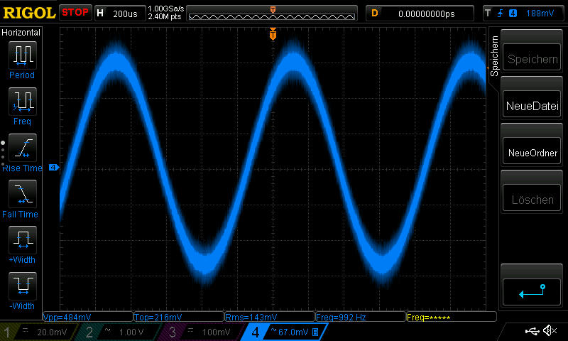

Hi

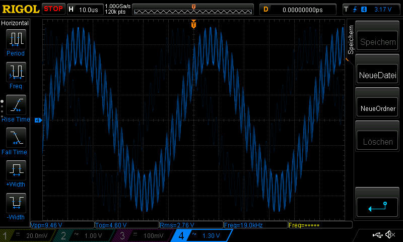

yesterday i did the first test with foil over the opamps. i do not ground it...is it necessary?
foil like this:
Anpro 15M Kapton Tape Klebeband Selbstklebend Kupferfolie, EMI Abschirmband Kupferfolie Kupferband 2.54cmx15m, EINWEG: Amazon.de: Baumarkt

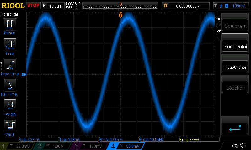

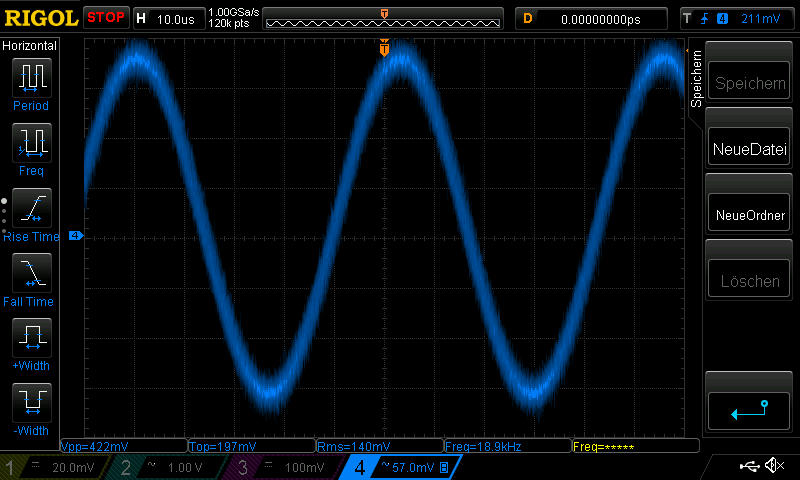

yesterday i pus 150mVrms into the amp, its runs with LRS10-24 set to 24V. on 8R i get about 1,5 Watt per channel with the 1 o clock volume setting.
3 minute i check with my temp tool the difference of the housing of both opamps = difference of temp of the opamp with/ without foil was 32°C and 38°C
so the opmap for R channel has the foil- opamp for L channel has no foil, scope at pin 4 and pin 1 -GND and outA
pic 1 with foil
pic 2 no foil
pic 3 speaker output R channel with no signal (opamp with foil)
pic 4 speaker output L channel with no signal (opamp without foil)

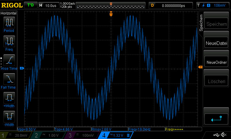

pic 5 19khz at R channel sp output
pic 6 19khz at L channel sp output
today i start o give the opamp L channel near the potentiometer a foil too.
the temp behavior is really the same = better both opamp give me with 150mVrms and the volume knob at 1 o´clock the same temperature...its about 32°C...ok thats fine
now the compare at the same opamp = L channel opamp pic yesterday and today
pic 1 without foil 19khz
pic 2 with foil 19khz
pic 3 without foil 19khz speaker output
pic 4 with foil 19khz speaker output
no really big findings...?

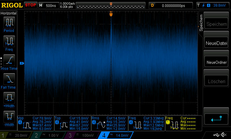

last foil test
same opamp measured the "noise" at is pin 4 - pin 8 - Supply pins, amp powered up- no signal in
pic 1 without foil
pic 2 with foil

I dont think these mods are worth it as the changes are negligible. If you want some more advanced and further tuning do a best cooling possible and raise the switching frequency of TPA... or change the surrounding capacitors for better ones etc...
