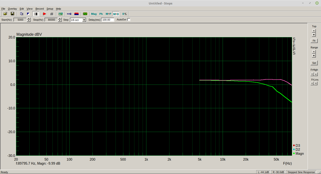

This frequency response drop at 20kHz is typical when measuring class-d-amp with LC output filter loaded by some low inductance dummy load. Loading output with some inductive load like a real speaker is a different story and may turn into a slight peak at the upper audio frequency corner.
Having said this frequency response measurements with dummy loads should be taken with a grain of salt😉

Of course, I do not mean an dis balance, but a fall after 10K on the chart.
I noticed improvements in sound quality after replace default (probably fake) opamps with LME49720NA. And sound really very good. But after reading that review I think may be to improve anything else 🙂.

voltwide Ok, I realized that with 8 Ohm speakers the frequency response should be flat enough. Need to tell to amirm to make changes to his measurements of class D amplifiers. There is rather an excess of high frequencies and he probably makes the wrong conclusions.

sorry at the post 735 at V5 board its not 1µF output filter cap...its 0,68µF
Knowing about this issue of pure pre-filter feedback class-d amps you can measure frequency-response both with low inductive dummy load and open circuit. This imho gives the worst case range of possible frequency responses under all different load conditions.
I did this with my personal TPA3118 ref design using STEPS & USB-soundcard producing this result with 10R load / open circuit, respectively. Sadly my NOS-ears do not honor this frequency response anymore.
Hi voltwide
low inductive i can follow but open circuit?
really without load?...or i miss something..
thx
chris
thx
chris
Without load is to see how the amp performs undamped. Some implementations tend to be unstable without load, pushing the magic smoke out of your output filter (caps and or snubber resistors) due to i.e. excessive peaking. An open-load safe amplifier is some kind "safety feature" in case of broken/unconnected wires/voicecoils.
