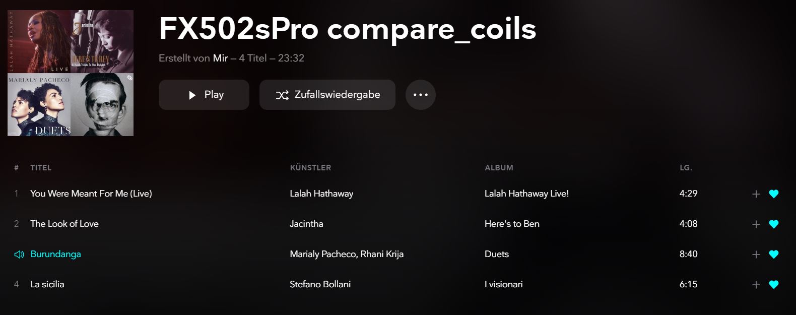

i did the 4th compare between the amp1 and amp2. as always i pick 4-5 titles of tidal (note the volume) and choose some music types and compare several times.
what i did not expect is that the bigger coils are sounding better. its more darkness and more dynamic and the middle of the sound stage is more details . the smaller coils seams more smoother and the interprets and instruments are near to the listener = not so deep sound stage.
especially at this title this amps sound great:
la sicilia - album I visionari - stefano bollani
Burundanga album duets - marialy pacheco
the look of love- album her´s the ben - Jacintha (did i wrote i like saxophones😉😎)
chris
chris
...here...listening example..

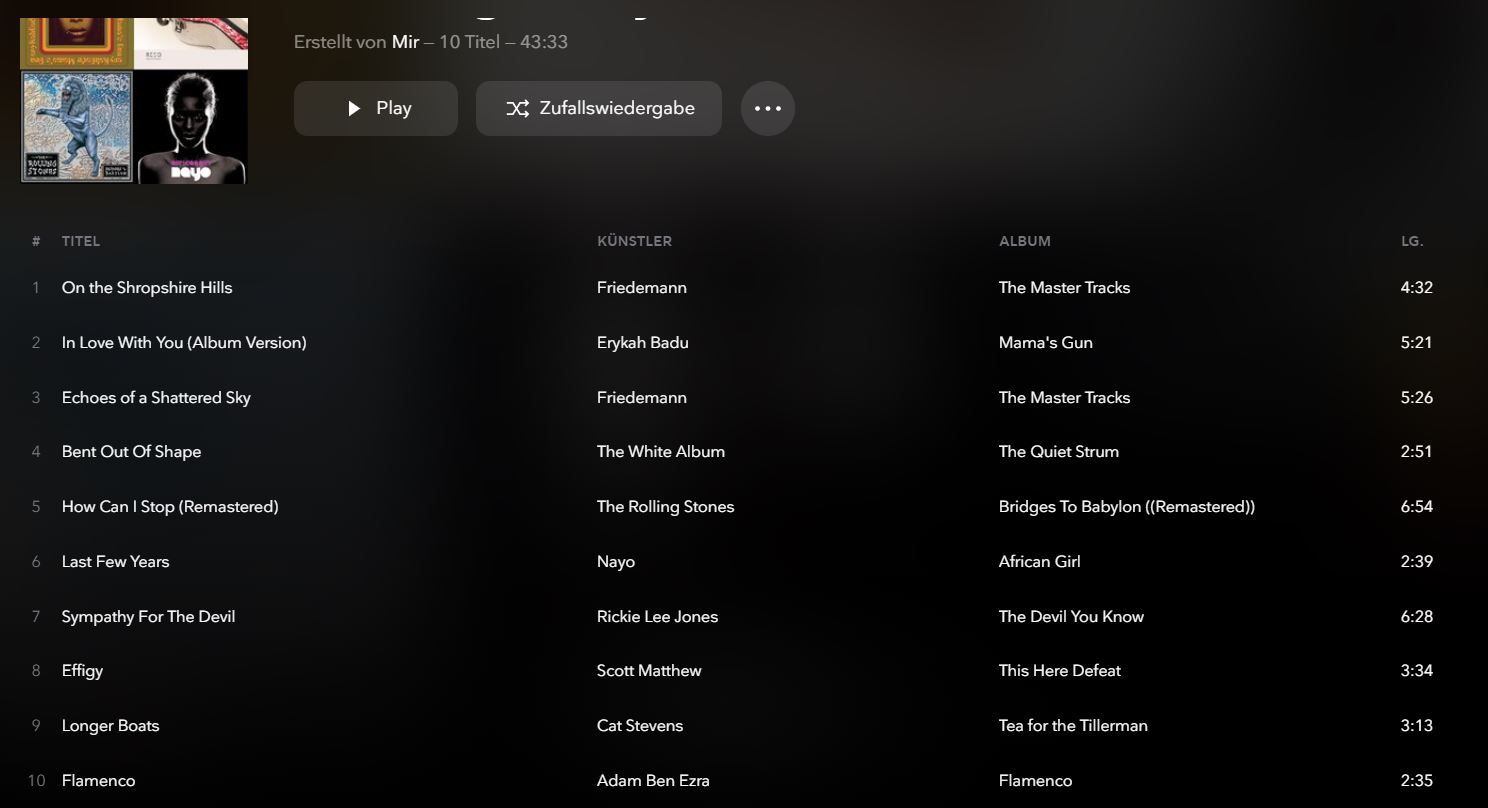

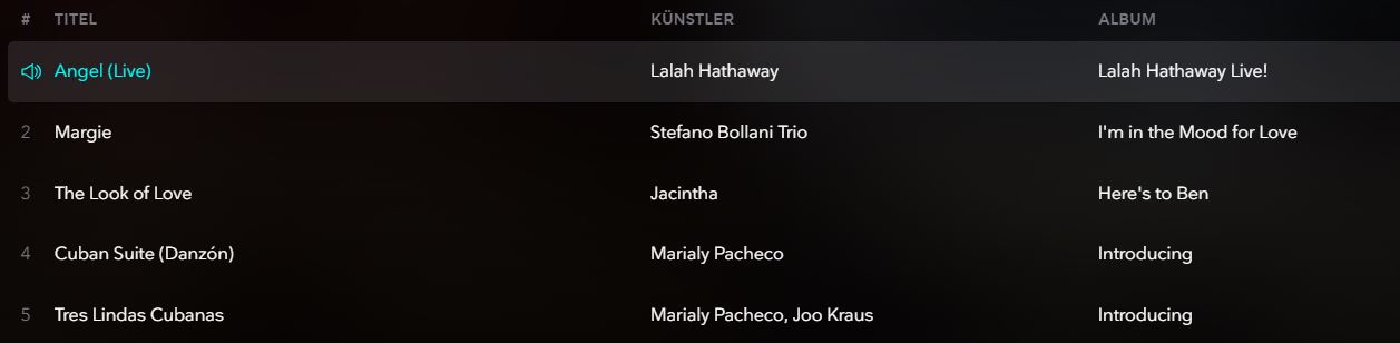

Sound check with different opamps
Good evening
After changing the the fat coils in both amps i did the SQ check for my DIL opamp i bought:
LM4562, LM49720, BB2134
at post 440 and 575 i did some compare tests.
https://www.diyaudio.com/forums/class-d/315681-tpa3250-listening-58.html#post5443600
the distance get closer but its the same as i have described. all opamps made the job better than the fake opamps which come with the fx502spro.
slightly difference:
4562 is my favorite , this amps is darker and give me all natural sound i like, deep stage and no real mistakes.
lm49720 is closed to the 4562 but is not so dynamic and dark.
BB2134 is not as bad as i described. he is very present in the middle of the speaker, analytic and is concentrating his force in the middle of the speakers...it feels like the sound comes through a big 3m magnifier glass, less sound from the back ground--> ideal for headphones
pic shows my listening examples
chris
