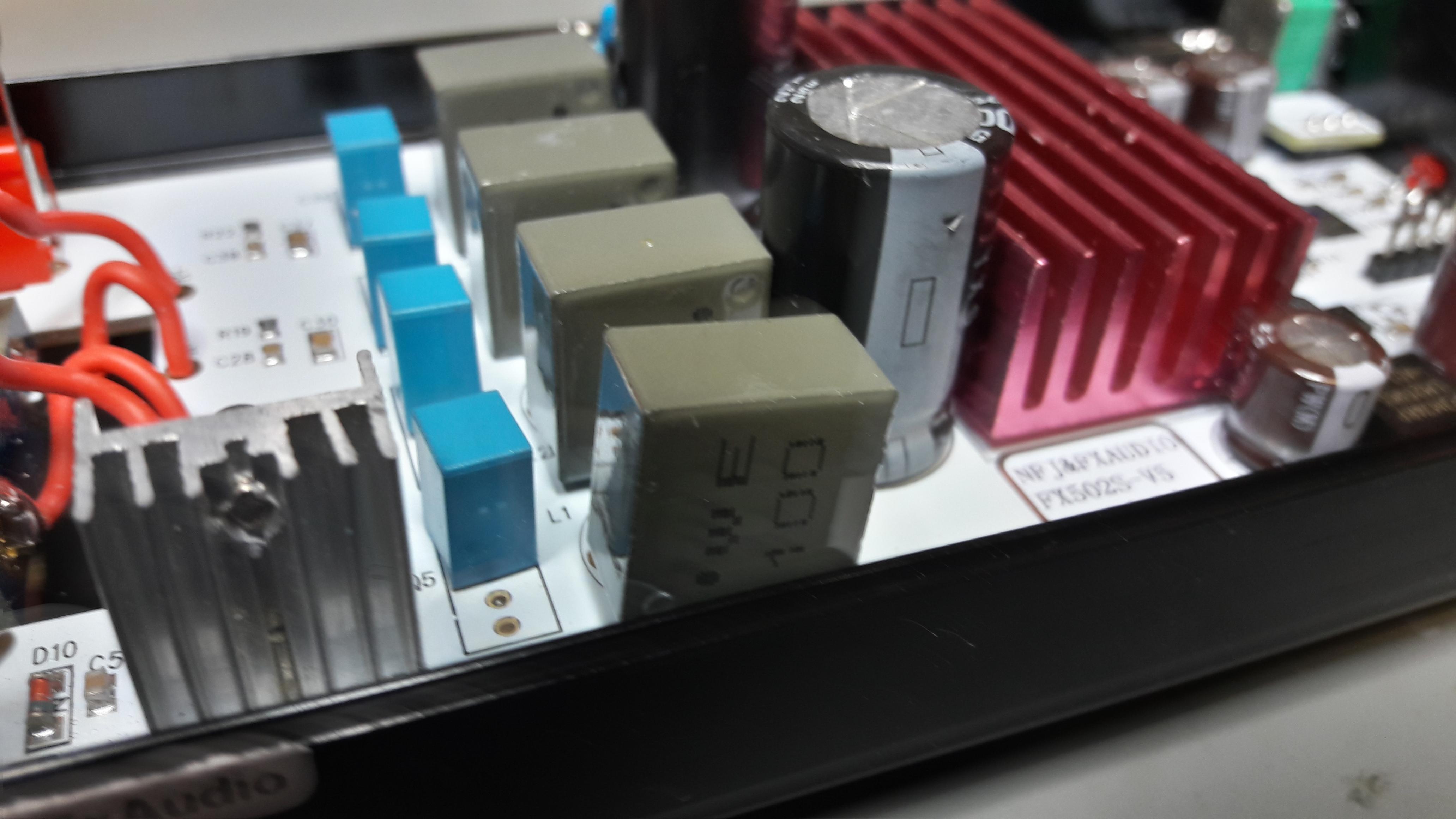

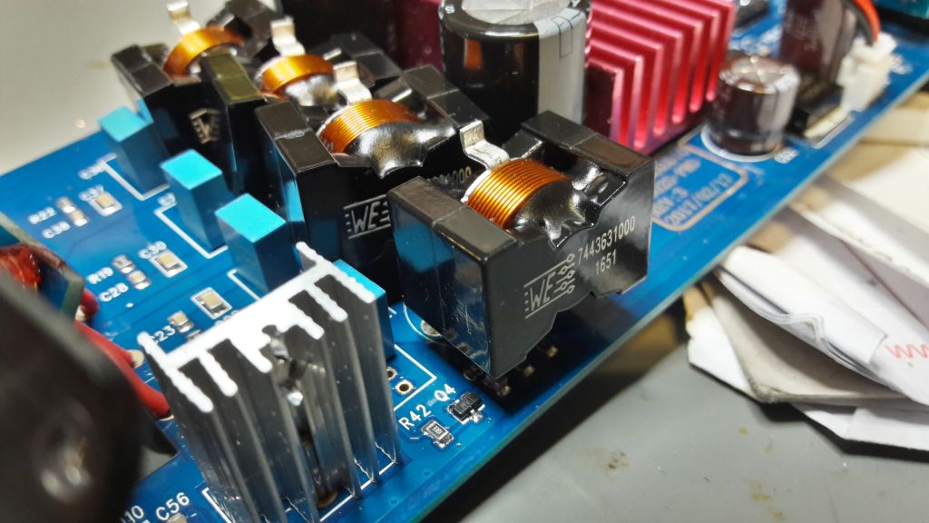

the output filter are original with air coils..i use the Würht 10µ (11,1µH measured) and the tdkfor 8R configuration
original was 0,82µ and in the second am 1µ
opamps are 4562 smps is changed to the LRS-150-24V.
in my configuration (LM317 is set to 24--> 20V)
the other smps is much better at SQ compared tot he original!

coils
74439370100
caps
0,680µF B32529C1684J000
.47µF
B32529C1474K000

These Würth inductors aren't that good for class-d as they are soft-saturation carbonyl iron powder compound cores. Last time I compared these type of inductors to ferrite ones we'd seen a lot of k2 distortion. This results in some sound coloration like triode tube amps do. They are pretty much like the Coilcraft XAL1510 series.
Yes, Inductance starts to change at about 3A.
https://katalog.we-online.de/pbs/datasheet/74439370100.pdf
Better choice:
(for the size)
https://katalog.we-online.de/pbs/datasheet/7447709100.pdf

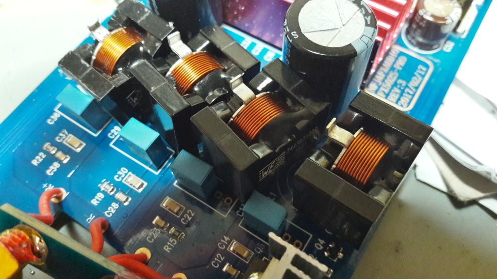

Thank you DUG for your hint....
so that mean at 3 Amps the saturation's starts:
its about P=I^2 *R = 3^2 *8 = 9+8= 72 Watt ...into 8 ohms
i think i can leave with...but the k2 is maybe not so nice....🙄
i have to think about another coil
doctor once tested these....7443631000...much bigger...but...

Look at peak current.
7443631000 here
https://katalog.we-online.de/pbs/datasheet/7443631000.pdf
AAhh....
if i compare these 2 diagrams then i can recognize what you want to say me 😀
thx

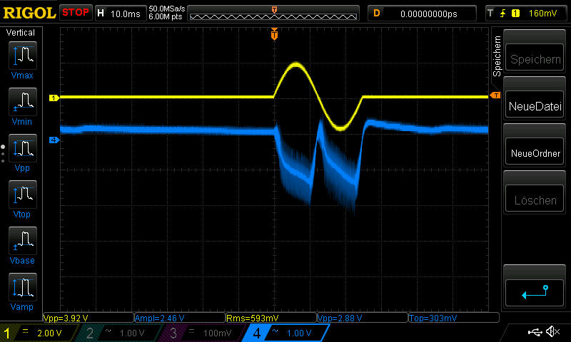

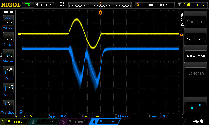

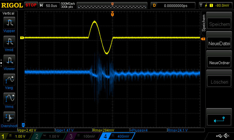

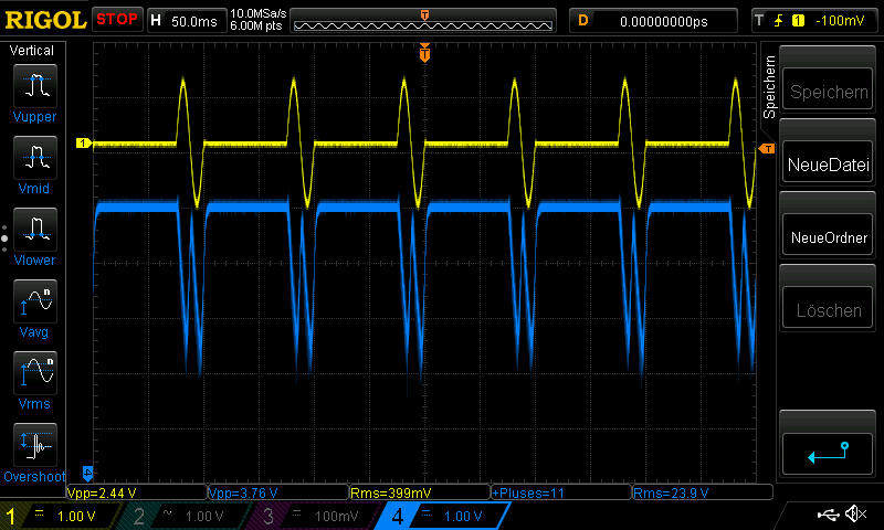

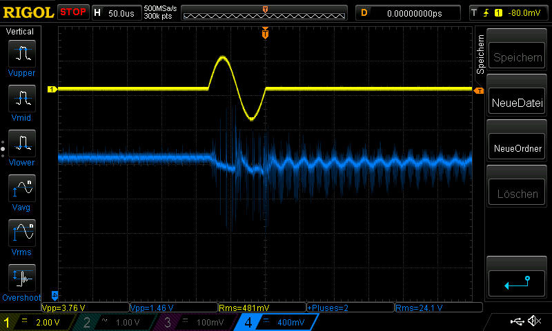

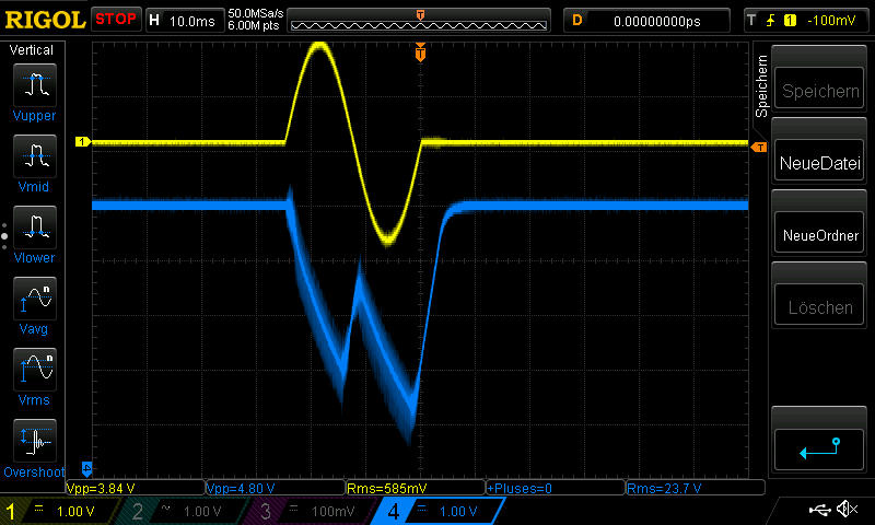

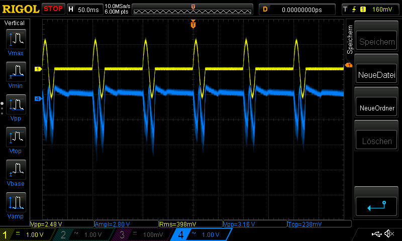

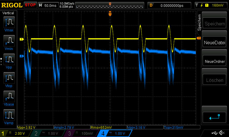

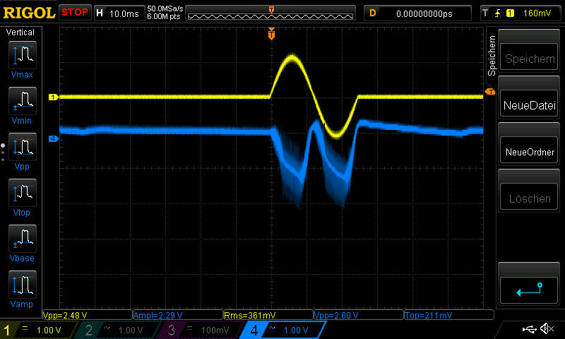

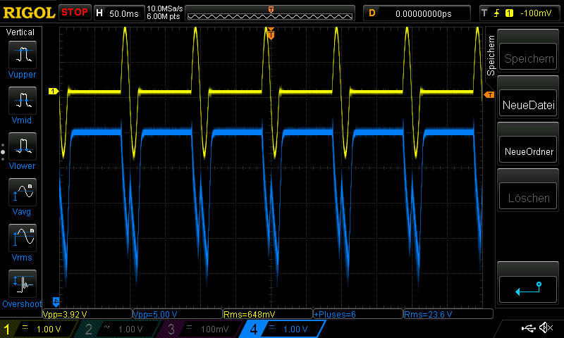

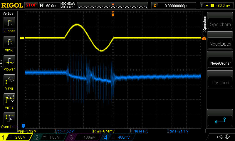

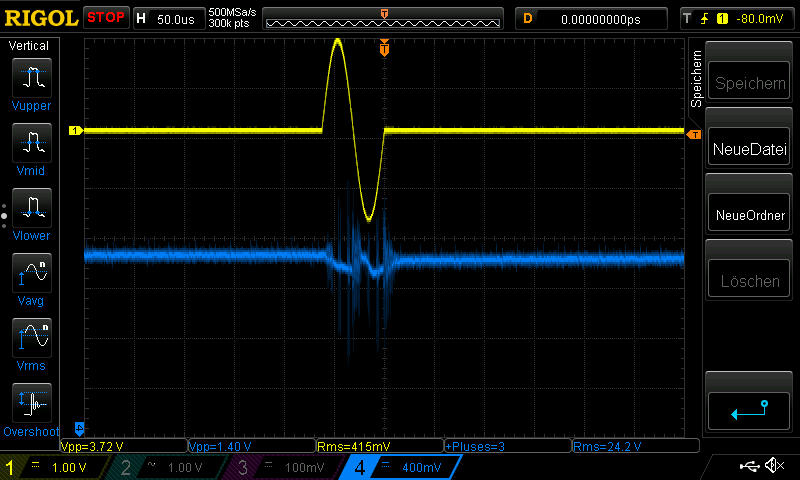

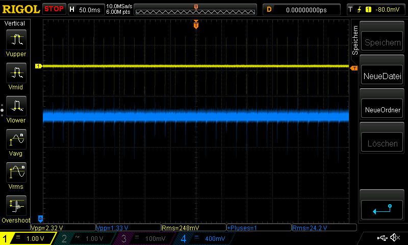

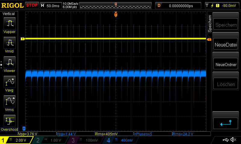

..burst test with original smps....
i want to test the origianl smps which comes with the amp
..same test procedure as here...
https://www.diyaudio.com/forums/class-d/309813-wrong-tpa3255-65.html#post5636968

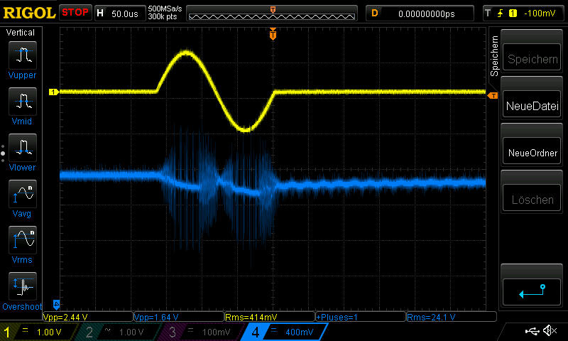

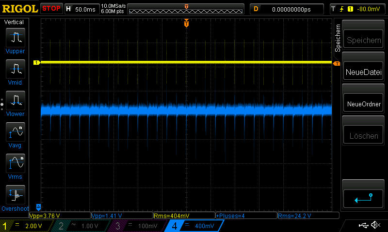

i try a loop test with a burst of 40Hz, period is 100ms, 1 Cycle. i try 800mVrms in or 1300mVrms into the amps input. at 4R load its more visible.
original amp and caps....TPA3255..measurement directly on the amps supply terminal
pic 1 40hz 800mVrs burst pic 2 more burst view (50ms/DIV)
pic 3 40hz 1300mVrms pic 4 more burst view (50ms/DIV)
pic 5 6khz 800mVrms pic 6 more burst view (50ms/DIV)
pic 7 6khz 1300mVrms pic 8 more burst view (50ms/DIV)

pic 9 12khz 800mVrms pic 10 more burst view (50ms/DIV)
pic 11 12khz 1300mVrms pic 12 more burst view (50ms/DIV)
pic 13 16khz 800mVrms pic 14 more burst view (50ms/DIV)
pic 15 16khz 1300mVrms pic 15 more burst view (50ms/DIV)

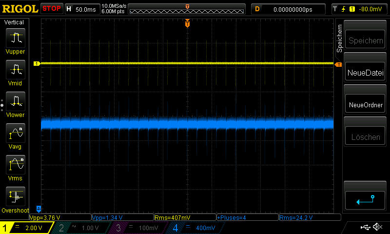

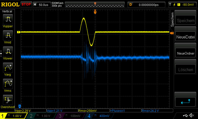

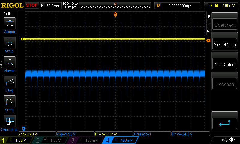

to compare to the LRS 150 -24...set to 24,01V mean well smps
pic 17 40hz 800mVrms pic 18 more burst view (50ms/DIV)
pic 19 40hz 1300mVrms pic 20 more burst view (50ms/DIV)
pic 21 6khz 800mVrms
pic 22 6khz 1300mVrms
in my opinion.....power by the original is not that bad...but is more noisy....

at hard burst of 40HZ ( 1300mVrms input burst) both amps drop the voltage.
re checked with DMM
original psu fx502spro 24,23V ---> 23,85V
LRS150-24 (24,01) 24,01V ---> 23,81V

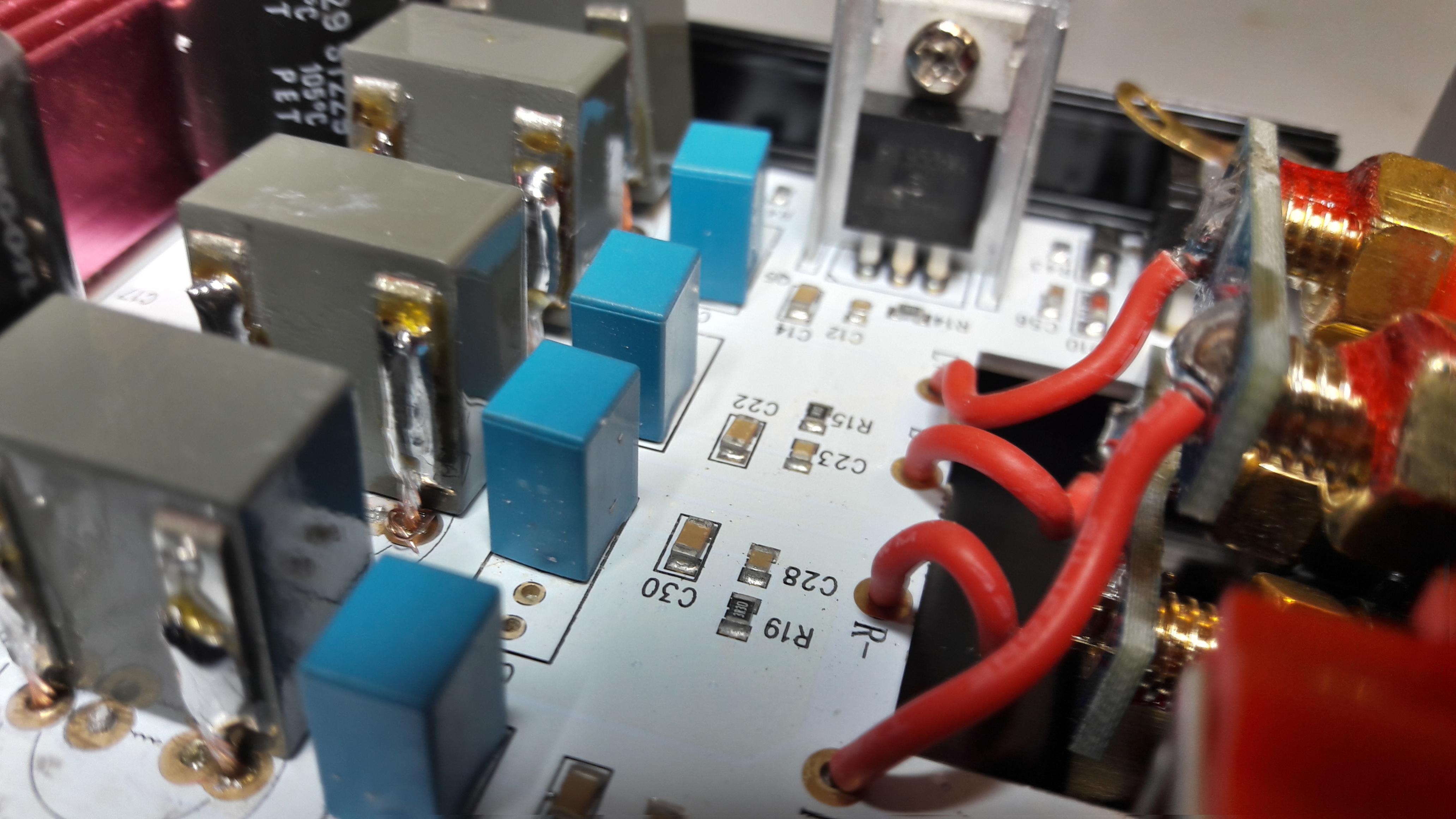

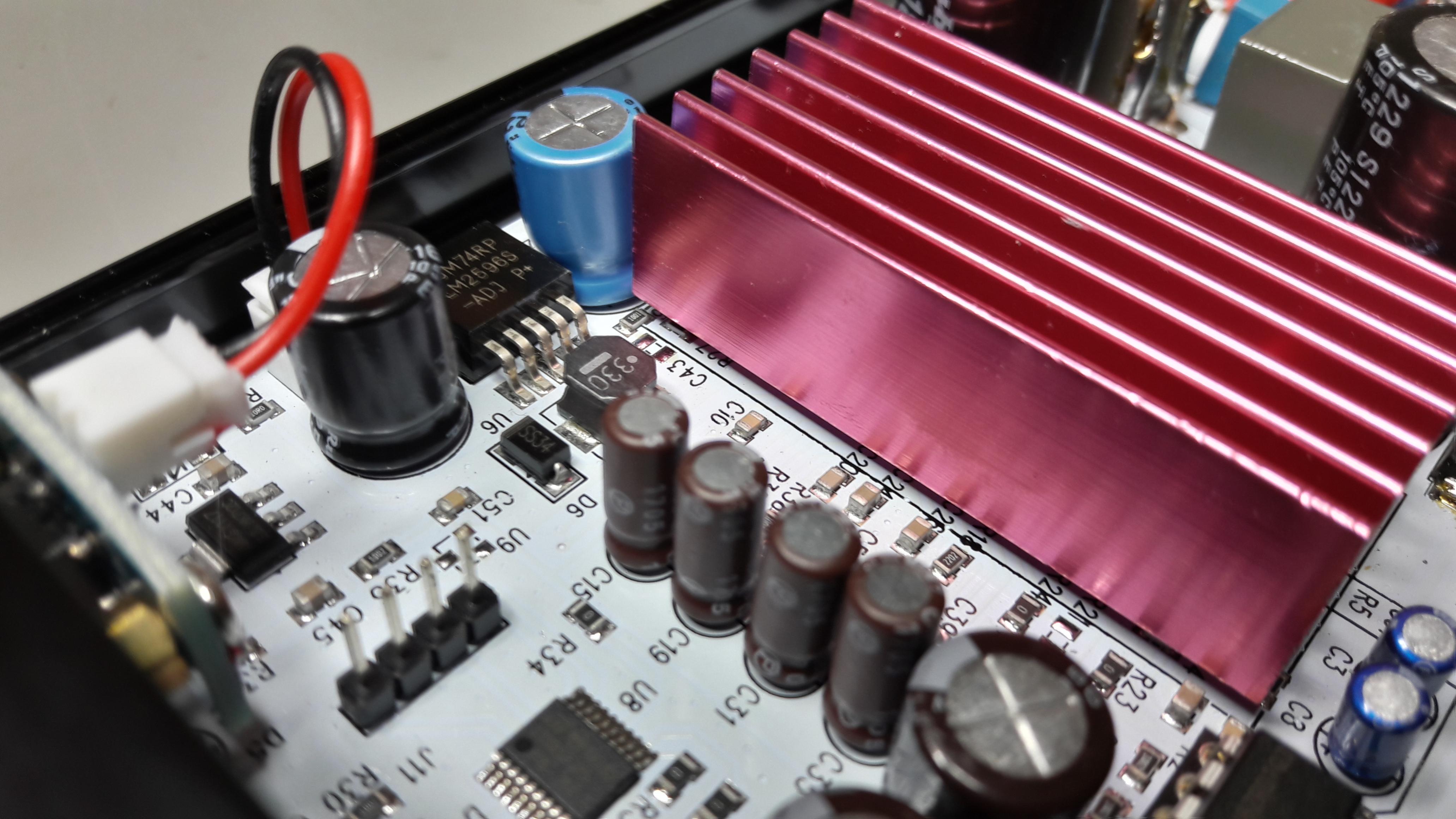

Hi
here are some measurements...i did have the THD equipment...
2 pics with changed caps inside = input caps are now the 10µF elna silmic 2
and at the white board amp (amp2) i changed additionally the caps at the regulator. regulator is the LM2596S. SQ compare not done....in the new year😀
chris

Chris, since you start modding the input caps ~
How is 2 onboard regulator (1 Buck, 1 LDO)
- much noise output by the LDO?
for the sake of your opamp LM4562 ~😀, any thoughts, shldnt replace LDO with low noise?

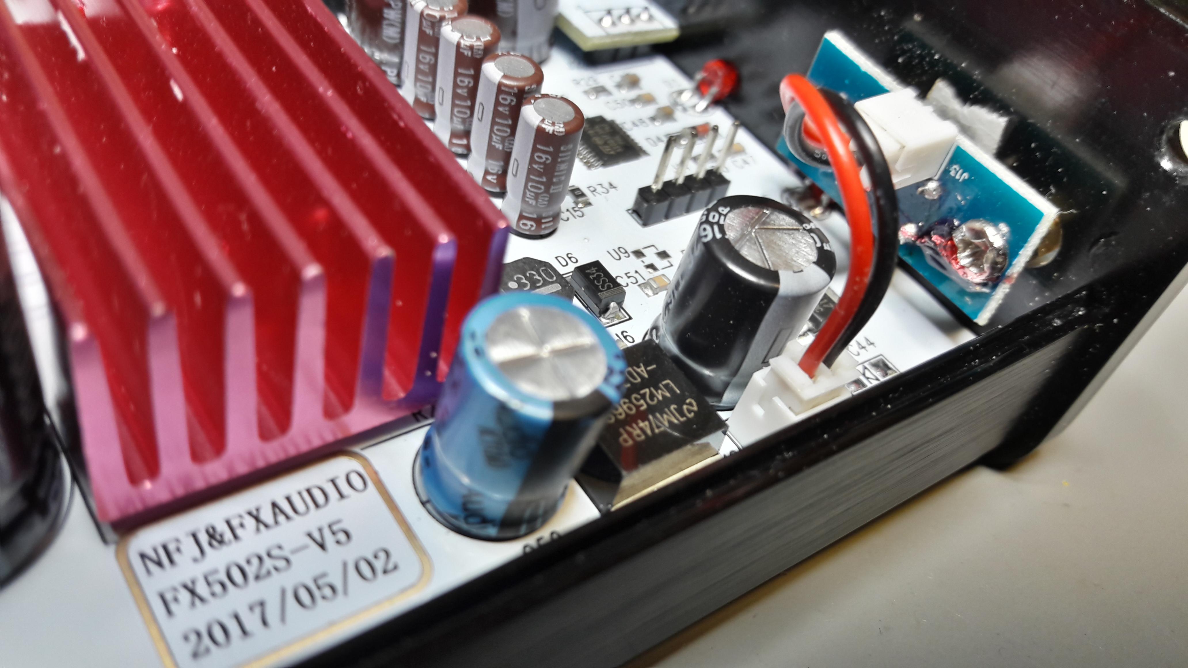

Hi
next year ...😀
as you know from my journey of my tpa3255 boards i learn about this regulators. i ordered different types....testing learning...will see
in the fx502sprois the "better" version of the lm2575 (52khz buck) implemented--the LM2596(150khz buck)
wish all of you a happy new year 2019!!!
luckly I planed to use this for my tpa3255 YJ boards...😛
its really tight !😀
SQ compare between both amps not done. same opamp (4562) same input caps (elna silmic 2) but now different coils

if you want to push more power it happend often that the amps go into the error mode, but its not a error of the chip - its realize the undervoltage of the original psu...nevertheless its a lot of power what you can go with the origin psu.
4 ohm speakers do not really work with loud level....my experience
i personally can leave with my mods and the power of this nice amp!!!😉
amp with 10-20W and less distortion is my target...
chris
