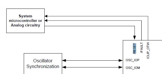

Any picture to show this chip location?
Hi forestsgump
datasheet the figure 22 - its the pin config of the tpa3251 !! it is wrong..i wrote this pages before
look at the picture attached..in the datahseeet is written that the RESET pin5 can be forced with a analoge circuit or a microcontroller...so the ST S003F3P6 8bit MCU is right here..😉😀
so...the only problem is that we have to check which pin of the µC set the pin5 of the tpa3250😀..and check the datasheet for the "time constant" to do this right...but sorry i lost at the moment with this µC🙄😱

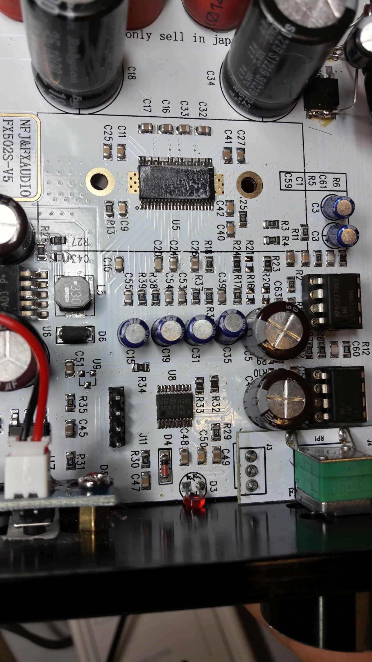

i looked at a pic of my pcb layout on the upper side (white baord)
if you follow the traces tpa3250 pin it looks like that it goes to C55.
because you report from the beginning that you had this pop on/off noise maybe check this region....... what do you have there...resoldering?
chris

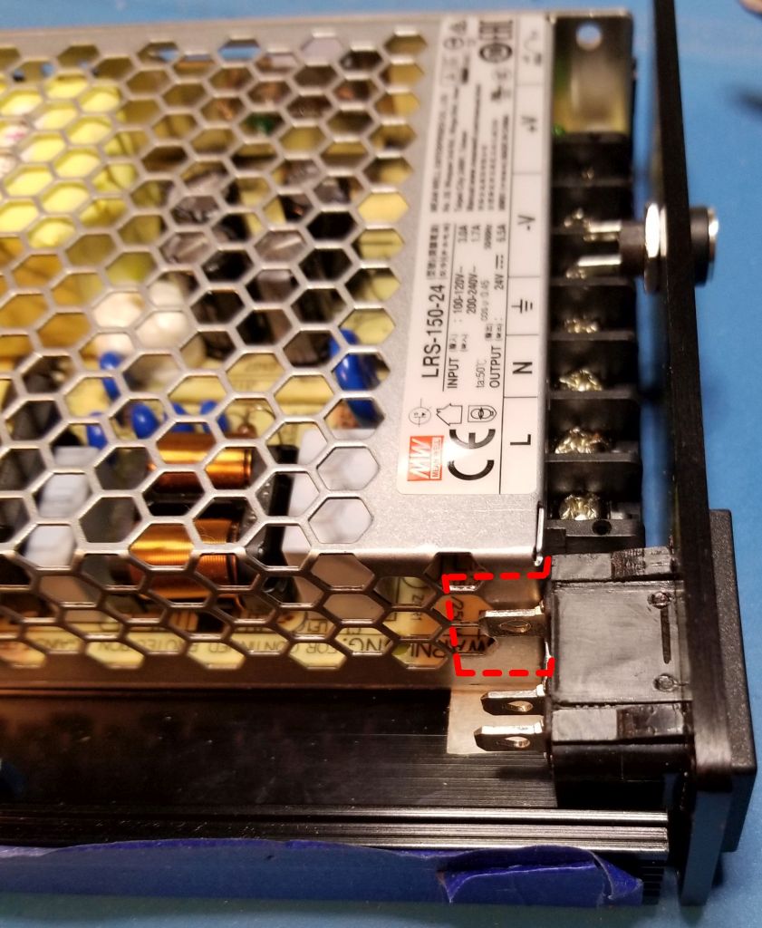

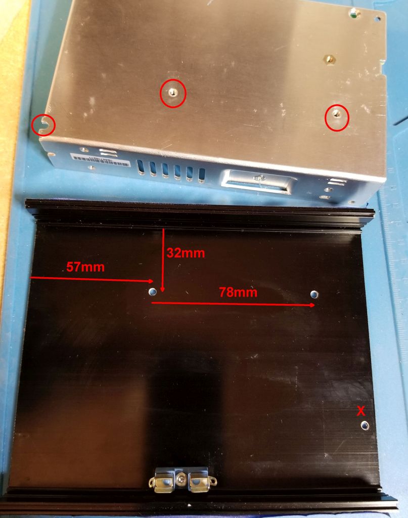

I don't have that PSU (yet), but I see that the B1304 case (commonly available on eBay/Aliexpress) should be just big enough to fit, [...]
UPDATE: Actually, I just measured a clip-in IEC socket, and if you're VERY carefull, and orient it vertically, you might be able to fit in the case it alongside the PSU. But then your 24V socket would have to be mounted directly above the supply's screw terminals. Tight. Very tight. :darkside:

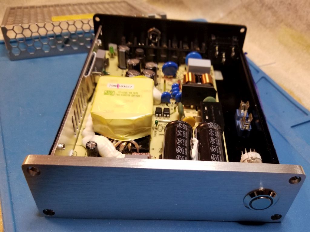

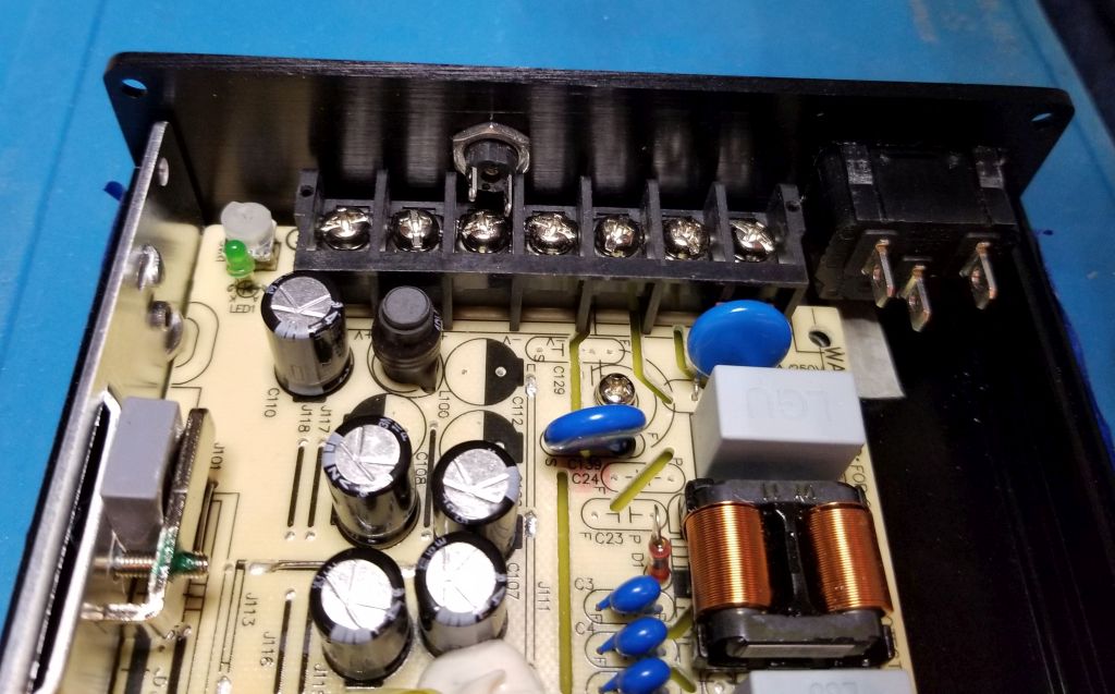

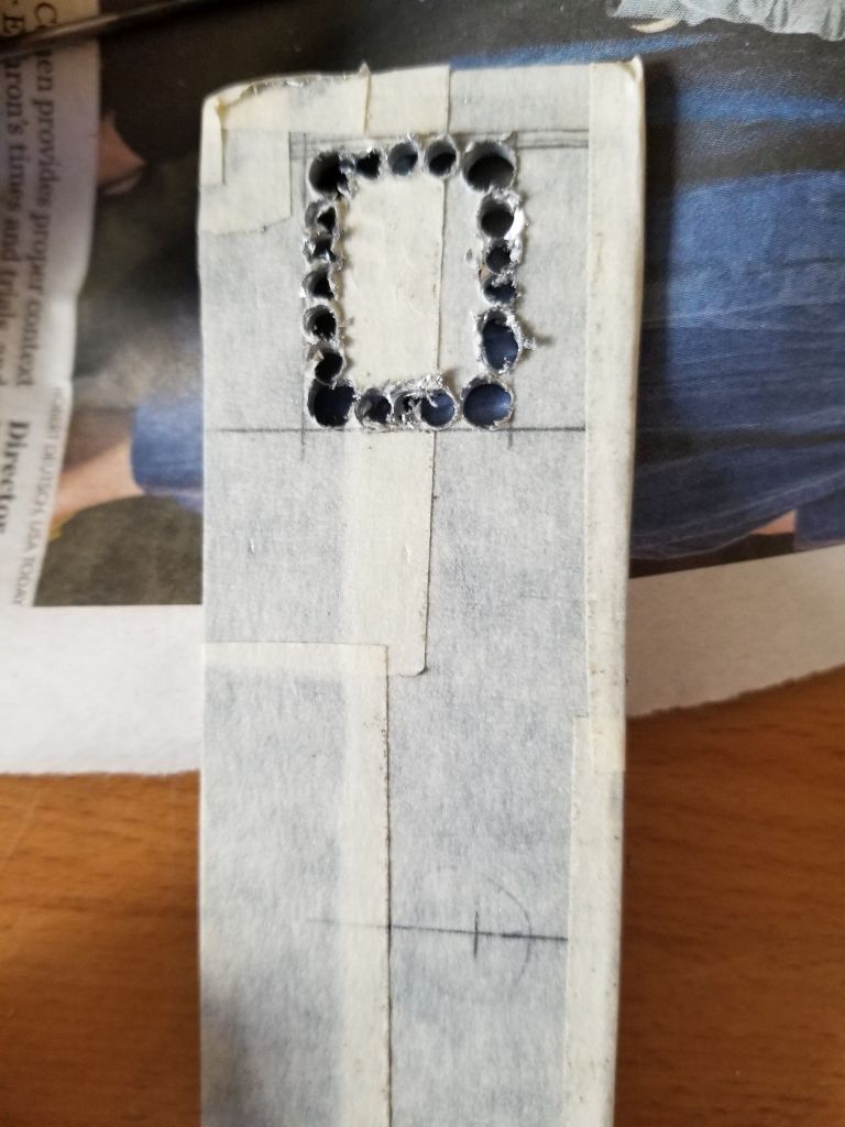

OK, here's my update to close the loop on using the B1304 case to mount the Meanwell LRS-150-24 PSU. I went ahead and ordered the power supply and spent a couple of hours (plus) cutting and drilling my B1304 to mount it in. I discovered that it IS possible to add a clip-in type IEC socket, but you have to remove the perforated top shield to give clearance to do so. (Note: a screw-mount type with 'ears' is too wide to fit, either vertically or horizontally.) However, given this is a solid aluminum box, the loss of the shield is no big deal. You'll also see that I added a panel-mount fuse holder, but you could use an inline holder, or even omit a fuse entirely (on your head be it).
The worst part of the mechanical work is mounting the power supply. There are few decent mounting holes, and two of them are blind threaded holes, requiring careful measurements and drilling to align everything correctly. OK the other worst part was cutting the hole for the IEC socket. Turns out the rear end-plate of the case I had was much thicker than I usually see on such cases. So it took quite a while to drill rows of holes and dremel and hand-file the square hole to fit the IEC clip socket (first pic - in progress).
I've included pics after the parts are all test mounted (prior to wiring). With 20-20 hindsight, I'd have put the DC socket way over to the other side, above the voltage adjust pot. But too late now.
To save you having to re-invent the wheel 🙂, one of the pics shows the hole positions/measurements (to hole centers) for the blind holes to mount the PSU. Obviously you should first verify these hole positions with your PSU, in case they are different. The 3rd hole (marked "X") I just marked from the top and drilled, after test-mounting the supply with the other two screws.
Although I just removed the shield, actually, you could keep it... but you'd have to cut out a piece in the corner, to fit around the IEC (see the red dotted lines in the last pic).
All in all, I really like the end result. Very nice looking case and absolutely the smallest possible - and neatest - package to fit around that PSU.

So I was checking the output from the LRS-150-24 power supply this morning. The adjustment pot can alter the output voltage in the range 20V to 30V (no load). Has anybody cranked this sucker up to 30V and tried it? That would give enough headroom to obviate the need to change that resistor on the 24V regulator in the FX502. Plus maybe a few more watts?
Not sure if cranking it up would harm or degrade anything in the power supply - or maybe cause more supply noise.

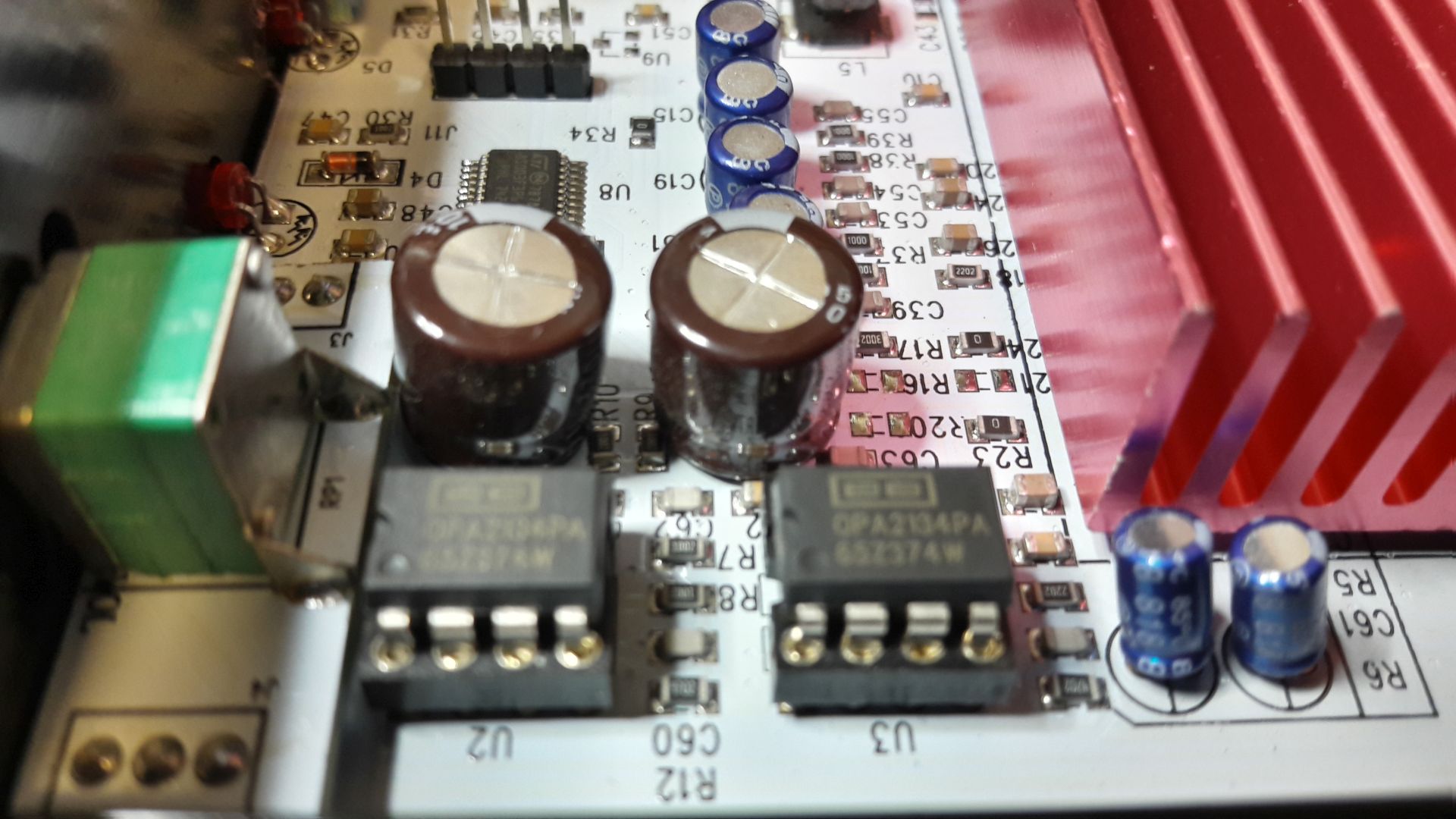

maximum deshovy production technology fake ne5532p. in my fx502s pro at the output of ne5532p were electrolytes SamYoung, replaced by tantalum AVX TAP106M035SRW
hi ekbrus
Sorry .. but i did not get your point about magnetic...i personally do not care if the fake opamp are magentic or not- i change it to "orign" onces
the Tantal 10µF after the output buffers (opamp) - AVX TAP106M035SRW as you described are instead off the 4 electrolytics. i am not an expert but i guess the TPA 32xx chip do not like DC on its inputs = INA, INB , INC, IND...with the tantal you maybe get some DC....
wait if some experts ...Voltwide/Doc give us an advise here...😉
