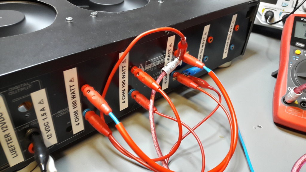

...smsps measurements...
Good morning
yesterday i checked this RC smps shortly. recommended 15V /16Amax
my loadbox has 3x4,2 Ohm /100W resistors = 1,4 Ohms overall resistor.🙂
10,53 Ampere at 14,74Volt is fine. no noise measurements with scope.
the fan is very loud.🙄
Good morning
