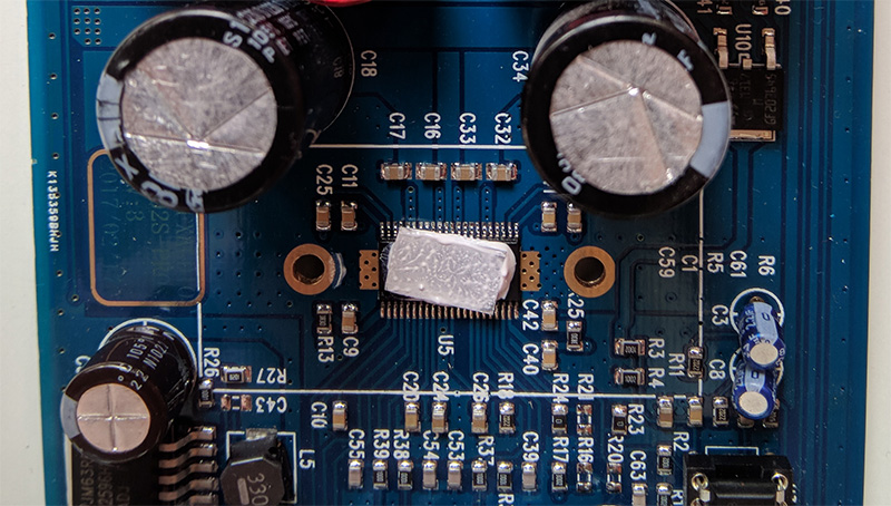

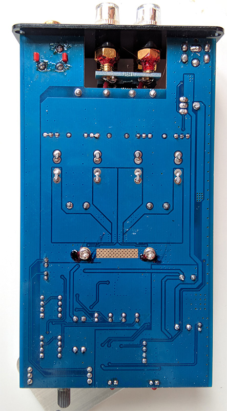

The purple thing is NOT the heatsink. Browse Ebay for a silicon pad to put under tpa3250/pcb between pcb and aluminium enclosure, then the enclosure becomes extension of the pcb=heatsink.
This thing is aluminum, hot and means it removes heat.
So how can this thing be not a heatsink?😀
And capacitors😀Your inductors are hot, so they must be heatsink too.

chip's top is plastic, isolates heat, chip's bottom is metal, conducts heat. PCB is heatsink for tpa3250, "increase" pcb (include enclosure)

But how to make heat dissipates more efficient? Install heatsink on the back of the board is not possible. And this thing on top is bad or good, but it dissipates the heat
It doesn't. The pcb does, groundplane under chip that is, does. Couple that to enclosure with computer cpu pad and you improve situation, maybe removing the purple thing improves THD, I don't know, but it has very little function, it is cosmetic.
never the less i would keep the purple heat sink + the silicon connected on the buttom of the TPA3250
Tpa3250 performance is tested on this evm pcb, with components as in evm bom, no forced cooling but using standoffs and no enclosure 🙂
You'll need to measure distance between pcb and enclosure, select a pad that is thicker but not too much, because you'll have to get pcb in again and too much pressure might cause some of the smd components to crack, you know pop pop pop pop if it is a little capacitor 🙂 Be carefull because finding the cracked one and replacing it is not a nice job, often ends in replacing all the little caps or ordering a new amp 🙂

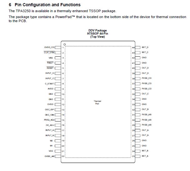

here is the overview of different housings
1 PDIP is the good old housing - as you have it in the FX502S
2 SOIC is for SMD
3 To99 is the metall round housing - if you want to try this check the internet for a DIP adapter = DIP 8 socket, as you have it in the FX502

Yes, but which housing is for sale on the TI Shop site? I ordered a pair there, but I am not sure if I am going to get the rectangular or the round housing.
If you used a discount code there was a sale, if not it was regular price.Yes, but which housing is for sale on the TI Shop site? I ordered a pair there, but I am not sure if I am going to get the rectangular or the round housing.
Two packages are currently active, smd soic and pdip, nanopb is pdip, maxnopb is smd, but could see that in datasheet.
That means the TO99 metal can is obsolete, out of production, at the moment.

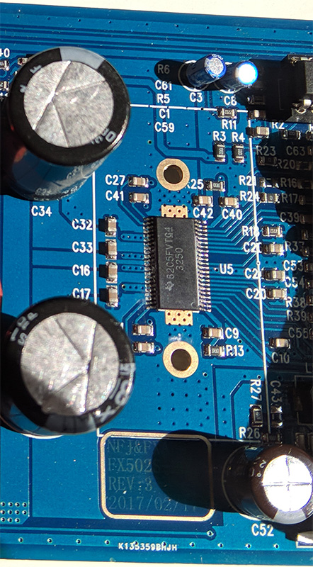

3rd pic ....looks not real TPA3250....or?
They do not use pcb/heatsink very well, but they did use purple heatsink to cool pcb, it just happened to be above chip, by accident, the screws transfer heat to purple sink
One could use screws and metal/aluminium pad to screw (bottomside) to enclosure
