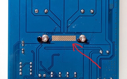

Some heatsink should be connected here
but too small distance to bottom part of the case.
Сonnect directly to bottom part of the case impossible due to the design of the case - bottom part moving when you insert the board
but too smal distance to bottom part of the case.
is not correct = because the srews are bigger , so fill up the room between the 2 screws with silicon pads and then it have to fit to the buttom plate of the amp case...

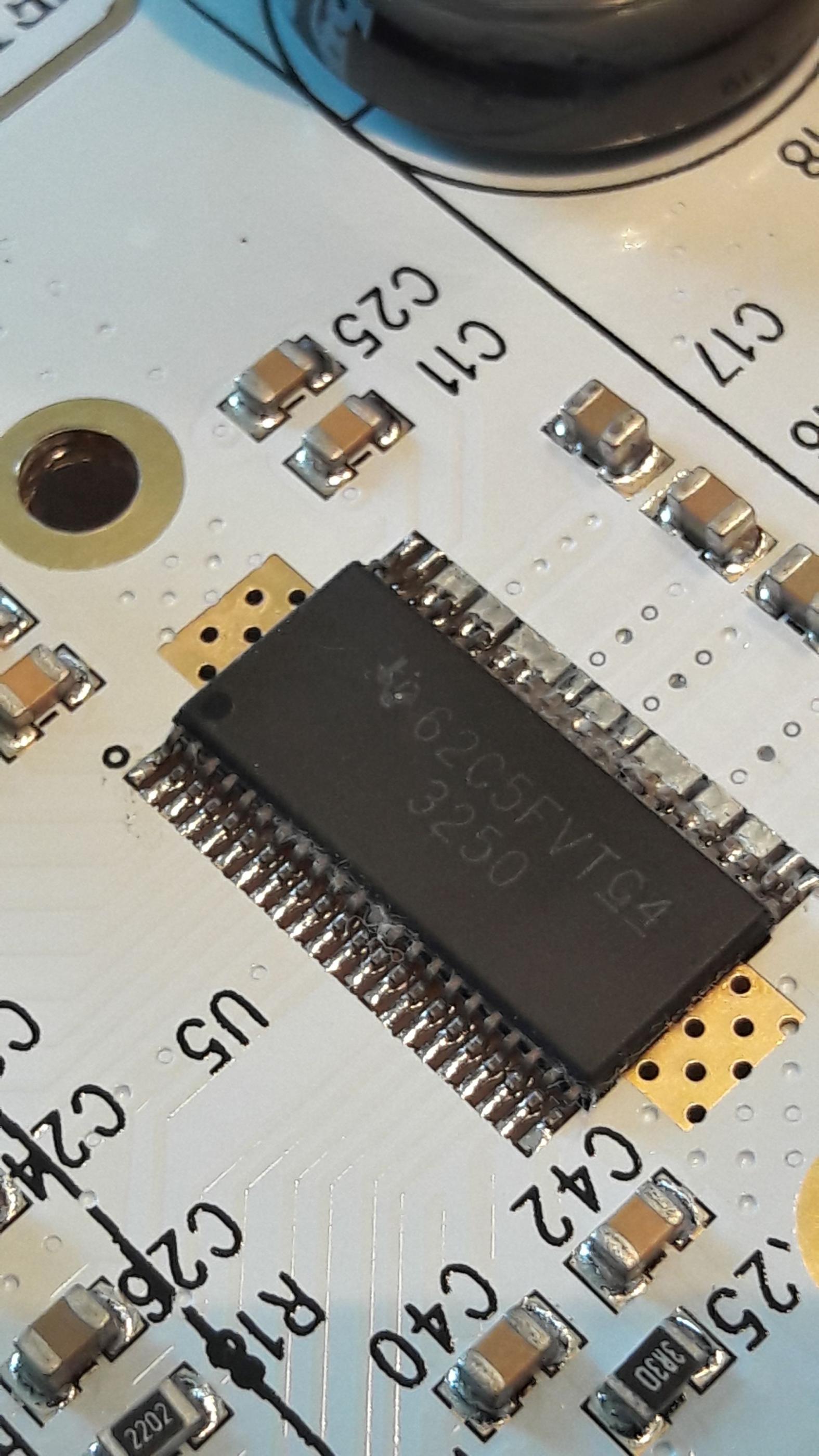

Hi
i opened completle the amp and I made some pics. i am not really sure if this chip is the real TP3250, The with label is very weak.
i measure the big caps = rubycon 1800µ/35V and i found a datasheet were i see 3 different sizes for this yxg series...so it looks ok for me.

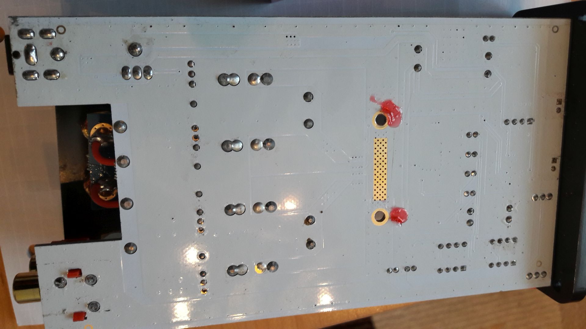

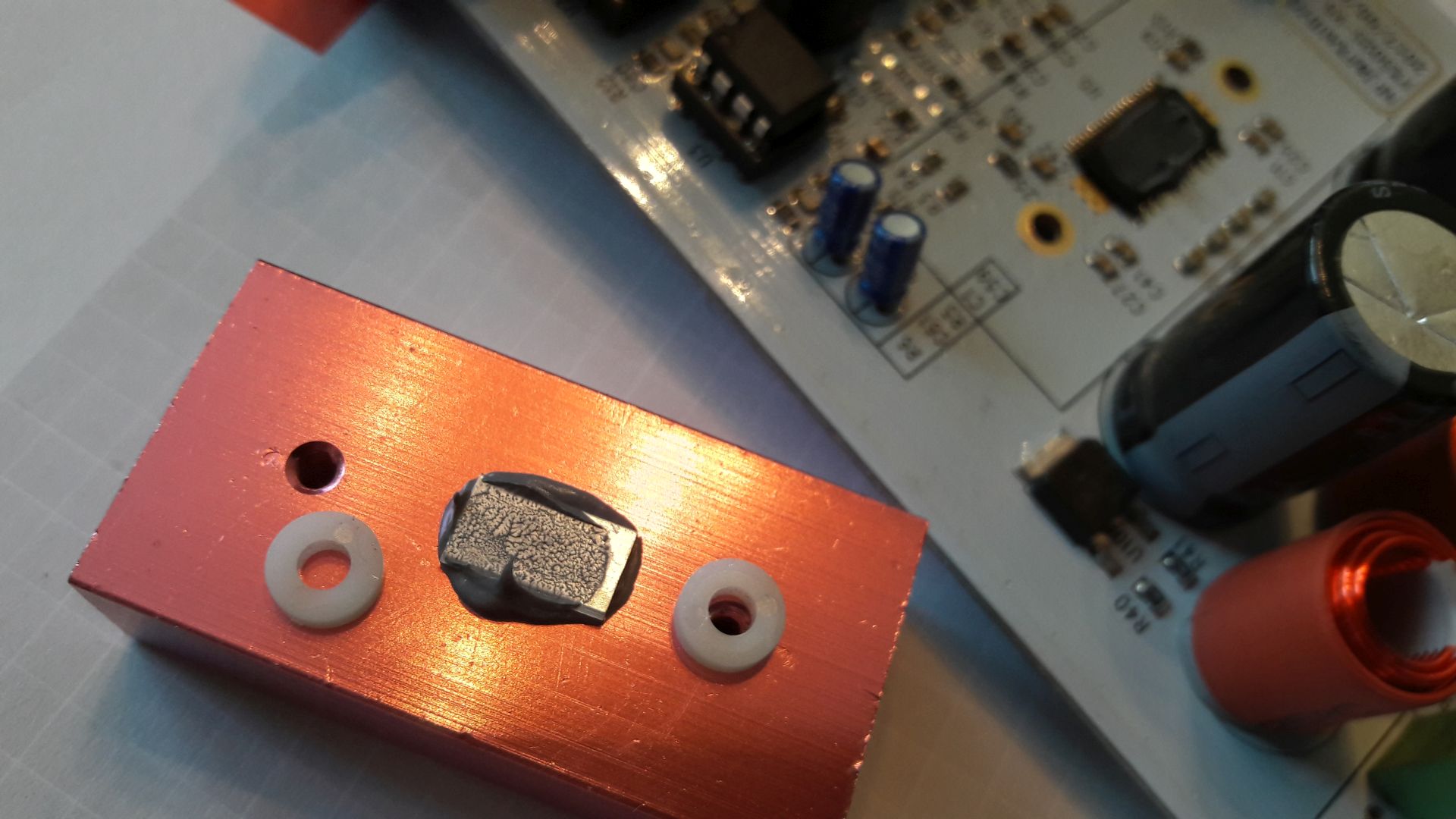

...mod .....cooling situation...
i pick up the idea from post before und mod the lower part of the pcb where the tpa3250 is mounted. if you measure the distance between the lower line of the pcb to the buttom alu case plate you measure about 5,1mm.
i found a ceramic resistor MPR5N 0,1 Ohm (link below) in my box and cut the pins and give on both side thermal paste and stick it between the screws of the chip and slide the pcb back to the alu case. i checked the position and evereything is fine.
so in the future I sould measure on the buttom plate a hot spot under the chip.
resistor MPR5N - Google Search
chris
Looks like improvements of v5 are in the white color of the board only😀
we will see...😀
step by step...actually the amp 1 V3 blue is running with the lm49720....first impression is very good....after fair "burn in phase" i will compare to the amp2 (BB2134)....if there is a difference ...i will change the opamps vice versa...
watch out if you fix the resistor ...measure carefully...5,1mm ..if you hold the pcb in one hand and fix the ceramic resistor then slide with the other hand the alu buttom case....dont crack the pcb...
