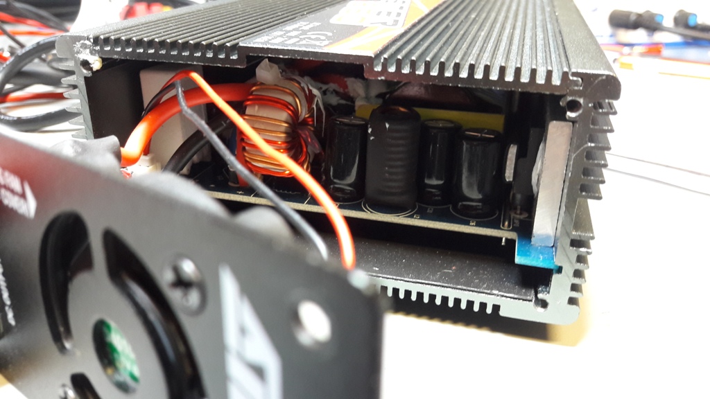

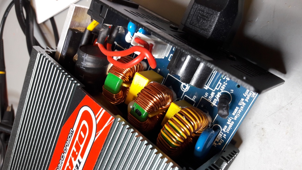

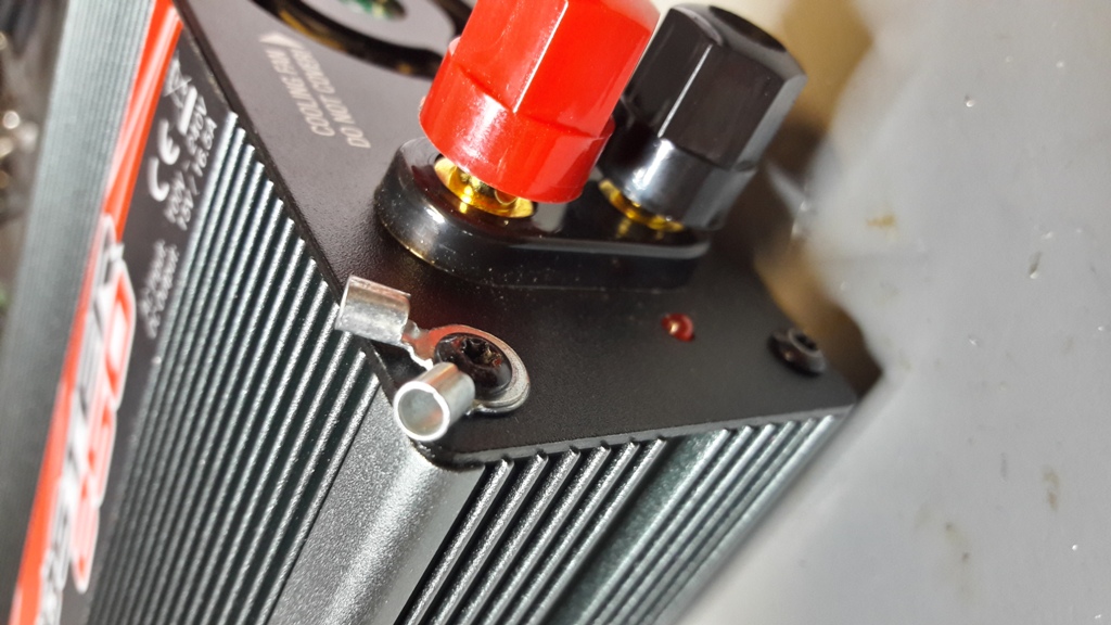

Hello
yesterday night i want to check the smps. so i opened it I did some pics.
the smps housing is earth grounded and therefore i add some extra pin to connect the scope proper to it.
smps switched on without load.

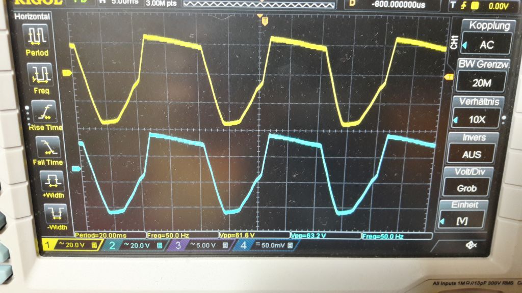

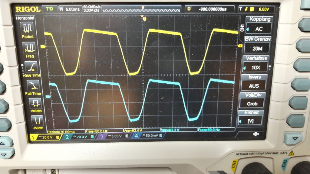

i want to measure the noise but if i looked a t the scope i was totally confused.😕😕😕
i do not have a differential probe for my scope and i mentoined that i look at the noise with earth grn and the positive output.
yellow positive output
blue negative output
my DMM shows without load 14.99V --> ok
so how can i measure the noise???why i get 66V to earth. 50HZ is the frequ by the network (230V/50Hz)
mybe it was really to late for my ...to realize what happend here...😀😀
what did i wrong?🙂

i forget to write...the signals shows nearly the exactly the same with load of about 2 ohms and 7 amps.

chermann, interesting pics, this SMPS will 100.0% fail safety test. I wondered, how they can sell it legally?

I see no safety clearance(about 7mm of the air gap to a "COLD" side) on the "HOT" side of your SMPS. It's not necessarily deadly danger for you, but the company which selling such stuff is under potential risk. For example, a user may sue the company and get few hundreds pcs because an uncompliant product has CE mark and so on.

bottom side case has foil, that seems ok, I don't know about sides and top and the wires I see.
pins of TO-220 are <3mm to heatsink, it is enough to fail "High Pot" test. Actually, they should have a lot of room inside because the power is tiny for such size. You can buy 3x power for a less money with no safety problem if check for the PC desktop ATX SMPS. 12VDC need to adjust for 15VDC that's it.

why isn't possible? It is very easy, just load the beast for a rated amperage and stay with scopes probe on the outputs.
...hmmm ...as i posted in #424 its the same signal at the outputs with both probes.

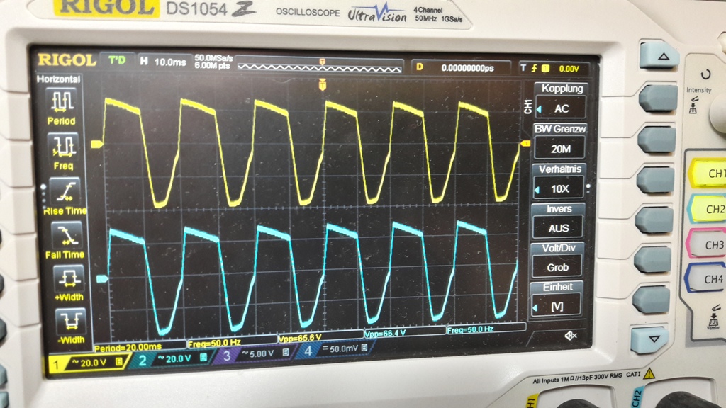

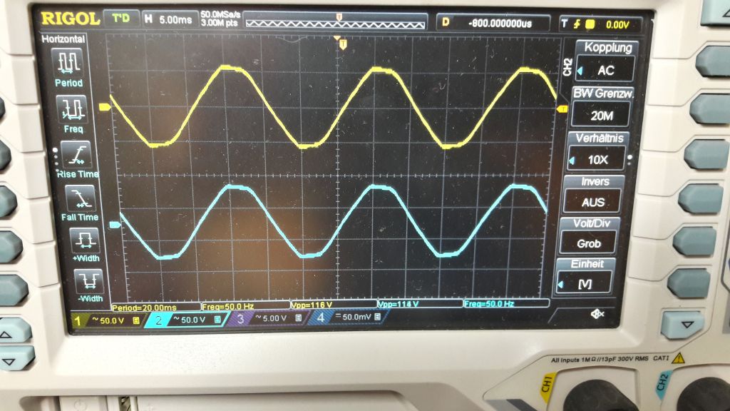

so ...this smps is crazy and i am not sure to use it anymore 😱
pic 1 connected but not switchend on - 116V to earth!
pic 2 connected and switched on but no load - -63V
pic 3 connected, switched on and 2ohms load - 63V , 14,76V and 7 amps
i rechecked the rms with my DMM and its true !
so this SMPS is danger!😡

116Vac looks very much like half 230V. Could it relate to an old trick using two equally size (safety) capacitors going one from phase (230V) to chassis and one from 230V return to chassis?
It was a design intended for buildings without earth.
I recall a weak tingling feeling in my fingers touching such an apparatus. It was not dangerous as the current was very low.
Try to measure the DC impedance between the one of the 230V plug contacts and chassis and then the other plug contact and chassis. It should exceed 1MOhm in both cases.
