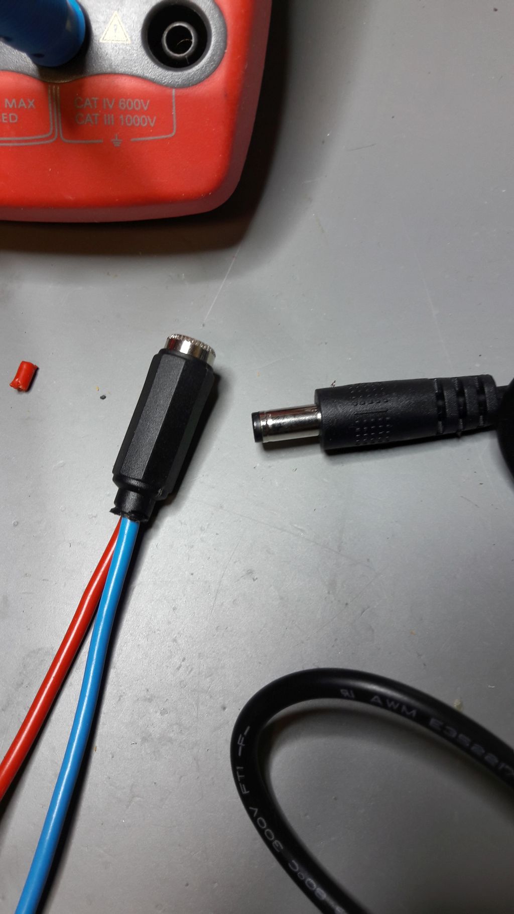

As Fauxfrench give me a hint i measure this psu. i got on every output to the case (earth GND) a 6,7 Mohm resistor-measured with my LCR meter.

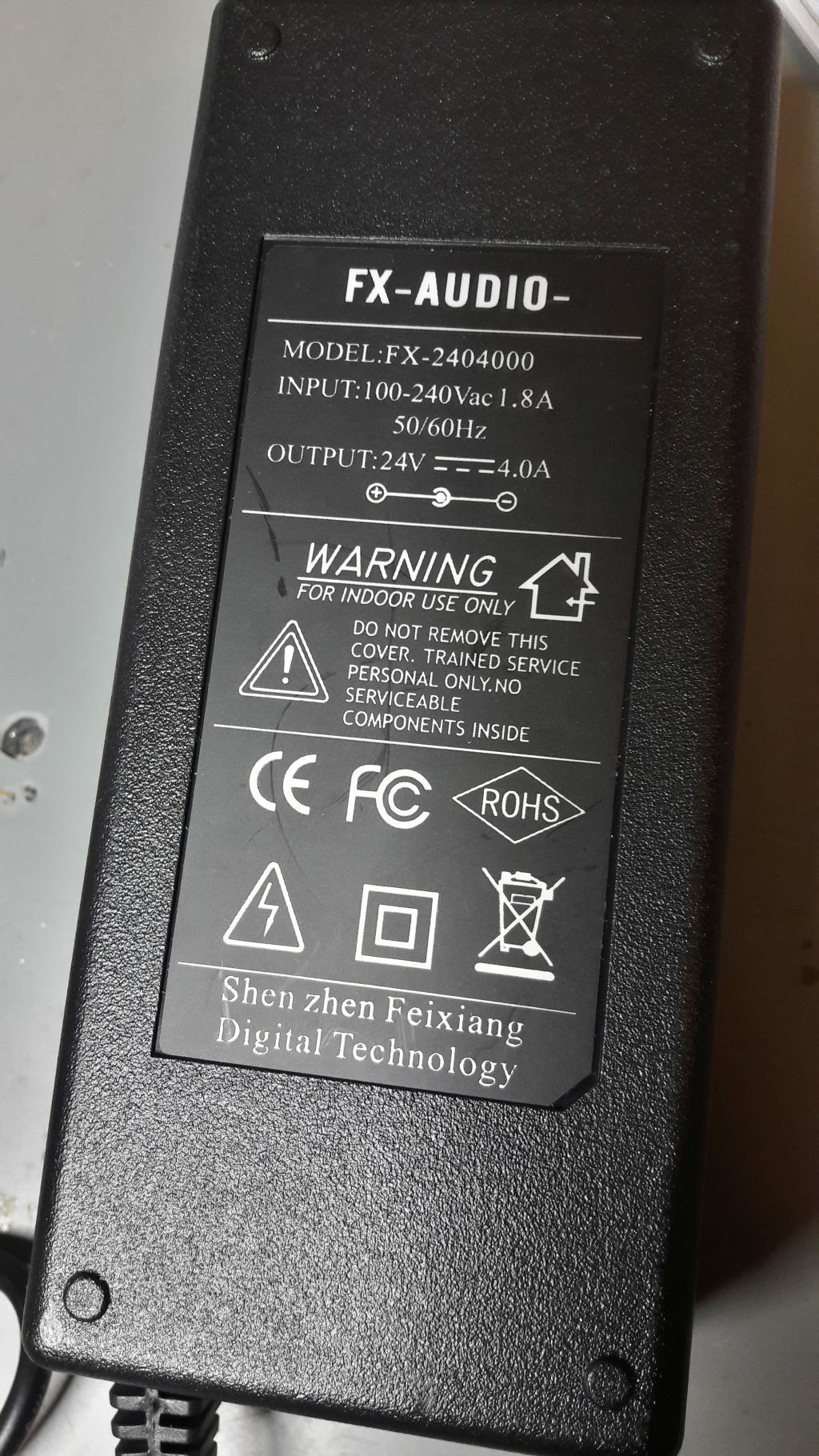

I did a test with both psu.
the PSU is able to push 5,65A @23,13V for 10min. it gets hot on the side more then on the top -about 60°C. after 10min i stopped.
23,13 x 5,65 = 130Watt
so the power is better than expected or recommended by the manufacturer
FX 502 pro is labeled with 24V x 4 Ampere = 96WATT.
so the psu is fine !

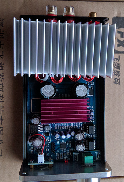

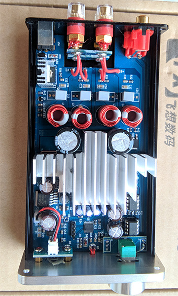

My new heatsink waiting for installation😀
as zek wrote...it is not easy...😀...belive me there is no room for that.
the original "heatsink" is 50mm long ,25mm width and a high about 15mm. 7 fins with approx 1,5mm. so its a kind of 5K/W heatsink.
use the cearmic resistor on the buttom of the pcb and get your "additioally" heatsink from the housing of the amp.
dimension ?
Before it was sawed it was 90х50x26(h) mm. Now the capacitors do not touch the heatsink. But they still heat up a little, apparently through the board.
By the way, the height of the original heatsink was 15 mm only. And the new one is much larger even after sawing.
on the pic it looks like you can mount it on the alu housing on both side?
yes , no?
No, no contact to housing. It's not easy to do, 'cause the top and bottom covers move.
Heatsink gets heat from mainheatsink=pcb, you improved connection to pcb ?
Measured temperature of (purple) heatsink doesn't tell much when connection to pcb is not good, what is temperature of pcb below chip or ground next to chip or on negative pin capacitors ?
Mosfet circuit used by FX isn't on 3250 evm I think, MCU isn't on 3250evm either, so FX tried to make own protection maybe ???, how to know fault/protection tripping is indeed tpa3250 it might be FX own circuitry ???
The 0V problem has more to do with pcb ground layout than with external psu, seems like external psu is powerfull enough for the Sonus speakers (=easy load), or doesn't seem reason the FX reaches protection.
