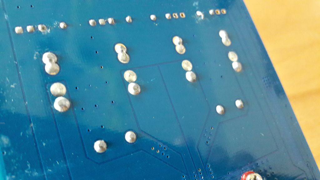

Soldering to pcb of coil (s) is ok ?
Switch off just as fast with like 100Hz to 10KHz sweep ? Or 200Hz to 10KHz, or does amp switch off with 1V 1KHz sine too ?
the soldering looks ok....see pic

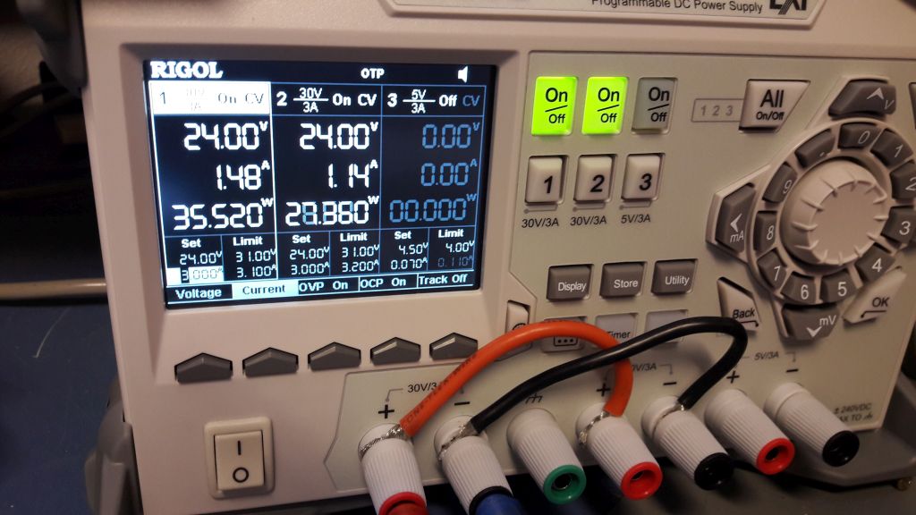

in running time a can see on the rigol psu the power consumption.- both channesl working...(pic2) one DMM is mearuing the voltage at channel R, the other is measuring amps at channel L.
if the amp is not willing to do somehting i can see just one channel or no channel is working.
the amp is after this shut down in a "strange mode", because the amp do not care.......with or without input from freq. generator he is switching on but no signal on ch L+ R....
its strange too that at every case i changed from 8 to 4 ohms load and i switched on the first time i got the error led blinking!

power consumption at running test (just 3min) at 4ohms

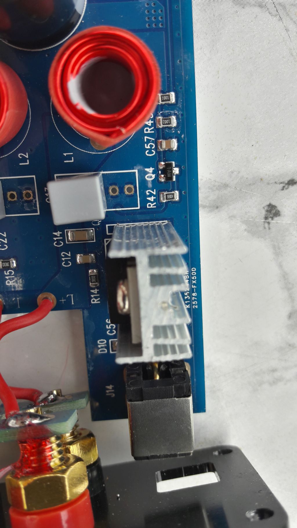

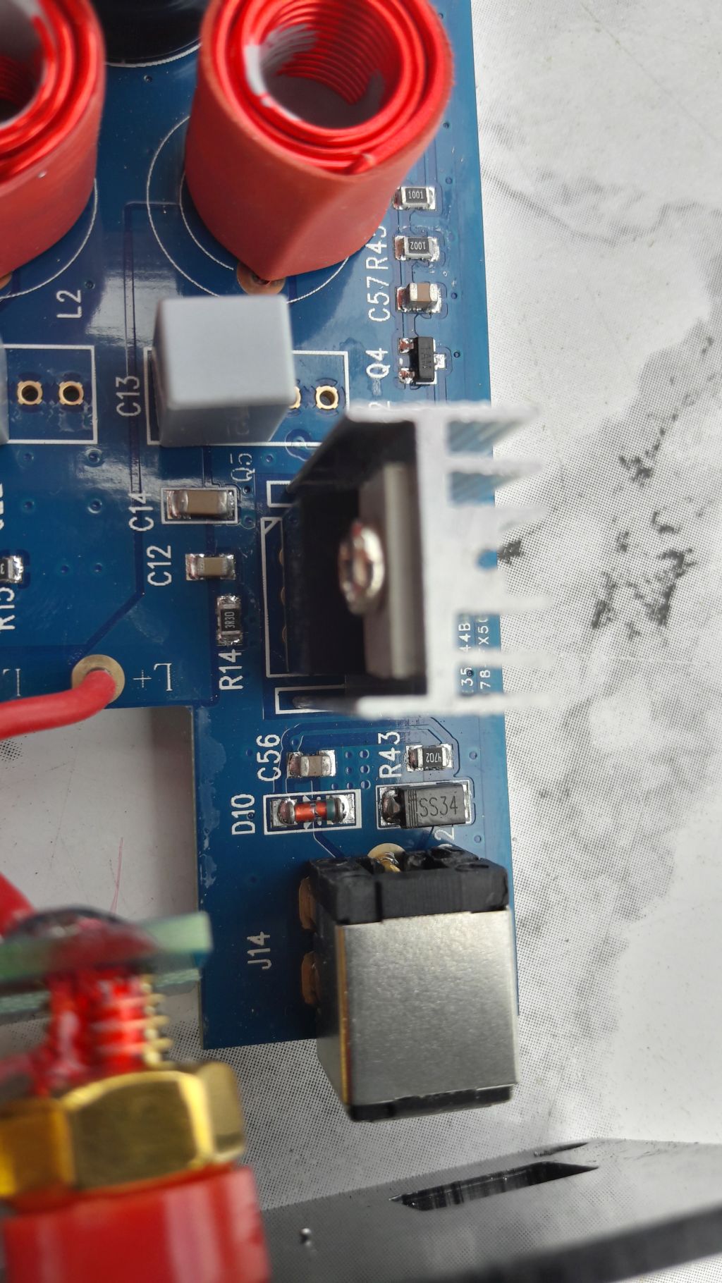

...about the IRF 9530.....closed to the input voltage socket...
i did 2 pics from the upperside...
......hmmm... no idea...

R41=2400....236ohms and R40 = 4301.....3020ohms ??
if i use the calculator:
with this values R1= (R41)= 236 and R2=R40= 3020........i get : 17,25V
so what ????😕😕
chris
Hi Chris,
A "4301" marked resistor has, as you already assumed, a 4 - a 3 - a 0 and 1 more zero in resistivity. Thus, 4300 Ohm (4K3). Why do you measure 3020Ohm? Because you measure "in-circuit", hence, with other possible ways for the measuring current to run. You already know you have a 240 Ohm resistor connected to the 4301 resistor and that 240 Ohm resistor is connected to the output of the LM317. Very likely you have a resistive load on the LM317 output. Thus, when you believe you are measuring the value of the 4301 resistor only, you at the same time have a secondary current flow-path through the 240 Ohm resistor and the resistance at the LM317 output.
From my calculations of the LM317 output voltage, this resistor is close to 4K3 as it should be - only the input voltage is too low and you have a saturation problem.
