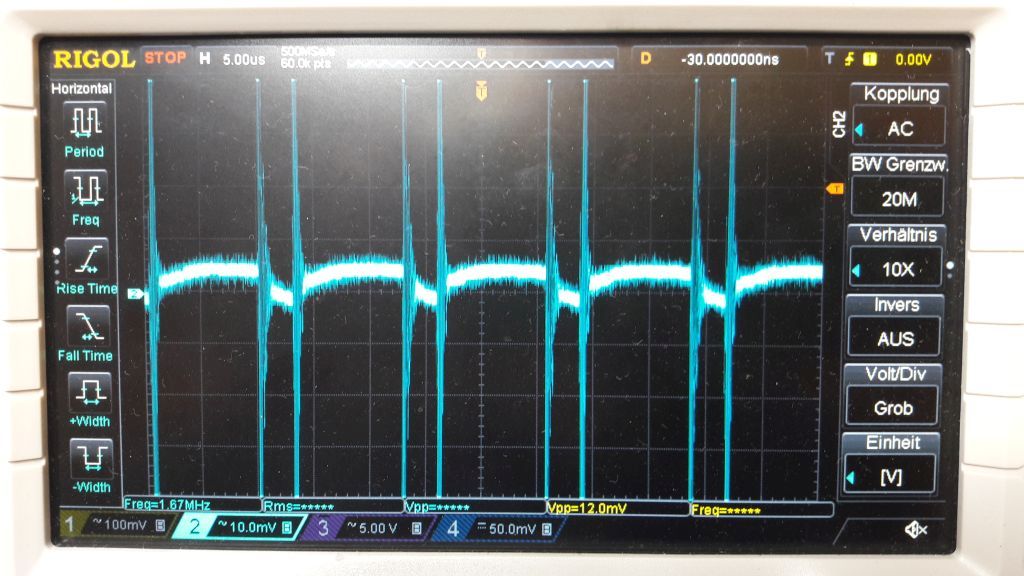

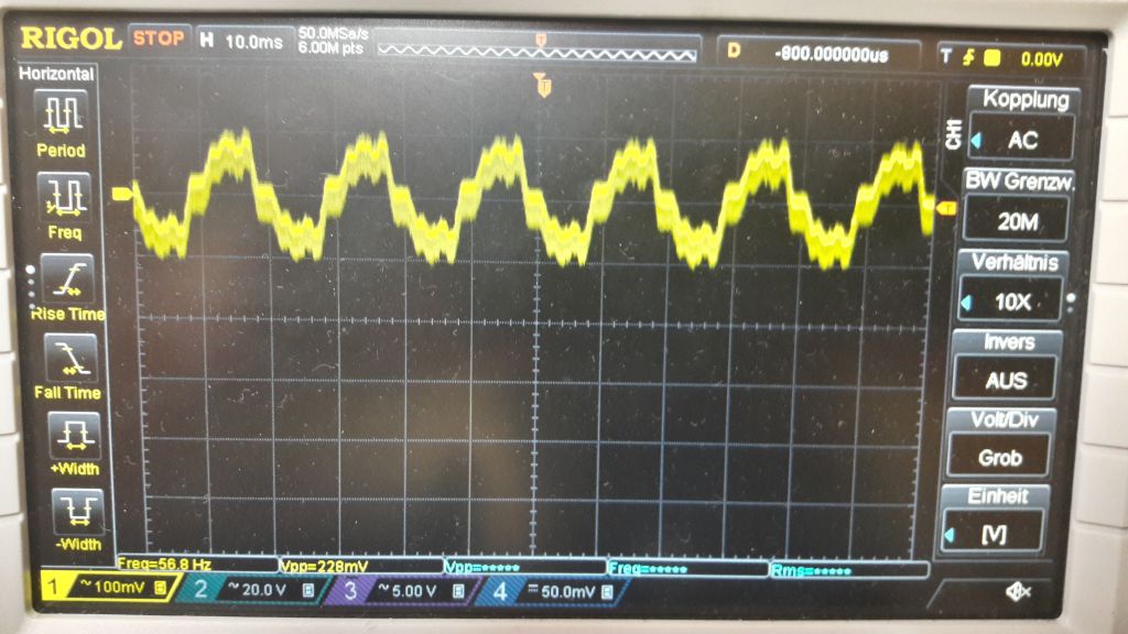

Hi
i did a short ripple measurment at 8 ohms (2,8A) and 4 ohms (5,6 Amp)load at the origianl psu (psu1).
about 220mVpp during load.
Any cheap trick to filter out this? CRC filter?
cu chris
cu chris
Hi Chris,
A CRC filter won't work on 50Hz and 2.8/5.6 Amp. The "C"s would need to be huge (and the "R" cause power loss).
The power adapter I assume you use, is simply not fast and precise enough to regulate better. 220mV at 5.6 Amp is actually not bad.
Only a linear regulator, preferably with an emitter output, will do better. Unless, you buy a specific audio SMPS with fast step response and they are hardly cheap.

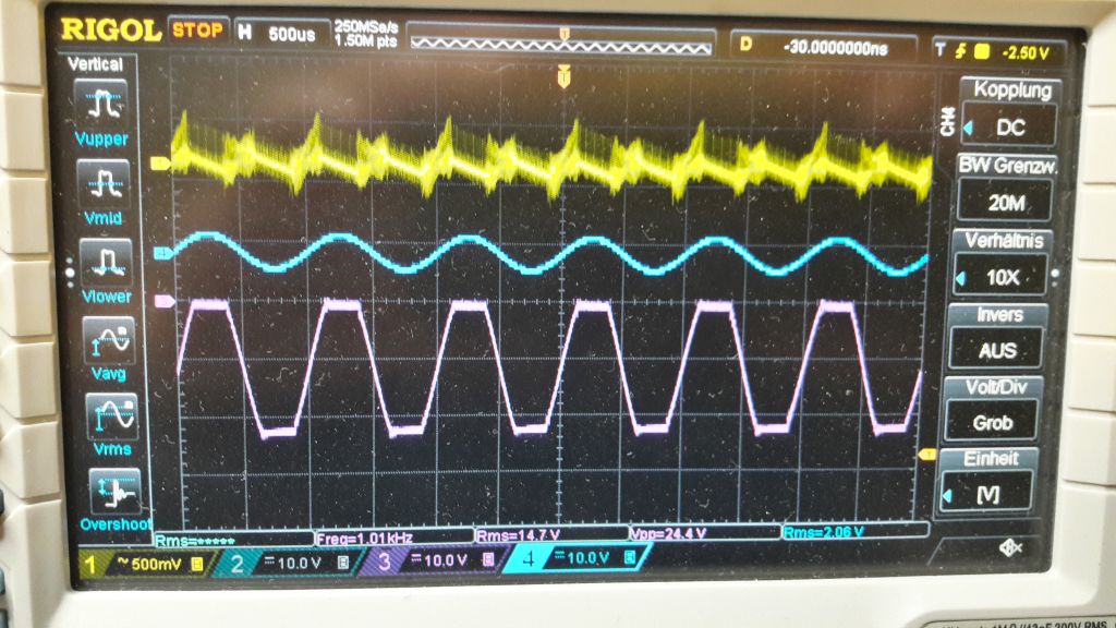

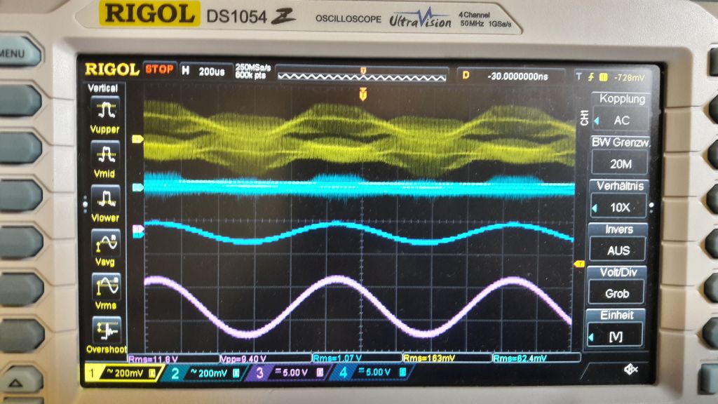

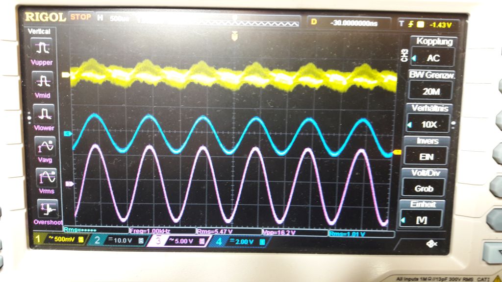

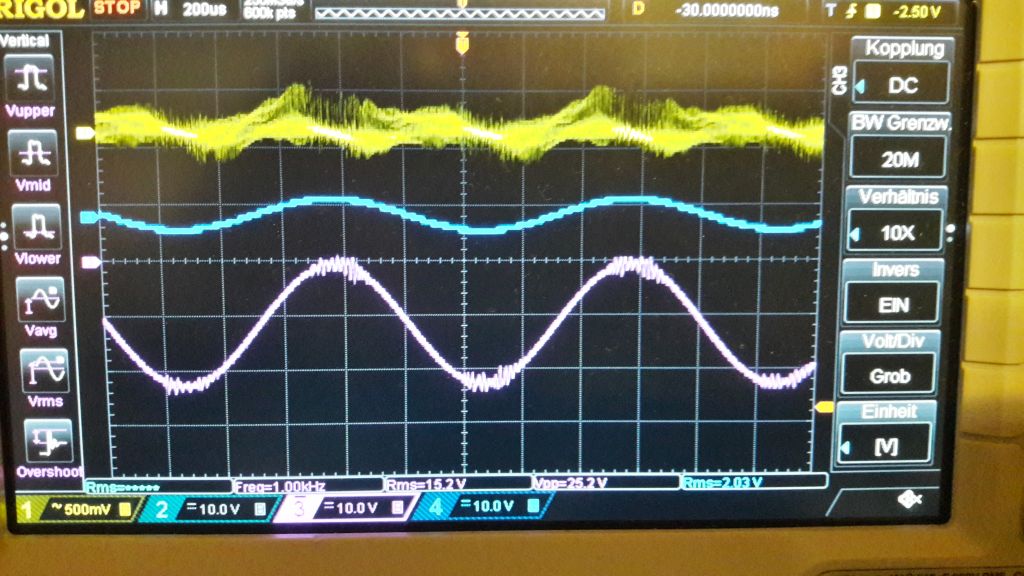

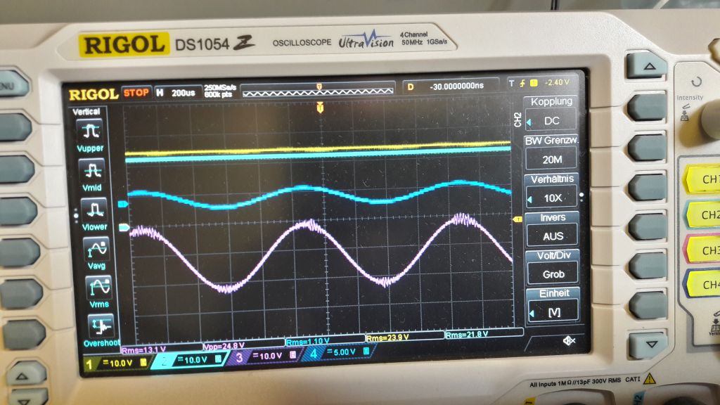

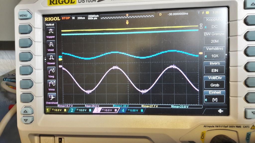

..clipping check... V5 White FX502Spro

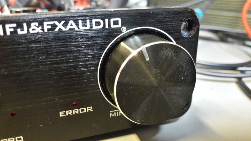

I want to know what is the sensitivity and the "right" position of the volume knob. When is the amplifier clipping....?
I tested the white V5 version of the FX502Spro with the original psu (24V ). this amp is not corrected at the LM 317 for 24V out.
i time i use the 28V rigol dp832.
8 ohms load each channel, 1khz 1Vrms in both RCA in. DMM at R channel to measure the amps
from top to buttom
yellow LM317 in
light blue LM317 out
blue is rca in
pink output at + speaker on the L-channel
pic 1 1 Vrms at RCA in - volume knob at 11 oclock
pic 2 2 Vrms at RCA -typical fixed output from a CD player..e.etc..
its clipping at volume knob 11 oclock
pic 3 2 Vrms at RCA -typical fixed output - no clipping at volume knob 10 oclock
pic 4 1 Vrms at RCA in - volume knob little more then 12 oclock - start clipping. its about 1,789 Amps and 13Vrms ---> about 23 Watts each channel
pic 5 is a try to look at the LM317 at 24V psu
pic 6 is with 28V psu. here is the power consumption about 100 Watt. output of speaker is 2,2,5Ampere with 16,7 Vrms ---> about 37 WATT....clipping so i changed slightly down to 12 o clock at the volume knob...so its no clipping...
my proposal is to keep the volume knob at about 11 o clock. thats the position where the litte "R" is of the front plate after the letter ....FXaudio...
no temp problems because no swee p ...just 1khz tone...🙂

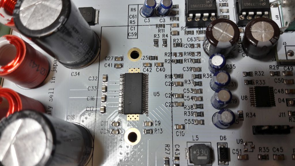

hi doctor
i checked at the V5 white pcb the cap at pin 8 = C_Start (pcb = C20) . i measure 520nF so it looks fine.🙂
but if you look at the pic (zoom in) i see nothing at pin 14 = AVDD??
Am i correct?
thx
chris
HI
I checked the post #376 on page 38 --- with some pics of the blue version (v3).
it looks like the 1µF is missing on pin 14 AVDD.
any body out there to confirm this???
should i add a cap?
should i add a cap?
pin 8 pin 15
pin 9 pin 14
3250mirror3251
AAAHH... thanks
TPA 3250
pin 8 ist C start
pin 9 is AVDD
TPA 3251
pin15 is C start
pin 14 is AVDD
i checked the pin 9:...on the pcb its called C24. I measured 1012nF.
so its fine
