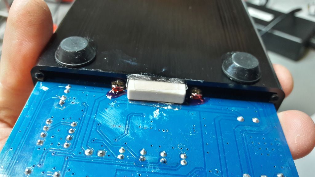

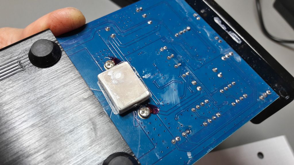

i try to make some pics of the ceramic resistor connection to the buttom case....
Heatsink gets heat from mainheatsink=pcb, you improved connection to pcb ?
I replaced plastic washers between the heatsink and the board with aluminum ones and added thermal grease. So I think connection was improved.
...how to make the ceramic colling implementation ...
hi
i got during my test just 34°C at to buttom plate, it feels more because i think my measurement tool gets trouble at black colored alu case without contrast to measure correctly. it feels more then human skin warm...so about 37°C...so it works good.
here are my pics :
turn the amp other way round and us thermal paste thin.
pic 1: 2 pcs of isolator (glimmer i guess) under the resistor and 2 pcs on top. its more then 5,1mm...but soory i didn measure it..
pic 2 : be gently to get the alu buttom case over the pcb....do not crack the pcb !!
pic 3: recheck if the ceramic resistor is still in the needed position....not easy to make pics to catch this...sorry..chris

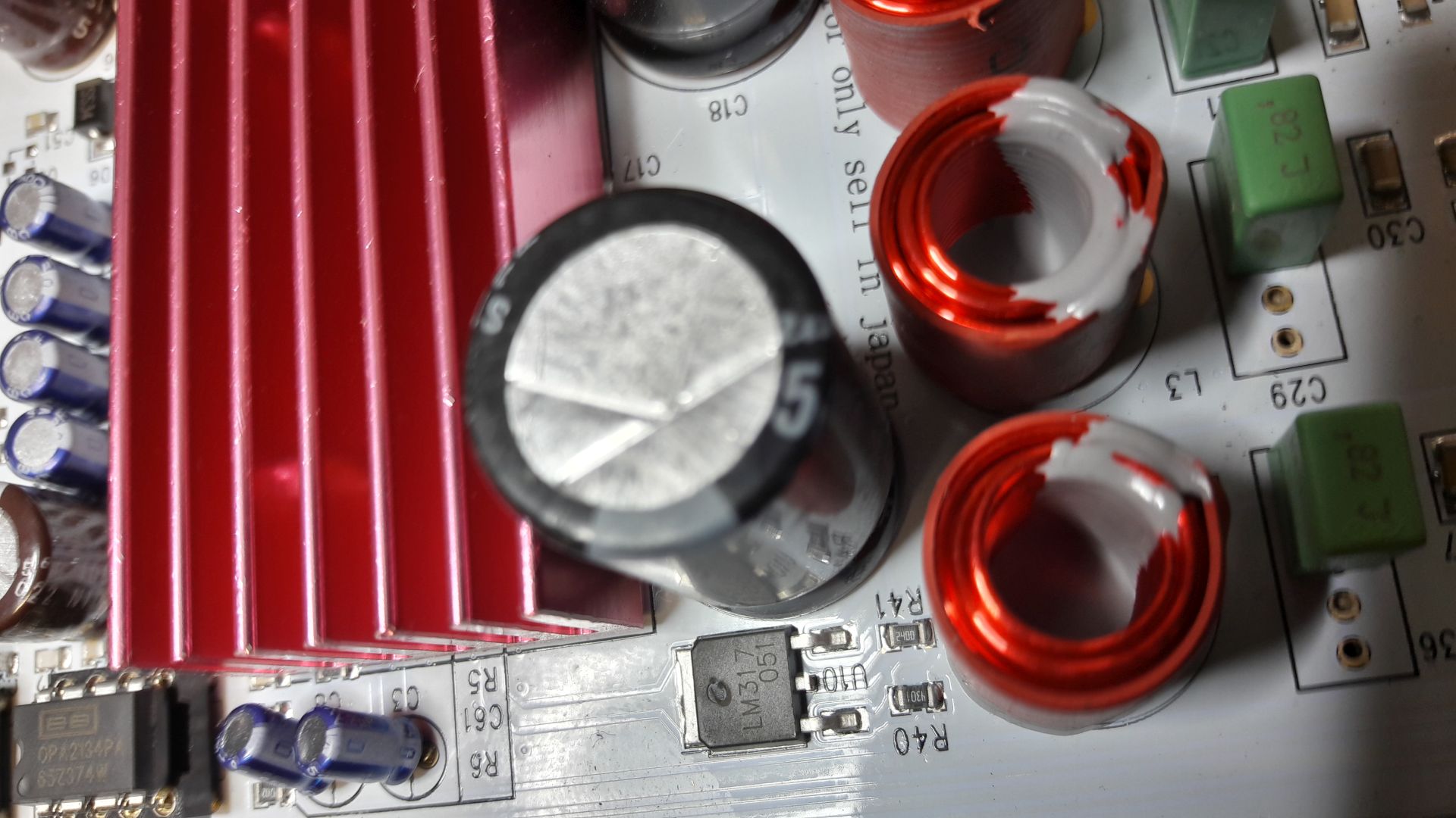

...LM317 Regulator
refered to the post at page21 #208...i was rechcking my amp
during 24V psu i measured the LM317. amp is v3 version -blue
actually the resistor values near the LM317 are SMD: R41=2400 and R40 = 4301
so according to the calculator here:
LM317 Voltage Calculator | REUK.co.uk
if the values are exact = 23,65V out
my measurements:
i measured pin 3 in = 23,87V, pin 4 out = 22,32V, pin 2 adj = 21,14V
my question is: is this regulator working correctly or not?
according to LM17 datasheet. chapter 7.4.1
7.4.1 Normal Operation
The device OUTPUT pin will source current necessary to make OUTPUT pin 1.25 V greater than ADJUST
terminal to provide output regulation.
my interperetation is yes because : Vadj + 1,25V < = Vout
thanks and good night...(22:41)
chris

You are on the limit of a problem: You have 1.55V between input and output. The TI datasheet says you should have 3V minimum. My guess is it may work until some 2V input-to-output, but you only have 1.55V. Your LM317 is starting saturating. Further, your 1.55V difference is measured as an average input voltage. With some voltage ripple, your input voltage is even lower just before re-charging by the transformer.
How can we verify that the LM317 is in saturation? - your difference between the output pin and the reference pin is 1.18V. TI states this voltage difference to be in-between 1.20V and 1.30V. You have only 1.18V because it has lost regulation.
Input voltage up, Chris!
But first, good night - sweet dreams.

good morning Fauxfrench
thanks for your help. i think yesterday i was too tired to check this.😛 i read a lot of datasheets but don´t realized this....shame on me...😉
with my DMM i measure : (tripple check) white (V5) and blue (v3) pcb are the same
R41=2400....236ohms and R40 = 4301.....3020ohms ??
if i use the calculator:
with this values R1= (R41)= 236 and R2=R40= 3020........i get : 17,25V
so what ????😕😕
