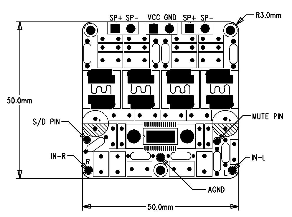

TH Parts and Smaller Board Design [ 50 x 50mm ]
This one small and tight enough?
2.53" x 2.20"
TH Parts + S/D PIN + MUTE and Smaller Board Design [ 50 x 50mm ]
Keeping in-used the Shielded Inductors.

I'm currently trying to squeeze it down to a standard 1/16th brick size (1.3"x0.9"/33x23mm), may have to settle for the larger 1/8th size (2.3"x0.9"/58x23mm) it's currently on as that allows for plenty of room for quality connectors.
33x23mm???... Is that possible!!!?... OMG!!!... really squeezed... I suppose your are using ferrite bead chip as a filter, right!?... the IC it selfs its 12x6mm!!!... Cant wait to see your magic!!!
Yeah, ferrite beads naturally. But also due to using hybrid caps you can achieve much higher ripple current with much smaller caps than the standard 220µF caps. I go with 68µF as that still gives twice the max ripple current and half the ESR of the 220µF standard caps. Size is 6.6x8.2mm compared to 10.3x12.8mm seating plane so size is roughly half as well.
Oh, and with the squeezed size I dropped the TPA3118 in favor of the TPA3132 instead.
This means half the power of the TPA3116d2, at least with a 4 ohms load, right?
No PBTL option neither...
No, same power output. It's the same chip really. The data sheet is just more realistic and suggests 19V as operating supply voltage which you'll want with the TPA3116 as well, so no difference there. Yes, there's PBTL option built in, it's internally the same chip. Only real difference is that the alternative output switching option is removed from it. The TPA3132 however is automotive qualified which means it should be able to handle much hasher environments and abuse.
33mm x 23mm ??? Wow, that is **small**! We are all looking forward to seeing this design. It's going to be like fishing - drop the hook and line with bait, and wait for the bite by YJ and enjoy the rewards. 😀
At this size, you can get the boards made at qnty 10 for ~$10 via Itead Studio. I assume the connections are just thru holes for soldering wires directly? Any connector or terminal screw block will seriously kill your real estate on that tiny board.
No through holes of any kind. It's supposed to glue directly on a metal chassis with double adhesive thermal tape or fit directly on a standard brick heat sink with pressure sensitive thermal glue so there can be no through hole parts. It's not even allowed to have any traces whatsoever, only ground plane, on the bottom side. Terminals have to be SMT.
So how do you connect adio input and speaker leads? Flat little metal strips soldered SMT syle?
