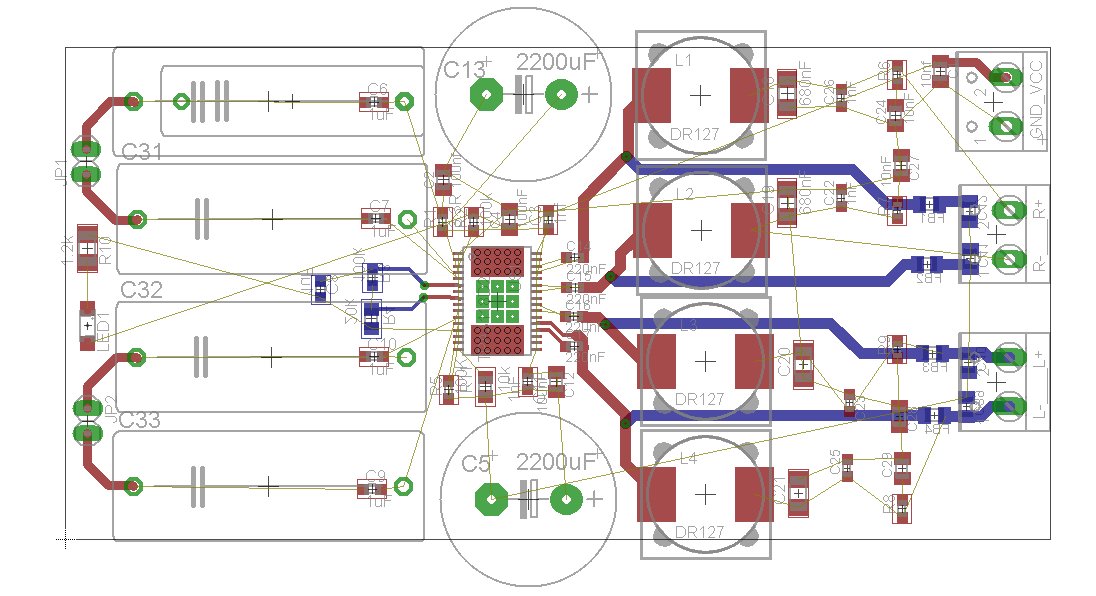

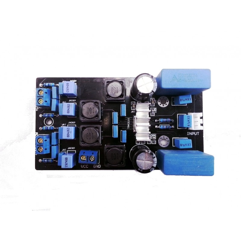

Dug - Do you have a BOM for this design that is proven and working, or is this still in prototype stage? I'd order a few boards too if offered, along with a BOM.This one small and tight enough?
2.53" x 2.20"

Well, I suspected when the different boards are optimized, they will look quite similar. The circuit for this amp is not that complicated (as compare to some other amps) and when squeeze down onto a small PCB, there are only that many ways to package all the component.
I guess one can safely assume that all the boards are designed based on the one that TI originally published.
Well, thats what I thought too, but when I compared the position of the DC input, the use of polistrene bootstrap caps (when ceramic are recommended), and other things, what can I say, as a newbie in electronics, and overall a newbie as well in PCB layout design, I feel a little proud with the idea that someone could copy or went the same way of the design as I did!!!, that means that despite the errors I made it was not bad design at all!!. And something that could be very nice for us, that would mean that YJ is following our thread, and its designing things based in our ideas, and the best of all, designing for us!!!.
But the design Im working now its a bit diferent, starting from the input, I have separated the inputs , same kind of caps for all the input, gain resistors are at the bottom side, the bootstrap caps went back to the ones used in the EVM board, on the top side one can choose the option of use the recommend LC filter, and in the bottom one can choose to use ferrite bead chip as An EMI filter.
All the inductor are in a 1x4 line...
If I have sometime tonight I Will try to post a pic of it...
The more I look to the New YJ board, the more its looks to the design I posted in post #941...
If they have copy my design, they should had read Saturnus what suggested......

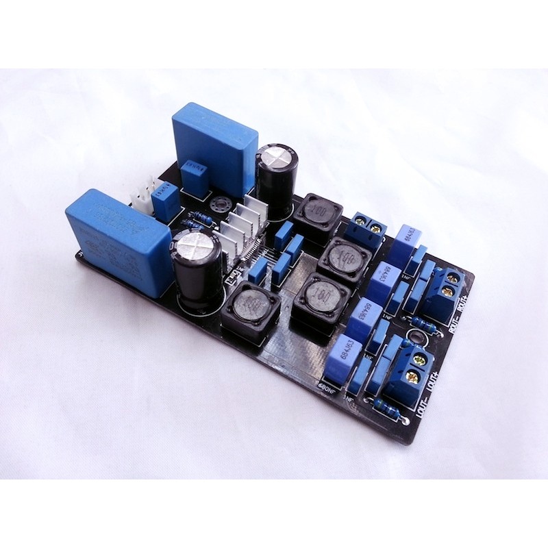

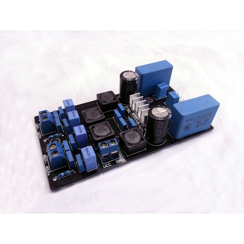

OMG, they did swipe your design . I just looked at it and it looks identical. We now know YJ has been silently reading these forums - no surprise there.
http://www.yuan-jing.com/tpa3116-class-d-2-0-stereo-amplifier-board-50w-50w
On the good side - there is no need to go through the trouble of ordering pcb's and filling out BOM's, and soldering with a magnifier and tweezers. I am quite sure the BOM alone would cost you much more than $20.

So here its another idea to yuan-jing...
At least this time I hope they send me a few boards!!!...hehehe!!!
By the way... all the gurus!!!... its totally free to coments all little things that you could see in my board!!!!... Its still a draft but, many things to add and to finish... but all comments are welcome!!!
