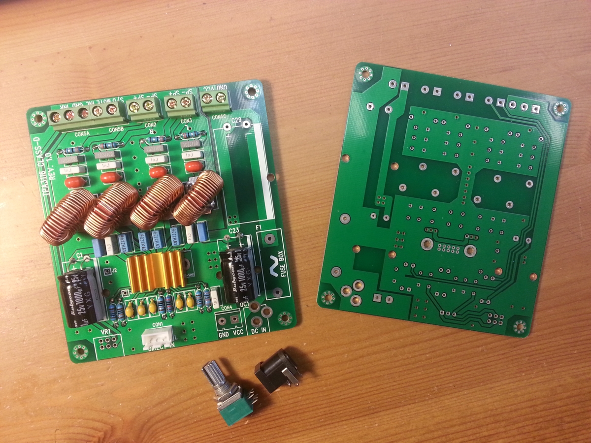

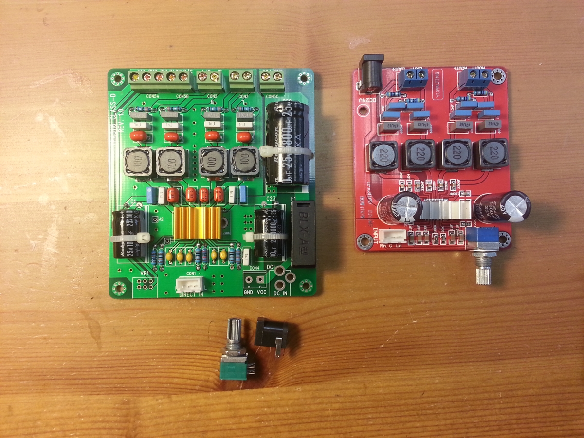

Real Size Comparison
Real Size Comparison more details
Something close to what you can see by the picture.
With the yj boards I still have hiss even with 87dB speakers.

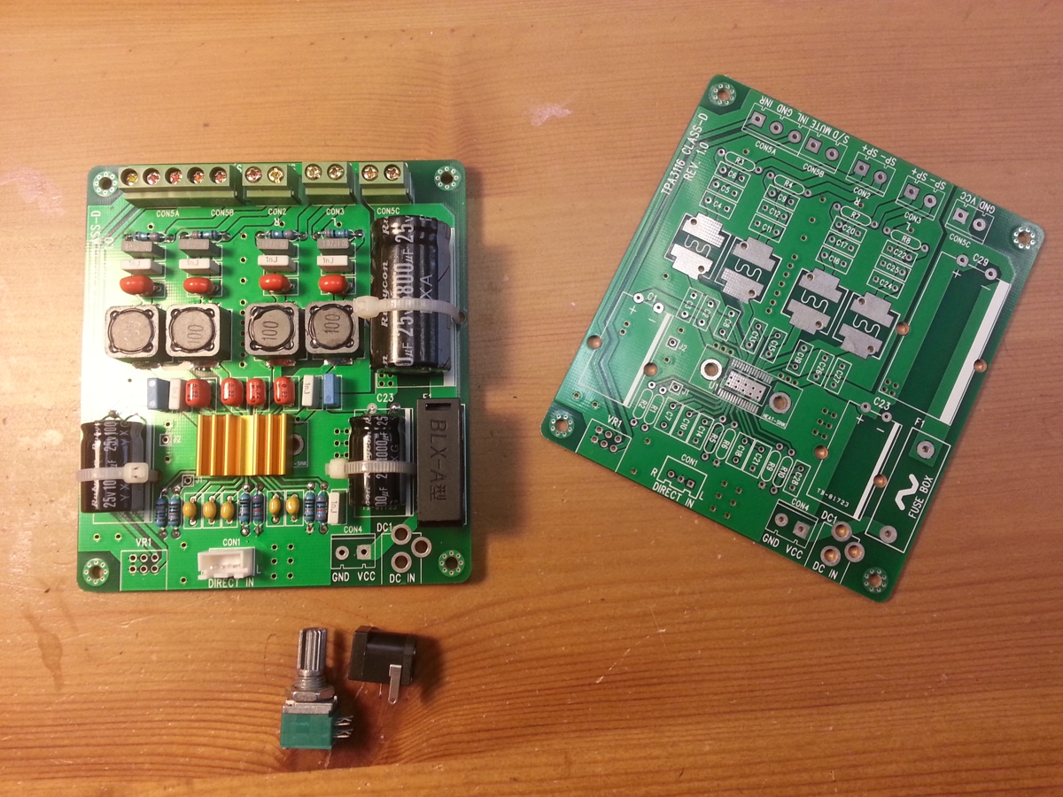

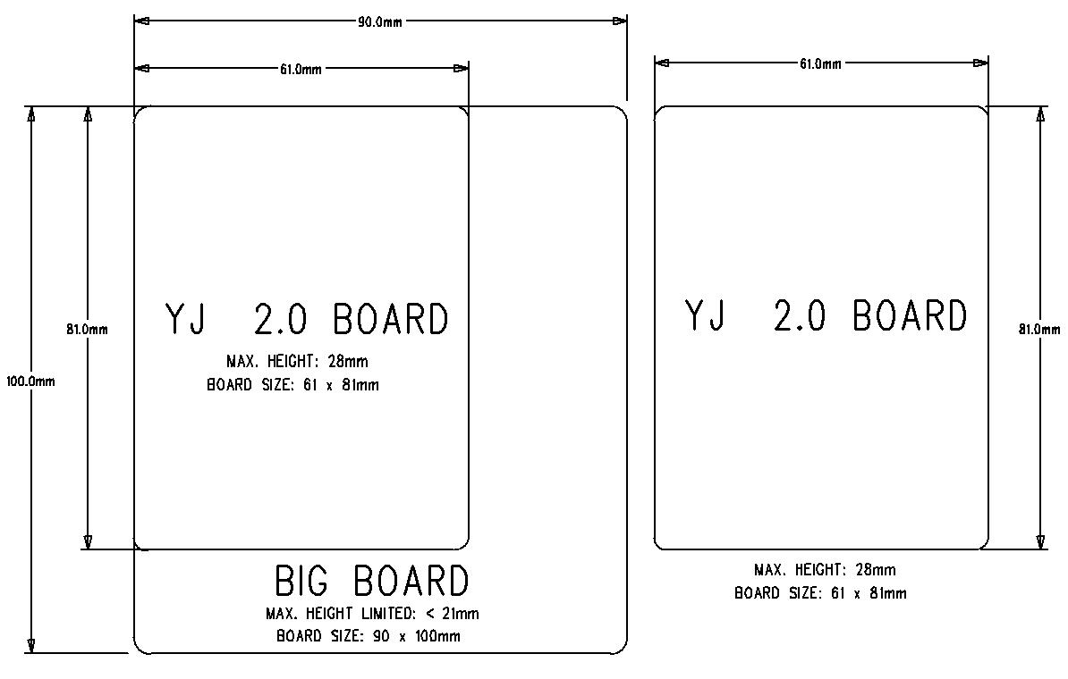

Top and Bottom PCB Layout Design
This board is special design for my friend only, as he need it over 100pcs for field application. The height is limited by <21mm, therefore, No better solution for the PSU cap placement. We are tested a lot of digital amps solutions from 50W ~150W power range. Finally, The TPA3116 solution is best. As simple, lower power requirements and High Efficiency, Totally out of our imagine and within the budget. We are also compared all the existing TPA3116 boards in market (Boards all from China). Therefore, Do as our flavor .

I like through hole for the output filters if you can keep legs short on a good designed pcb, then it may be a good compromise.
With this board there are way too many problems summing up
+ Freaking long tracks
+ Electrolytic caps put on vertical with ridiculous long legs
+ Filling empty space with copper is not always a good idea.
+ Distance between critical components is much bigger than the recommended by TI.
+ Through hole components on a poor designed PCB.
Some one with the right skills can design a TPA3116 based amp with through hole components while avoiding most of the problems. This is definitely not the case with this board.
This board is the best bag for the buck IF you are starting on the diy world and/or would like to try, experiment and make changes at will with through hole components.
Good cheap "eval board" with long tracks, plenty of space.
Sure, the more experienced guys will have something to add about this board and I am curious to hear from em.
Sharing the layout design as this is first sample.

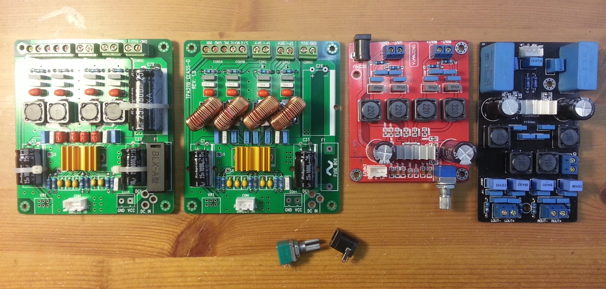

Well, in my photoshop "simulation "I missed by half a centimeter or something close to that
Alright, so the green board that I am trying to sank into oblivion is 10x9cm versus 61x81cm of the yuan jing board vs 6.5x5.6cm of the DUG board. All being 2.0 channels 2x50W

Man, make a board with dimensions bellow 6.5x6.5cm, smt components but X7R 250V caps for the bootstrap and a nice mute terminal . No need for volume pot or tank caps... just like the DUG design...
Alright, so the green board that I am trying to sank into oblivion is 10x9cm versus 61x81cm of the yuan jing board vs 6.5x5.6cm of the DUG board. All being 2.0 channels 2x50W![]()
________________

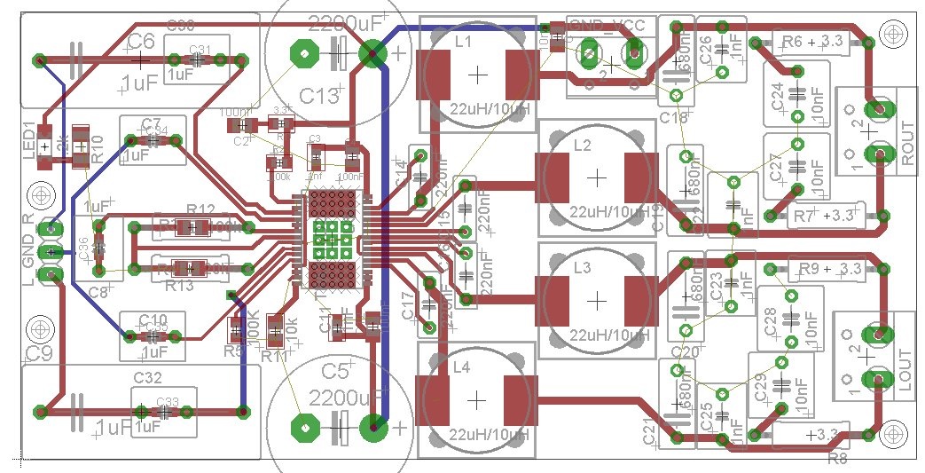

This one small and tight enough?
2.53" x 2.20"
Very nice Dug! I am still waiting for my Chinese board to arrive but I believe your design is the ideal layout and with ideal components. It will be interesting to compare.

The more I look to the New YJ board, the more its looks to the design I posted in post #941...
If they have copy my design, they should had read Saturnus what suggested......
Well, I suspected when the different boards are optimized, they will look quite similar. The circuit for this amp is not that complicated (as compare to some other amps) and when squeeze down onto a small PCB, there are only that many ways to package all the component.
I guess one can safely assume that all the boards are designed based on the one that TI originally published.
