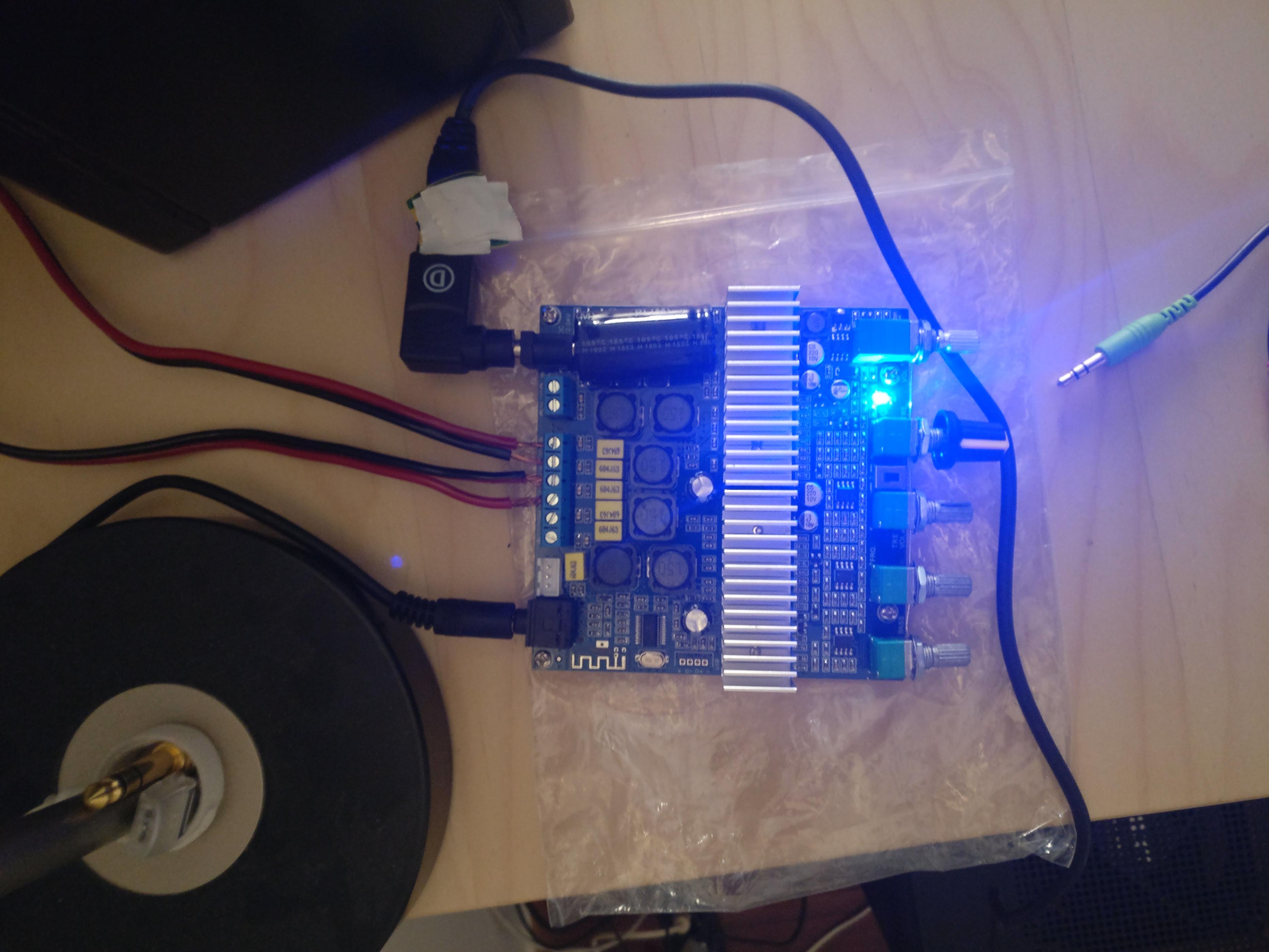

Could we please have a photo of the amplifier? Then, we can probably see if it uses an SMPS and if we shall try to solve the problem on the power side or the signal side.

I did the quick test. The buzz disappears immediately when I disconnect the power. One this I noticed is that power blue led on the amp board attenuates its intensity, this attenuation is accommodated by a difference in the buzzing frequency. I don't know if I am explaining this well.
Here is the picture, I think you can see everything, as well as the blue light.(ignore the electric tape on the power plug it masks the an annoying led)
A TPA3116 2.1 amplifier I guess. Used with an SMPS I assume?

Kyrk, you have a typical ground loop via PC PSU -> amp unbalanced connection -> amp PSU -> protection earth wire of your house. Lots of noise created in the PC ground lines is added to your amp input signal. You will have to break the loop - e.g. by using ungrounded PSU for the amp.

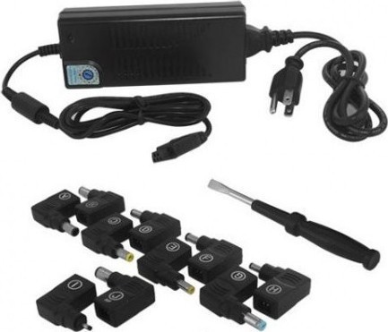

An smps? A switching power supply? I am not very sure, I guess it is?
At the end of your post you ask me if I have a DC psu with an ordinary transformer and 12-24v 1A min. I am pretty sure that what I use currently is this. It has an adjustable DC output 12-24v with 4A output at 24v.
This is its description:
Built in overload and short circuit protection, Automatic thermal, over current, over voltage cut off.
High output efficiency and stabilize, low ripple and interference.
Low standby energy consumption meeting with Energy Star.
Efficiency beyond 90%. (Condition AC115V full loading)
Power LED indicator.
Specifications:
Output power: 100W (Max)
Input Voltage Range: AC100-240V, 50/60Hz
Output Voltage: DC 12V/15V/16V16.5V//18V/18.5V/19V/19.5V/20V 5A DC 22V/24V 4A
And a photo(with the European plug not the UK one)

A power supply that meets energy star definitely is of switchmode type
