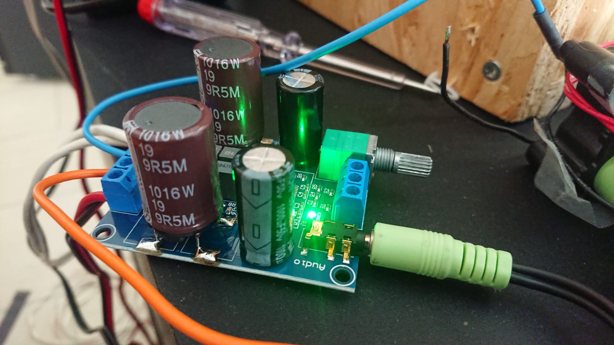

TPA3116 hiss
It's done, no more hiss. I don't know why someone thought this op amp was needed, even now those input pots cannot be turned over 50% with regular level input.
Interesting to see only 1-2A at 18V draw when music is really loud. Only thing is, now it turns off like it's not getting enough juice, but this power supply has driven hungrier amps without a problem. New 24V power supply is in the mail anyway so I'll see later
Hi, I have the same board and did exactly the same thing but still the hiss.. it didn't make any difference at all. Any ideas?
Thanks for any help.
XH-M560 RED BOARD // some Hiss problem and infos
Hello,
I found this Red board with 2 TPA3116D2 (as shown on the attached pictures)
It works very fine althought it's not the cheaper one you can find on aliexpress,
it is miss labelled as "TDA3116" but i verified and it is a tpa3116 from TI.

Now i have presented the board (i know you like it on that thread 😛), i can tell you I have few problems :
- LITTLE hiss problem everytime (i heard i can fix that doing the "gain mod" removing a 100k resistor (R2) and changing the R1 from XX to XX
(Can i just remove R2 to do the gain mod ? One youtube video says we can't do that)
- BIG hiss problem when i drive the amp with THIS power supply and TOUCHING/APPROACHING the potentiometers/pot buttons.
My power supply is connected to ground so i don't understand what happens.
Best regards guys, and thanks for the help.
Papaya
Try a piece of wire from ground to the pot´s metal axle. Noise touching it should be gone.
If you mount the amp in a case, it should be grounded to it. Or use a plastic knob, maybe?
His and noise have to be jugded with the input of the amp grounded. Anything else has to be adressed later.
The 24V 9A SMPS is dead quiet. Yo have done something wrong if it produces noise.
Maybe have a look at well build amps in the gallerie, then compare yours. Or post detailed pictures of your build.
Most probably this will give no noise. Sometimes the source and the amp will have ground problems, depending on the power supplies. Then you have to find a ground connection that is silent.
These amp´s run on very high frequency´s, they can give problems in the AM radio. It is better to use them screened, inside some metal box.

Thanks for the reply !
Ok, I tried it and it is even worse with a cable connecting the ground to one potentiometer
What i don't understand is it doesn't produce that noise with the regular laptop power supply...
Here you can find pictures from my setup (it is mounted on a plate, inside side of my subwoofer like it was before it didn't work)
Just the power supply "plate":
whole setup :
whole setup + ground cable from pot to ground :
You grounded the SMPS. A very bad idea. Without this (yellow) wire it should be silent. Does not help with safety, too, as it is a plastic case. As far as I can see (I don`t see much!) the yellow wire in your build should not be connected.
The gray wire is just as bad. Ground means signal ground. Just a wire from the amp boards ground (negative -) to the pot´s. Not from the SMPS, in this case it is like an antenna for all electromagnetic dirt.
The black cable with brown and blue wires from the SMPS to the amp may work, usually one would use two wires twisted together.
I do not fully understand what you plan as a final build.
Such a forum has the problem that we do not know what level of practice /knowledge the other one in a communication has. So good advice will sometimes get bad results.
115 or 230 Volt AC are very dangerous and things like the 3rd wire of the power grit are handelt very differently in some country´s. In mine you are basically forbidden to work at it without a special degree of education.
