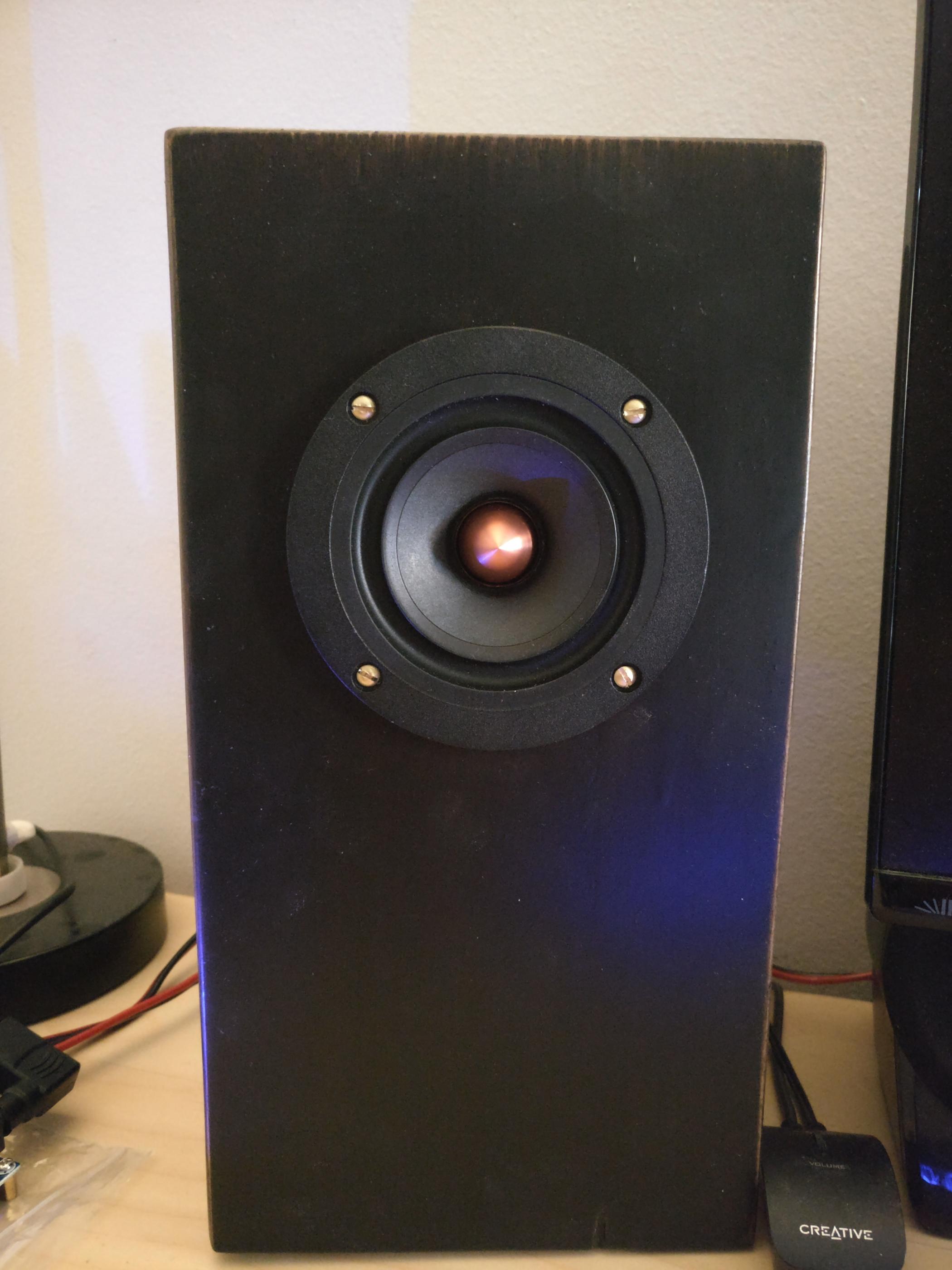

I just build my speakers they are a pair of Dayton Audio PS95 along with a GRS 8sw4 sub that I am. Currently building
GRS 8SW-4 8" Poly Cone Subwoofer 4 Ohm
Dayton Audio PS95-8 3-1/2" Point Source Full Range Driver 8 Ohm
I guess they are not exactly what you would call "hifi audio", so the Bluetooth option won't really hurt the quality. But I still found it a little junky.
