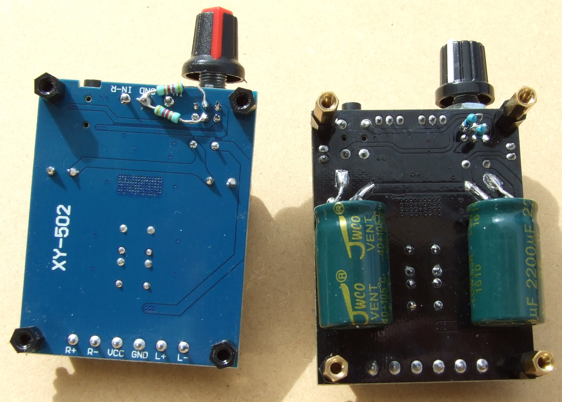

so that is now mono!. Had a 4.7k R intending on trying to eliminate the hiss at the volume pot but not really knowing what i was doing and prodding about .....blew the thing. But none of the combinations on the volume pot before the blow seemed to quiten it down anyway. So another waste of time and money there!

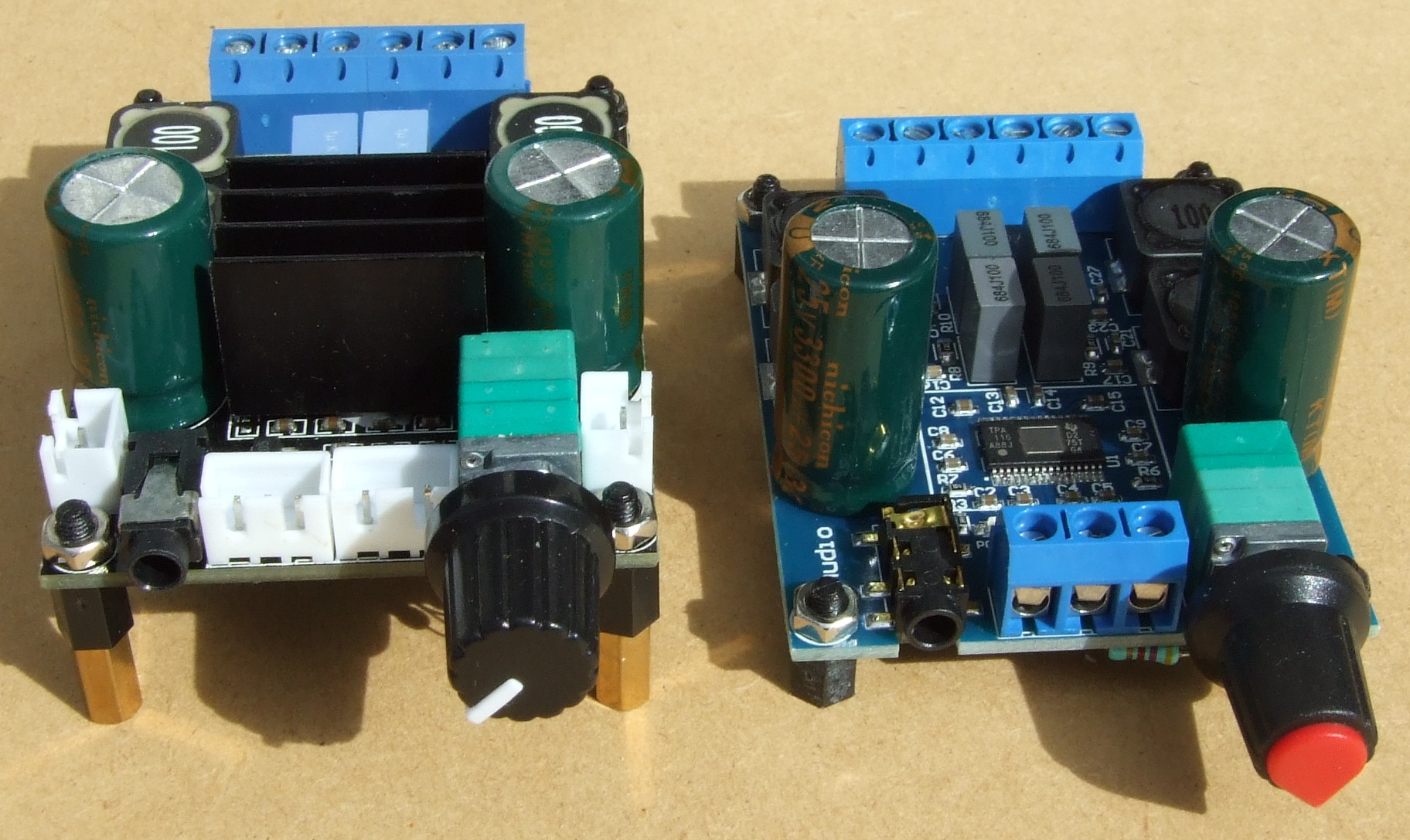

.suppose it's a 2.1. Noise floor on the bass channel is horrendous and unusable. Noise on stereo is worse than the first board. Sounds nice once volume is up and you juggle various source/amp levels but I concede on trying to quiten these things down.

Interesting that all the boards that hiss have open-core chokes, whereas the quiet one has closed-core chokes (even though dirt cheap CDRH127s).
My TPA with closed cores DC 12V 24V TPA3116 Dual Channel Stereo 50W*2 BTL Mono 100W Audio Amplifier Board 9934840364132 | eBay (the red sanwu board) is dead quiet. I do not know if the open/closed cores is the cause, just finding correlations.
Notice also the short traces from input terminals to the chip (unlike all the boards with built-in potentiometer). IMO all this counts.

I am sorry to hear you lost a channel. It cannot be the 4K7 on the output of the volume potentiometer that destroys the chip. You must have made another connection accidentally without being aware.
Today, I took my two TPA3116 boards with 4K7 resistors just to make sure the hiss is gone. I hear no hiss (anymore) even with my ears just in front of the speakers.
For my third type of TPA3116 board, I simply lowered the gain which also works.
