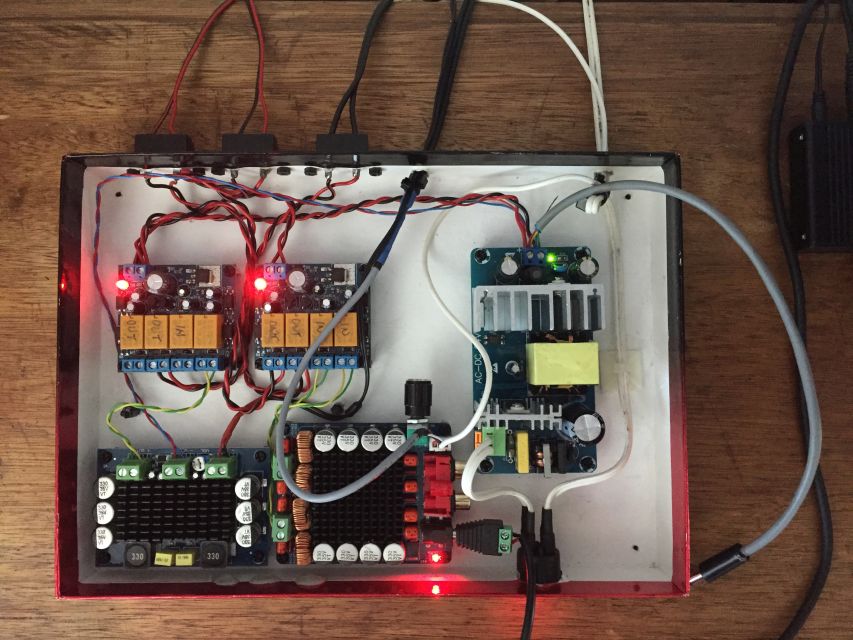

I'm testing a dual amp setup, fed by a dirt cheap external USB sound 'card' that allows me to use EQ APO as a crossover.
I'm using one stereo 3116 module and a separate 3116 mono module, both powered off the same PSU. I've managed to invoke a mosquito-like buzz, which I gather is a direct result of both modules sharing the PSU. Apart from the obvious solution of using two PSUs, is there another way of eliminating this buzz?
I do not think each module requires a separate PSU. Please try to draw a diagram of your setup, including the source and all the power sources with all power lines (PE wires etc.).
I can draw a diagram but it will take me a while. I'm certain it is a consequence of using the same PSU: all I do is remove the (shared) power input to the stereo amplifier and use a separate PSU, and the buzz is gone.

IMO again you are hitting a ground loop effect - a loop between the two amps and a single PSU - the input 0V terminals are connected, the 0V supply terminals are connected - creating a nice loop.
Again, 2 cents I would try using the balanced inputs on both amps, connecting the balanced-line shield to GND on the amp sides. That should turn the ground loop noise into common-mode noise which the differential inputs should eliminate. It will cost nothing to try.

Thank you. I have some shielded cable here so I'll make up leads for both amps and try it a little later today, Should I ground the shield at the PSU end as well, if so, where exactly on the PSU? I posted a link to the type of PSU a few posts back.

Any idea where to find a ground point on this PSU? - both amps are grounded so I'm wondering whether it will help to ground the PSU.
Now I've looked at your picture...
1. Remove the Ground/Earth white cable from the entire setup. If you want to use it - connect it to the "-" output of the PSU!
2. Rearrange the amplifier boards, so the power connectors to be as close to the PSU as possible. Use thick and short cables from the PSU to the amplifier boards!
I can rearrange things so that power leads from the PSU to amps are as short as possible. The ground/earth white cable that you see in the photo is connected on the other end to mains earth, so is it safe to connect this to PSU "-" output?
