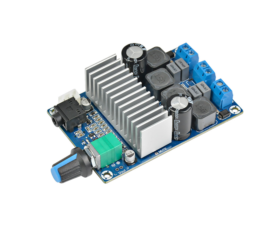

Try to place two 10K resistors, one on each output channel, to ground. It may be the Bluetooth module goes in low power state (with high impedance outputs) when no file is played.
Thanks Faux French. I'm first trying to understand this - I get that the BT module may be going into low power state, but why is this only audibly evident through the amp and not through the earpods? Is it because the amp cannot deal with high impedance input but the earpods can?
My point is that if the Bluetooth module goes into low power state and leaves the outputs high-impedance, the amplifier inputs are more-or-less open. The level of buzz you then hear depends on how the amplifier inputs are "tied". Perhaps the earpods amplifier input has already got 10K-47K to ground.
The 10K (or 4K7) I propose serve to tie the inputs to ground if they are left floating.
You are already aware of the "hiss"-issue for TPA3116 amplifiers?
Just to be clear, there is no earpod amplifier involved - the comparison is purely as follows:
Laptop BT to BT receiver module, earpods plugged in directly to module, no buzz/hum when audio is not playing.
Laptop BT to BT receiver module, cable connected to inputs on TPA3116 amplifier, plenty buzz/hum when audio is not playing.

1. Yes, that was what I actually meant. The Bluetooth output is for me where it connects to the amplifier input.
2. Try with a single 4K7 on each channel. The 10K was just a guess on how much the Bluetooth module can pull without too much lowering of the signal amplitude. Most likely the output is some kind of OP-AMP output and such can easily be loaded with 4K7.
Now I understand that the Bluetooth module has an earpod output of its own. It is very likely that the module cuts off the line output if earpods are connected.
The most frequent reason for buzz is a sensitive (high impedance) input.

The Bluetooth module has only one output - stereo mini jack.
So I've just tried single 4K7 on the amplifier inputs, it takes the buzz down quite a bit, maybe by 20%. I'll put 2 in series and check what happens.
Edit: Don't know whether this helps, but when the amplifier inputs are completely open, the buzz is significantly lower than when the Bluetooth module is connected.

More resistors will not improve the situation. If 4K7 can't remove the buzz, something else is needed.
You have a TPA3116 amplifier powered by a power supply. When you connect the Bluetooth module you get considerable buzz. Which power supply do you use for the Bluetooth module? The same as for the amplifier?
The difference between the earpods and the amplifier as loads for the Bluetooth module is probably that the earpods are pretty low impedance and the buzz signal is too high impedance to drive the earpods. An amplifier input is sensitive even to high impedance signals. What is the impedance of your earpods? Can the Bluetooth module drive the earpods with music?

I'm using Apple Earpods, official specs are difficult to find but it seems they have an input impedance of 42-45 ohms. The Bluetooth module does a good job of driving the earpods with music, and no buzz at all.
The amplifier I use is this one:
TPA3116 2.1 channel digital power amplifier board
I've looked about quite a bit but cannot find specs for the input impedance.

I got another Bluetooth receiver to test with my TPA3116 amp. It produces a loud buzz through the speakers when connected but with no audio file (source is MP3 on laptop) is playing. As soon as I hit Play.the buzz disappears.
If I use the same receiver with my earpods there is absolutely no noise when no file is playing, even if I wind the output volume up to max.
Is this an input impedance problem and can it be easily solved or is it something else that I'm not aware of, such as a ground issue with the amp?
It could be the BT receiver turns off the output to save power, which may be the reason why no buzz when playing music.

I'm sure this is the problem, but the buzz is only evident when connected to the amplifier and not when connected to the earpods. Maybe the impedance of the earpods is such that the receiver does not go into power saving mode?
Have you tried grounding the unit to earth? Or add addition ground to the receiver and amp.
The amp is not earthed. Can I take a ground lead from the amplifier input signal ground?
Try with the casing first, then signal ground. If you hear weird sound then immediately off the power.
This is a TPA3116 module, in a box, so no casing earth available.
The good news is that you are spot on with it being a ground issue - I tried a quick fix and took a lead from signal ground to earth: the buzz/hum is reduced very significantly, to the extent that the amp is very usable now. The hum only becomes apparent if I take the amp volume up over 50%, which almost never happens. I will put a proper earth lead in shortly.
