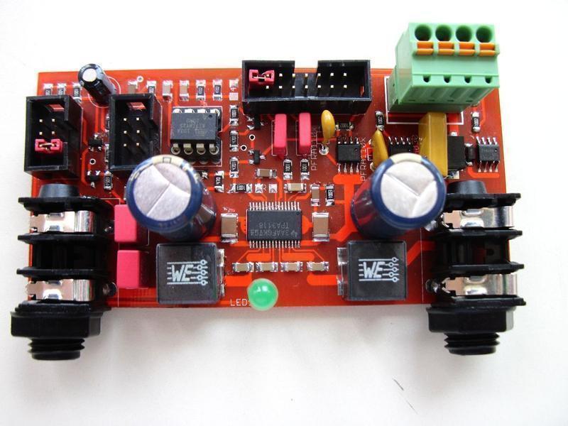

I am using my home-brewed TPA3118 boards in my guitar stage amps for several years. They are powered with 24V notebook bricks. To make it louder on a bigger gig I fired two 8Ohm speakers resulting in 4Ohm load. Before that I did a lab test with 40Watt into 4Ohms dummy resistor for one hour - which is far more heating than real music. No thermal overload occured.
All in all I encountered no single prob over the years. These little TI-chips are real workhorses😉
Impressive! Thanks for sharing, voltwide. Do you have a heatsink in your board design?
I take it you used 20V for your 40W test into 4ohms, I reckon one can exceed those 40W when playing overdriven guitar, so unless you play clean I'm guessing you're getting more than 60W on your TPA3118 guitar amps @ 24V / 4ohms 😱
As I used TPA3118 - there was no heatsink.
Only the pcb did the cooling.
40W of output is just a rough approximation.
The supply was indeed 24V=, but as I am using some soft clipper to limit output level below class-d-clipping the max output level is reduced by about 10 %.

Yes, the result is similar to these diode clippers. Instead of diodes I use a pnp-differential (long tail pair) amp that is fed by some current source. I will look for some fotograph meanwhile
This is a pic of a recent version.
You see a bunch of additional circuitry around it:
-lead acid battery charger
-deep discharge protection
-a "deadman switch" shutting down after 15min music signal pausing
Very cool mate. The board I ordered is smaller than yours so it might not dissipate heat as efficiently as yours, we'll see

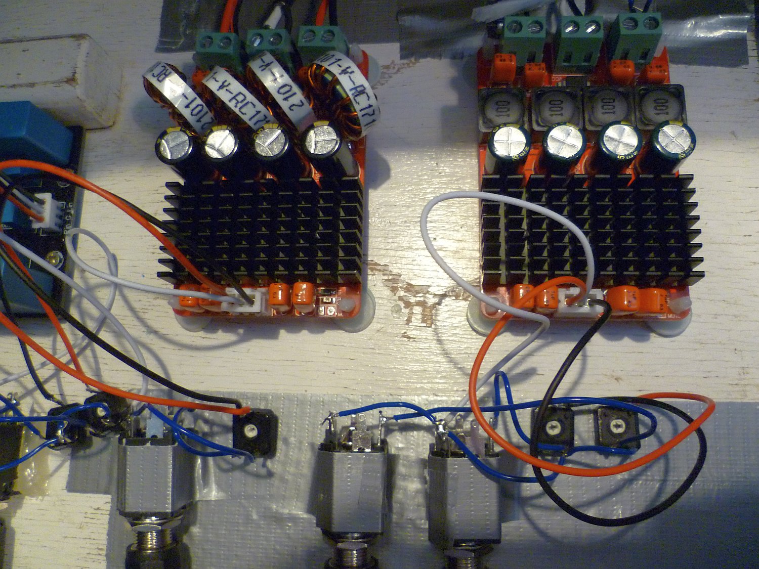

Some Bourns 2101-V-RC 10uH 10.8A inductors arrived today so I swapped the ones on a Sanwu red board. It's quite a tight fit but the solder pads are big so it's not too hard to solder them in. Getting the 'feet' bent just right is the trickiest part. I thought these bigger inductors would reduce the heat but they're heating up much like the little black ones! Oh well, I'm glad I didn't buy 12 of them at 2 pounds each from RS.
I realised that for the PBTL mono board, the two 10uH inductors are joined with the solder links to make 20uH ones. If I was swapping those, two 22uH ones would be cheaper and easier to fit in. I'm not sure I'll bother though. Maybe larger inductors would get the heat down. These ones I bought are 22mm diameter, the next ones up are 32mm.
Jamming these inductors onto these boards has made me think the capacitors will end up getting cooked over time. I might fit two caps either side of the board instead.
Edit: I'm running these on 19V. A YJ blue/black board I'm running on 15V runs a lot cooler, as do these Sanwus on 15V.
